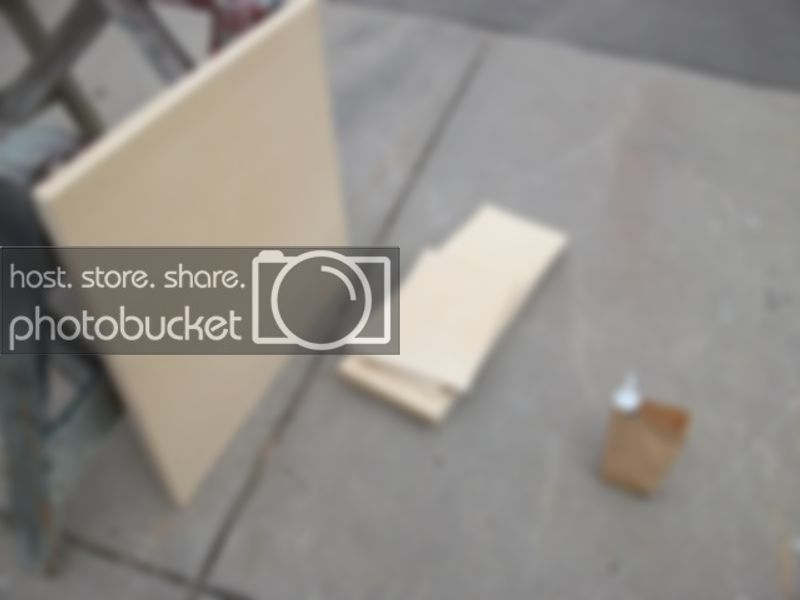

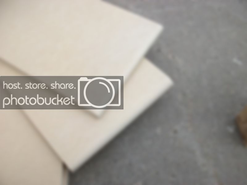

All the wood cut out
Didnt have a router so i rounded the port peices with a sander

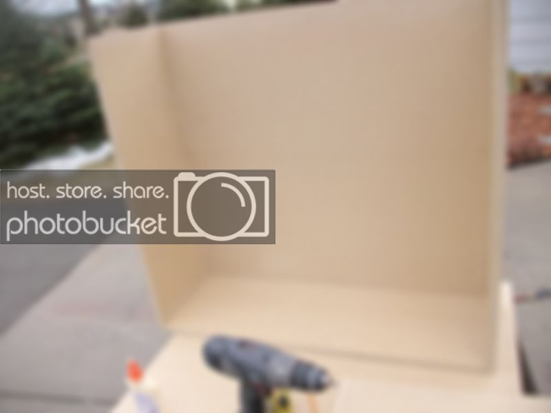

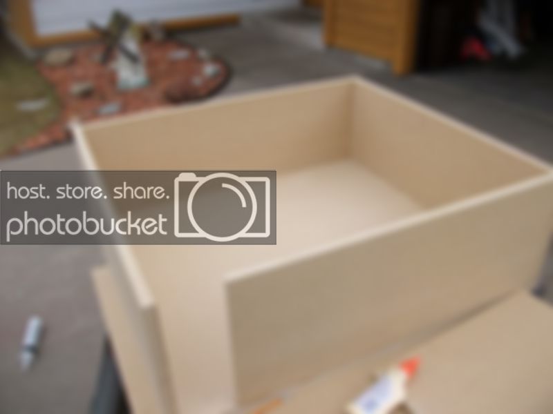

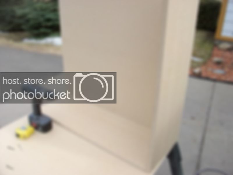

1st piece connected to bottom
2nd
3rd

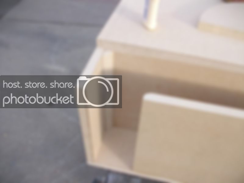

4th

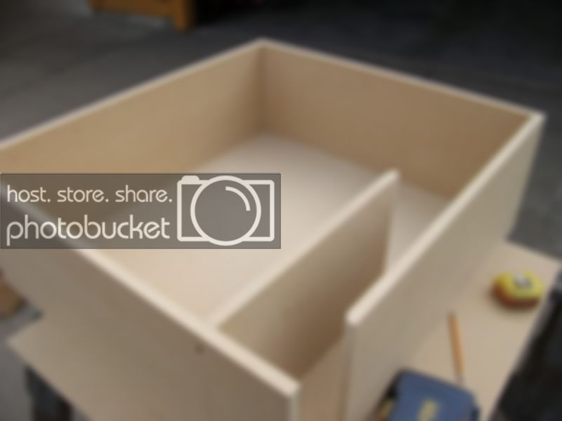

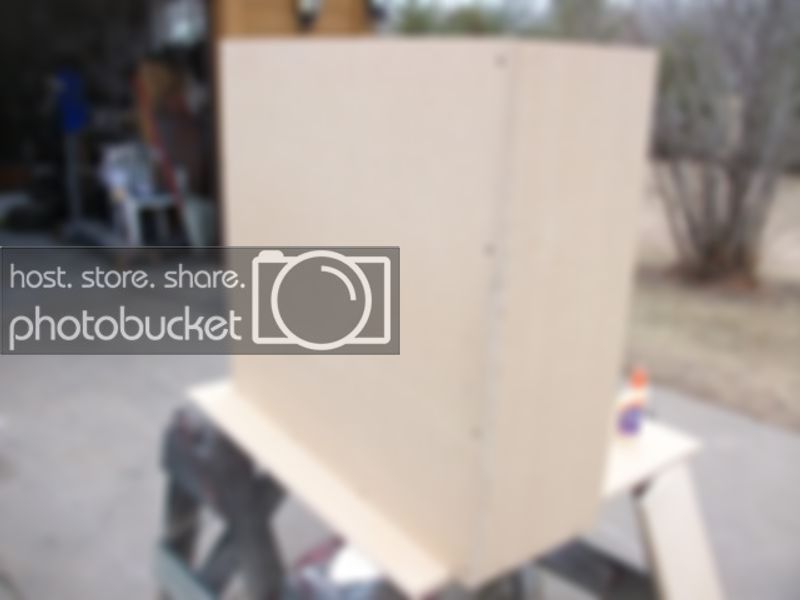

port wall put up

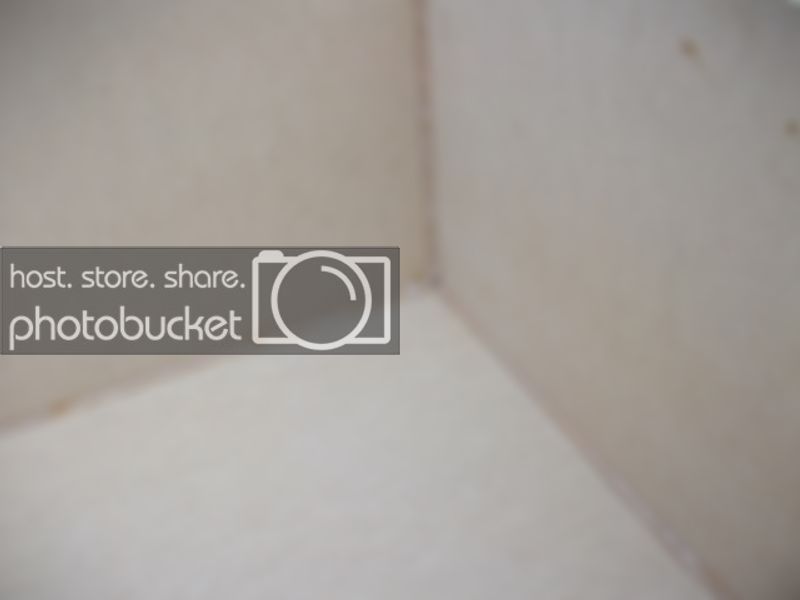

siliconed the inside before the top was put in for easier access

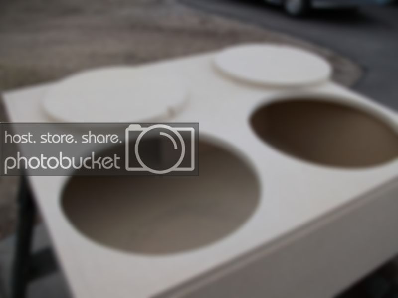

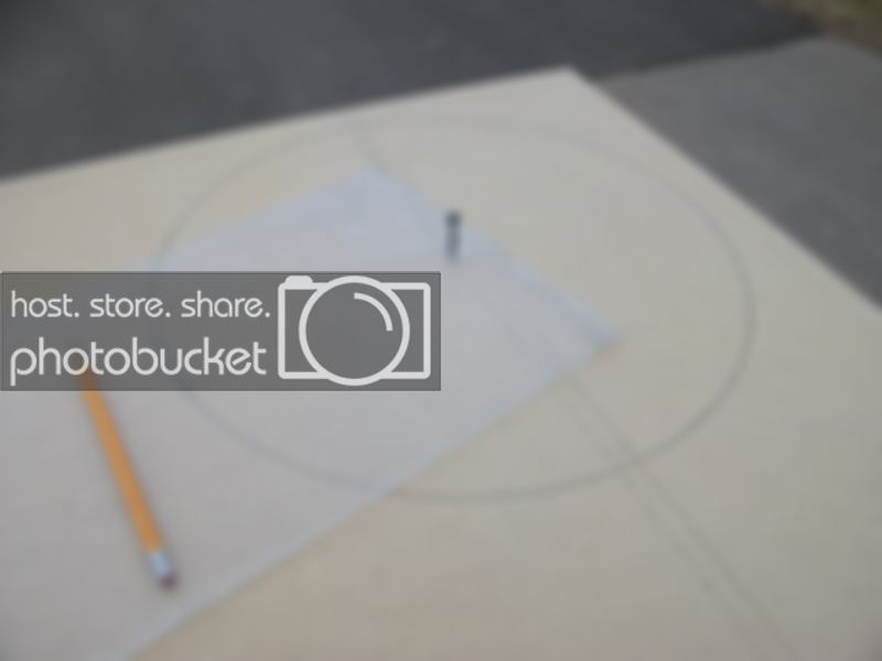

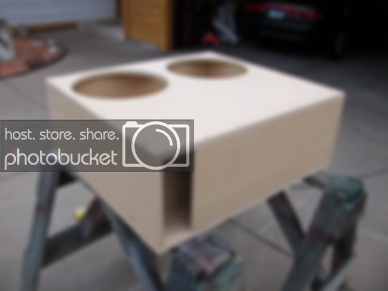

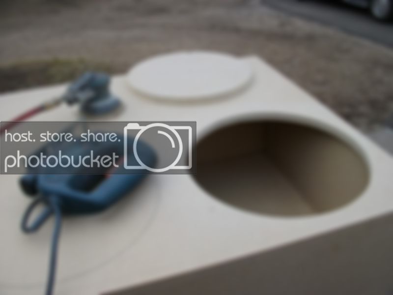

Cut out for the SE's was 14", so i got a scrap piece of plexi and did a 7" radius and drilled 2 holes one for the screw the other for the pencil

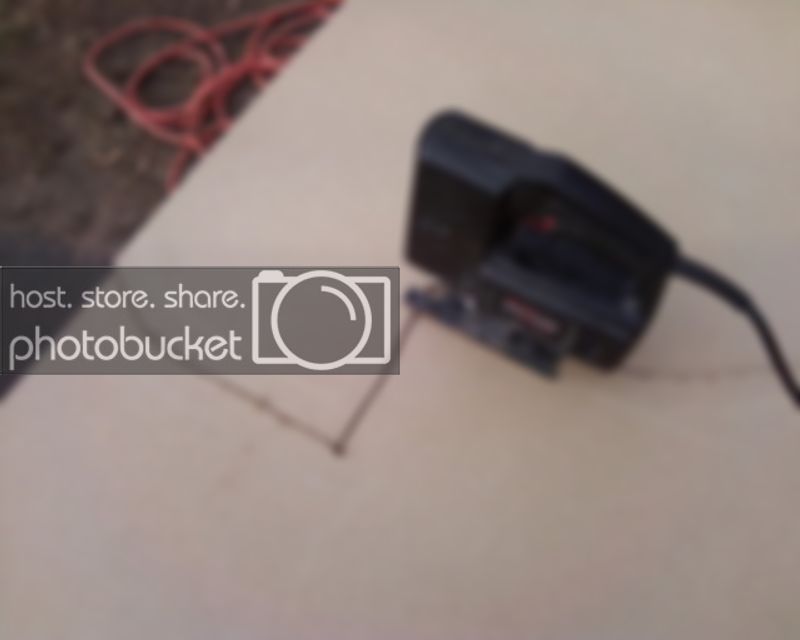

drilling a hole for the starting point i carfully cut out a circle with a jigsaw that was almost perfect
same for the 2nd hole
with the extra wood from the circle cutout i made a port corner

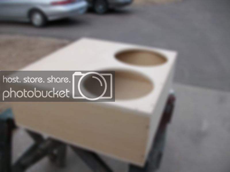

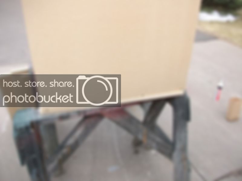

and finished the assembly of the box with mounting the top on

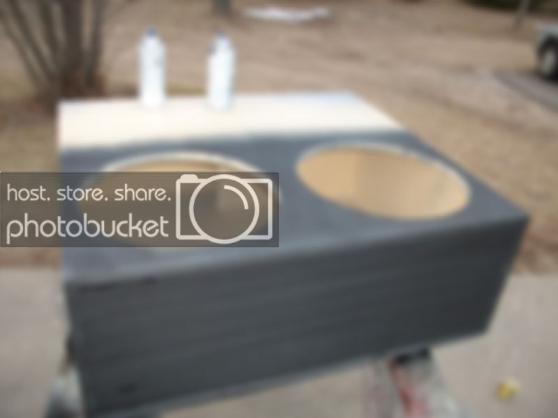

on to painting the parts of the box that may be seen

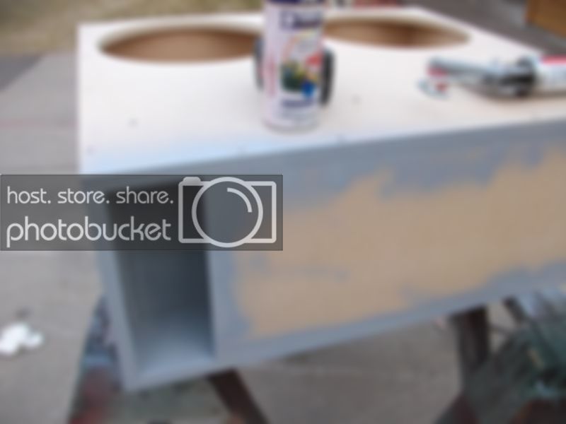

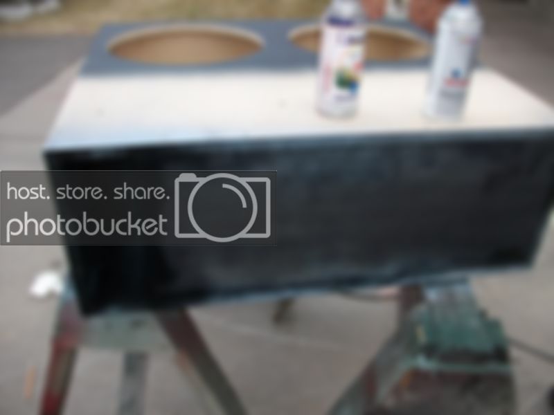

started out with useing grey primer
ran out of that quick so i moved onto black primer
This is it for now, hopfully i will get more done tomarrow. The rain threw off finishing it when i wanted too. Alot more to come! //content.invisioncic.com/y282845/emoticons/smile.gif.1ebc41e1811405b213edfc4622c41e27.gif

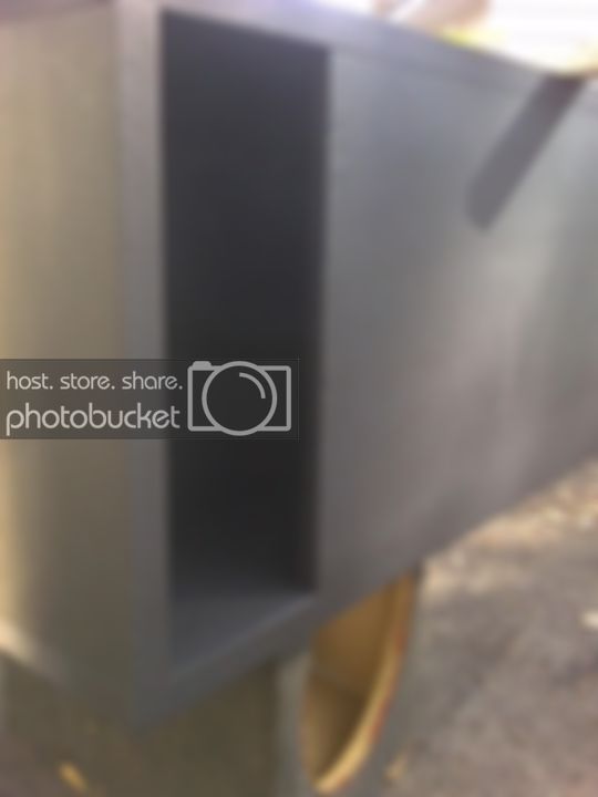

Not diggin' the port at all. You should've designed it to where the port is just straight out, instead of having to hit a bend right at the end.
i dont know what a port corner does. I thought people used angles to try to keep the width of the port the same all the way through. With just a small sliver of wood there, does it even do anything?? And i agree with james, not a very good design.
edit: and not sure what woofers or what kind of power you are running, but maybe a little more bracing would be beneficial.....??
we'll see, i dont think ill have any problems with it, i didnt have where the subs were going to be so i planed it that the port woulnt hit the sub at all

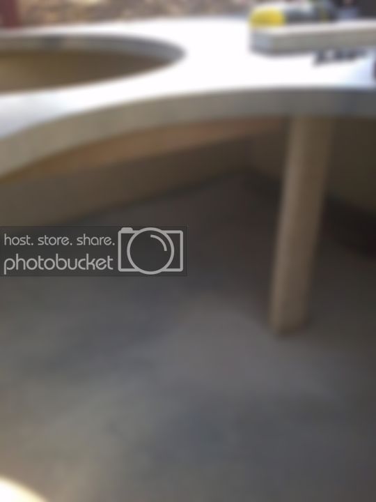

i was thinking about bracing, but i didnt want to do that untill one of you said something....so i rethought that
i added a peice of wood from top to bottom and ran another peice of 3/4 mdf to go between the subs
and i used black undercoading to paint the parts that may sometimes be seen

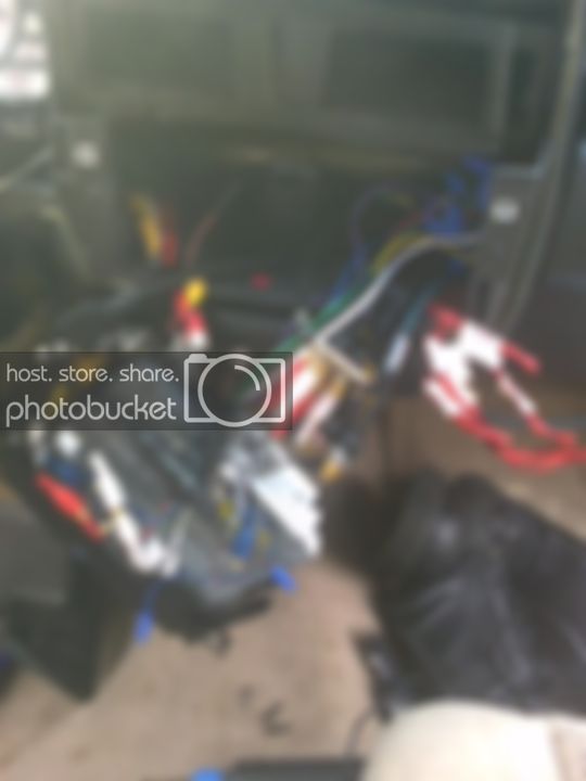

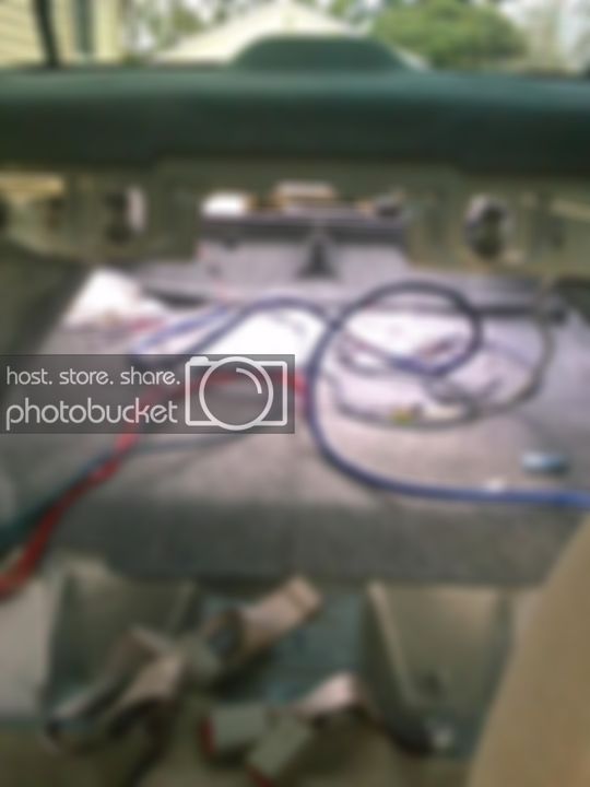

and i did a bit of wireing today
the wire mess behind the deck.... itll be more organized later

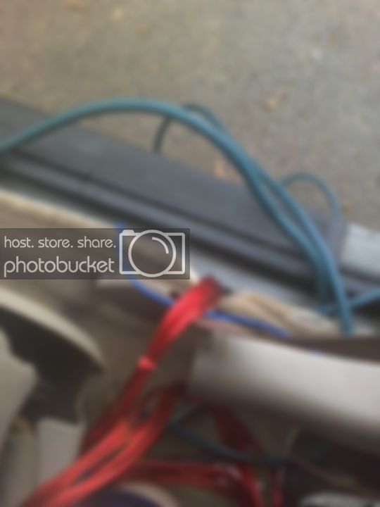

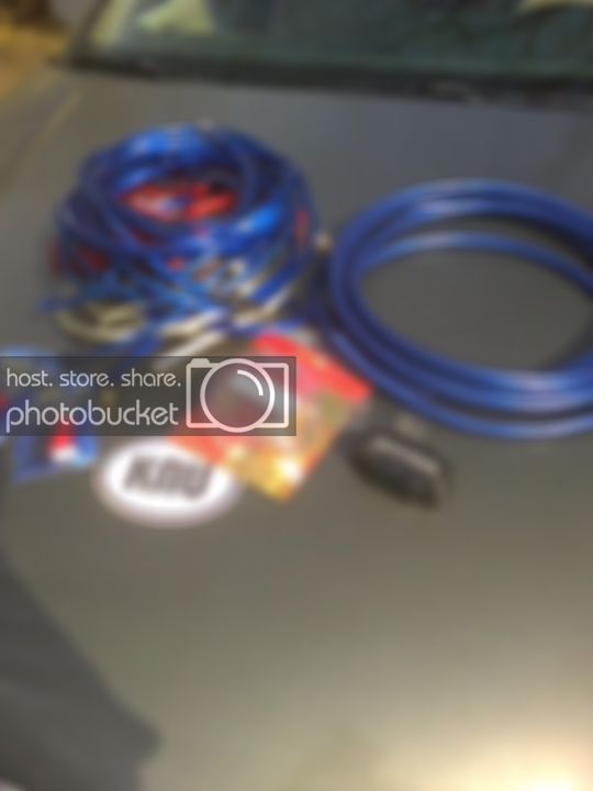

heres running some monster RCA's 4 & 2 channel and speaker wire
took out the backseat, to run even more wires under it...i want a clean look when im done

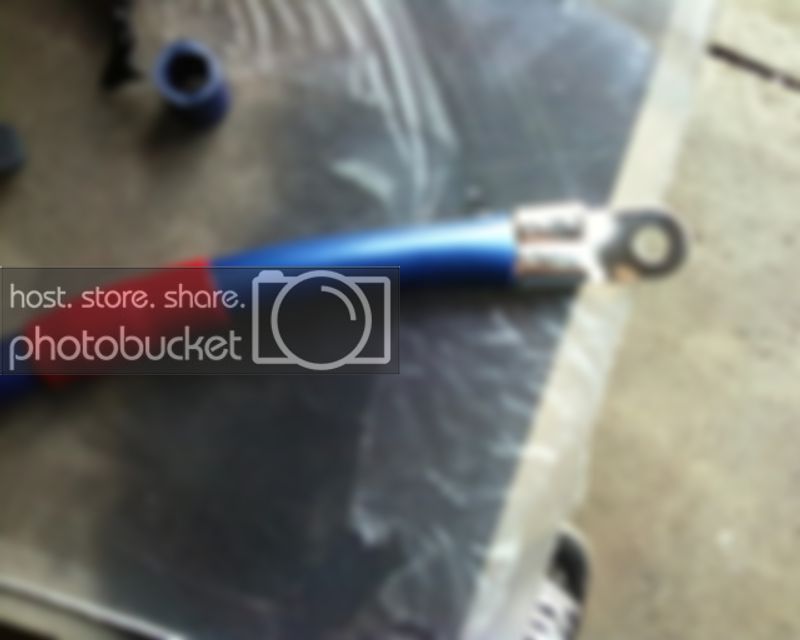

crimped some ends

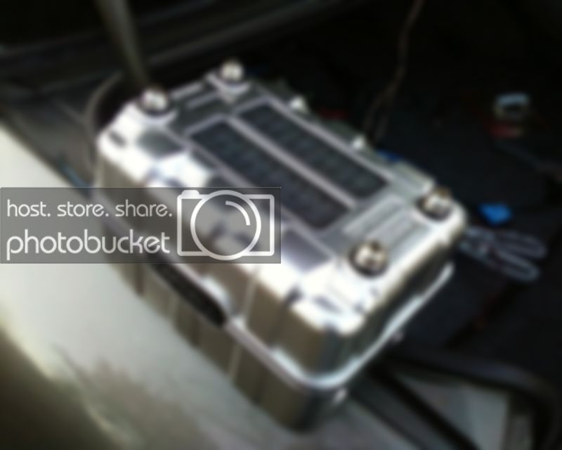

got this dirt cheap, but idk how well it will work???? its a Capcell 600-Amp, it holds a charge
opened it up and its kindof a 6 cell battery

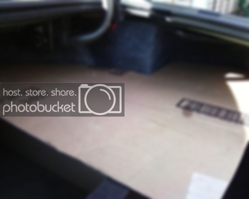

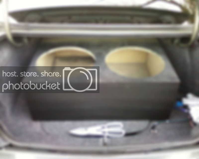

And the box in the trunk, and started a few measurements from there, but you guys will see...

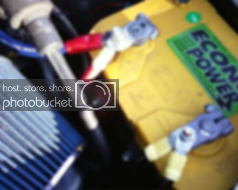

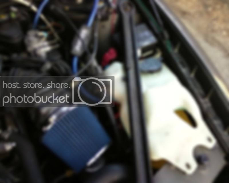

Did the big 3 and hooked up the power wire to the batt
the battery is a sneaky bugger with it hiding spot

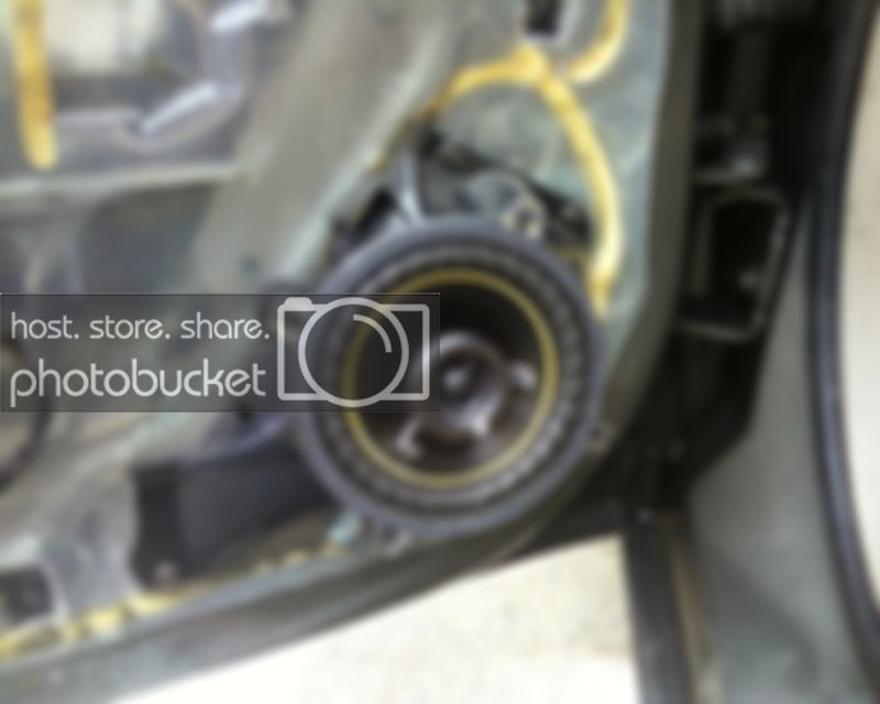

kicker DS 5.25" installed in the door, think i might make some pods for them later

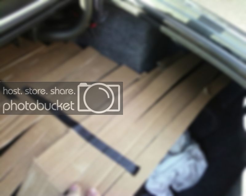

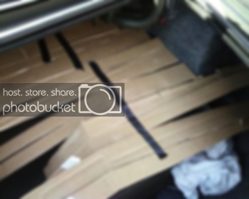

cut a bunch of cardboard strips to find the curve of the trunk
then made a cardboard cutout of the curves on more cardboard for test fitting
once that i got a good fit i traced onto the 1/4 MDF i picked up home depo
and cut with a jig

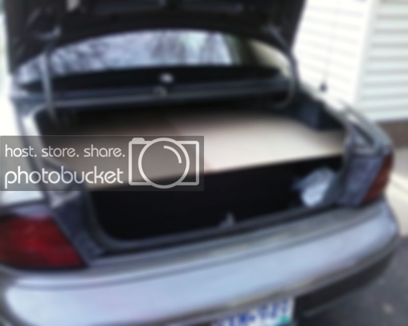

need to make to pieces to have it fit in the trunk
heres the test fit in the trunk
a few more cuts, carpet, installing of subs, and amps and ill be done
