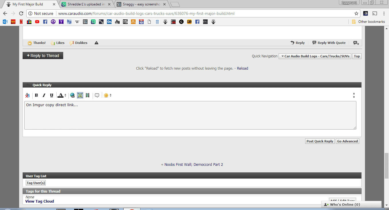

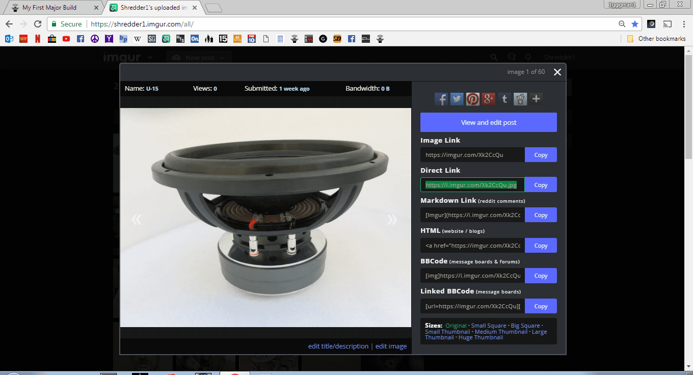

On Imgur copy direct link...

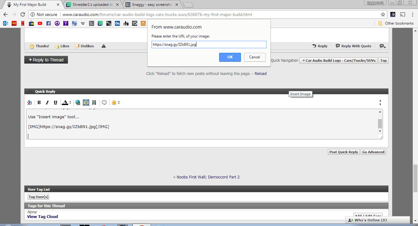

Use "Insert image" tool... the hilighted box below
Insert link in box that opens...
Click on "Ok" to insert link
Then post reply... I think I got it correct.
