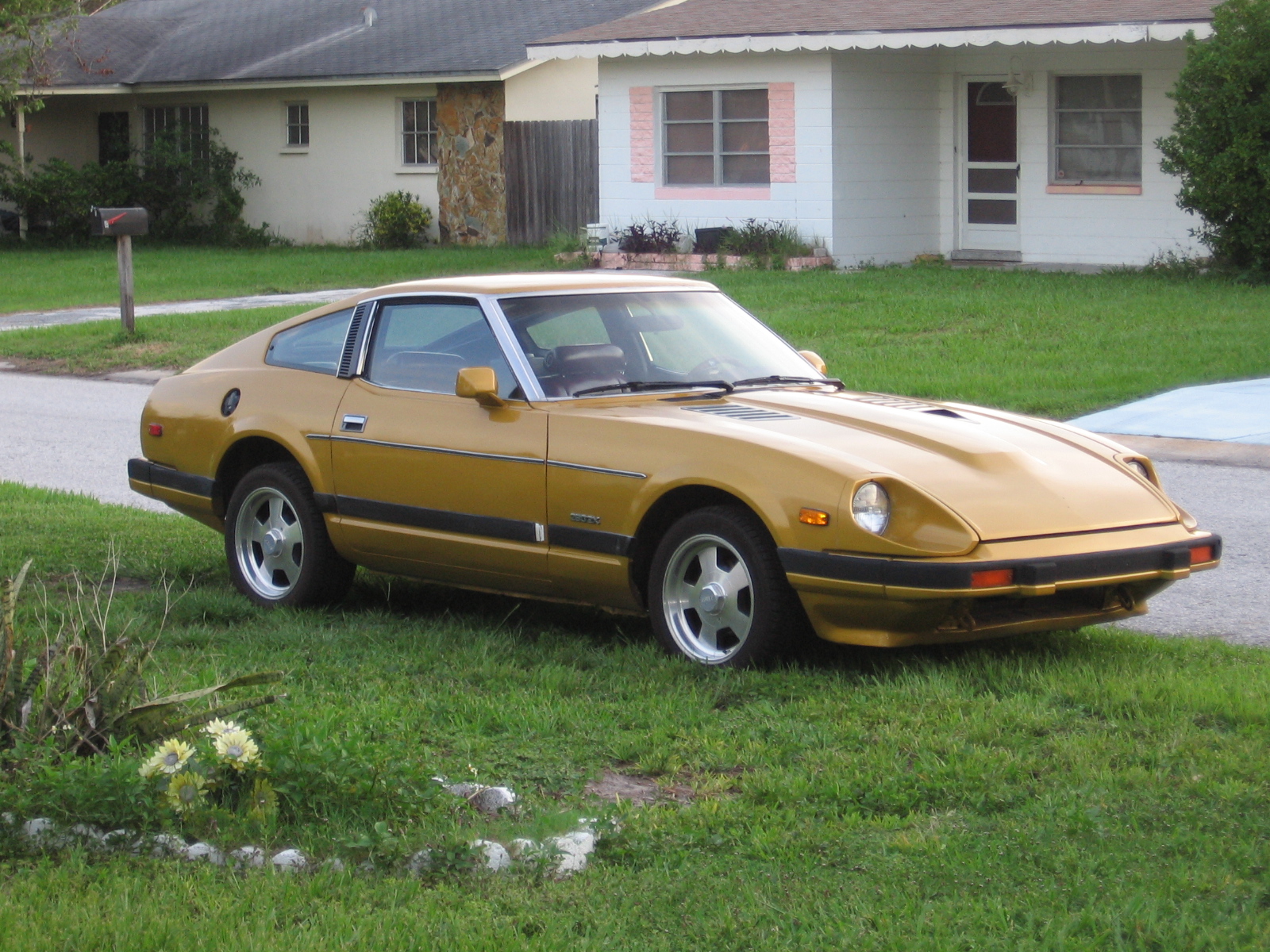

I wish I still had my 1982 280zx. All three were some of the best cars I have ever owned.
Sorry bro I'm just not into Jap crap. I've owned two imports in my life an 87 Prelude and an 87 MR2. I donated the Prelude to the police and gave the MR2 to my brother.
Not even in the same league as the 280zx. What is even better is they readily accept small block Chevy V8's in the engine bay and still retain the 50/50 weight distribution. Slap a 450hp 383 or an LS in a 2,800lb car and you are gonna have fun.
Who said it was try hard? I speak truth. You are a fagazi *** *****
as someone who works on and tears cars apart on a daily basis, today's american cars are just about the worst aside from fiats. Paying a premium for american labor, not a quality product
Yeah, I am retarded.

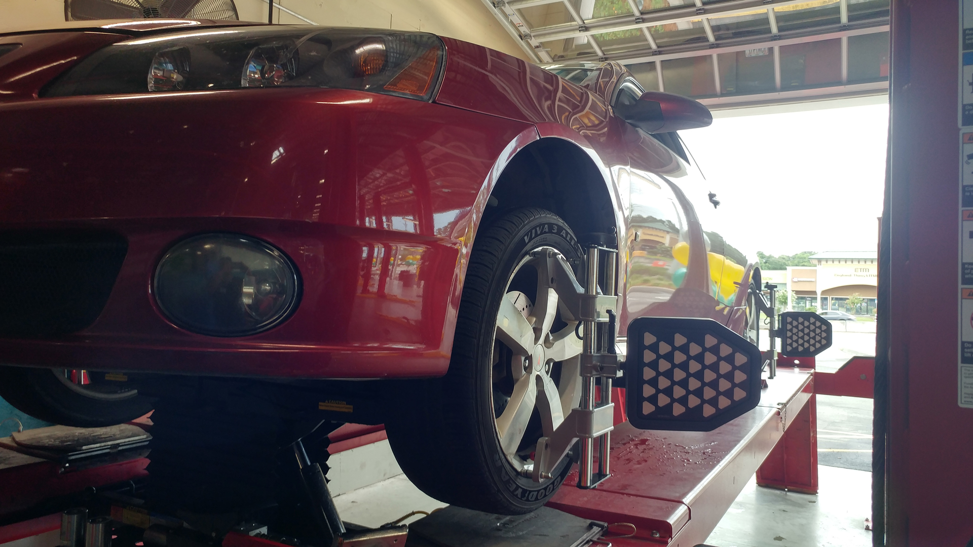

I was hoping to buy a mic sometime here in the next day or two until my car decided to demand some money from me. Apparently my car separated the tread on one of my tires after my near collision with a doordash driver. So, $171 later I have a new tire and an alignment. I also found out I need a new outer tie rod end on the drivers side. They said they would put one in for free if I applied for their credit card. So I did. All I have to do is bring them the tie rod end. They put it in writing for me too. The car is driving so much better now.
