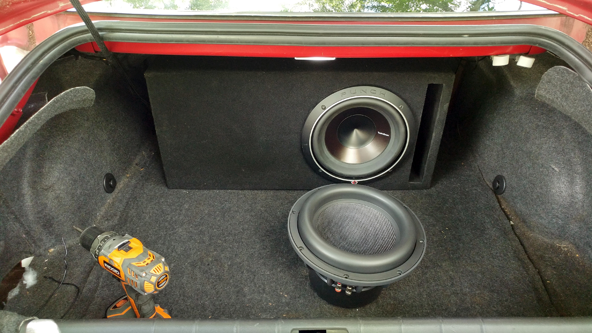

Looks like my mic will be here today and my new subwoofer will be here tomorrow. I am off Wed. and Thur. so I will have the sub in and I will begin the tuning of the stereo yet again. Got the laptop charging... I am ready to go!

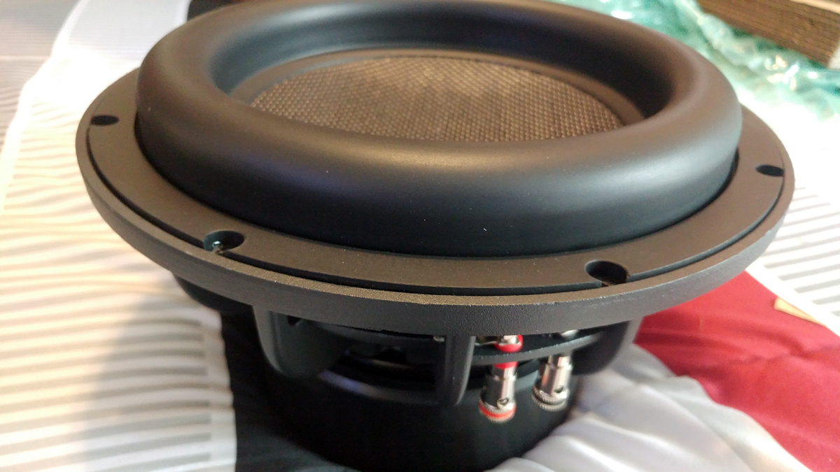

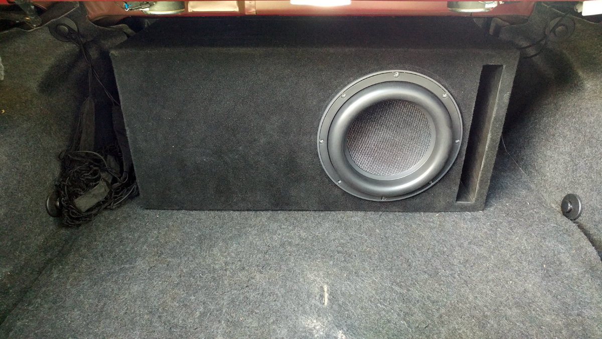

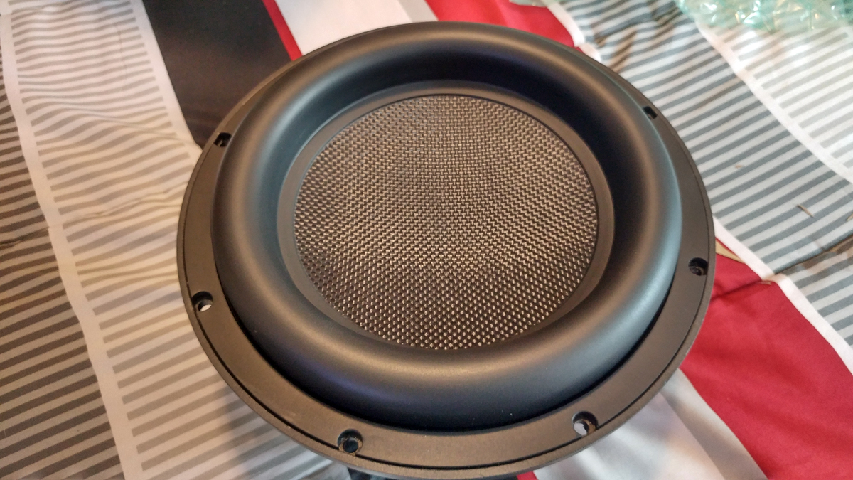

I have been driving around for a while, breaking in the sub. There is an increase in headroom. I have had to back off my sub control knob on the 3.Sixty by 3 - 5 lights on the knob... that's quite a bit. Which means I will have to readjust the gain on the sub amp. It has a different sound signature than the aluminum cone of the P3 Punch sub. I tracked down my sister as she got off work and let her hear some Bass Mechanik. Her response "Damn, that's one sub???" Mind you, I have not played it full tilt yet. I am impressed. I can't wait until it's broken in fully. I am at 1 ohm, the Punch was at 2ohms. Obviously there is an increase in power to the sub and the gain is untouched at this moment.

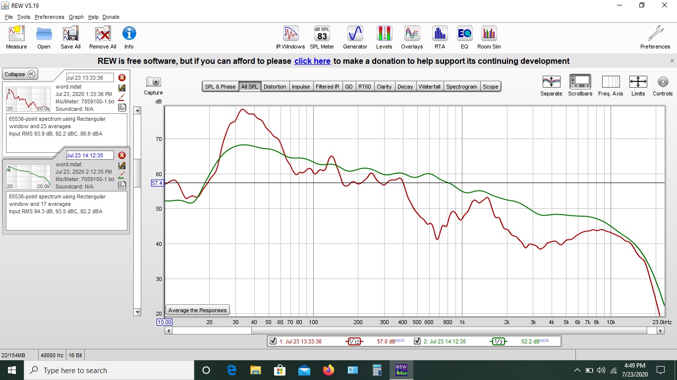

Approximately 45 minutes later it went from the red line to the green line. There were about 20 measurements between them. The red line is the very first reading I took with all EQ's flat. Time delay was still set and the crossovers were also active in the 3.Sixty.3. I sat in the car while measuring and I had the AC on, fan on low, sunroof visor closed.
Please give me some input. How does it look? What needs to be boosted/cut? Any suggestions?
