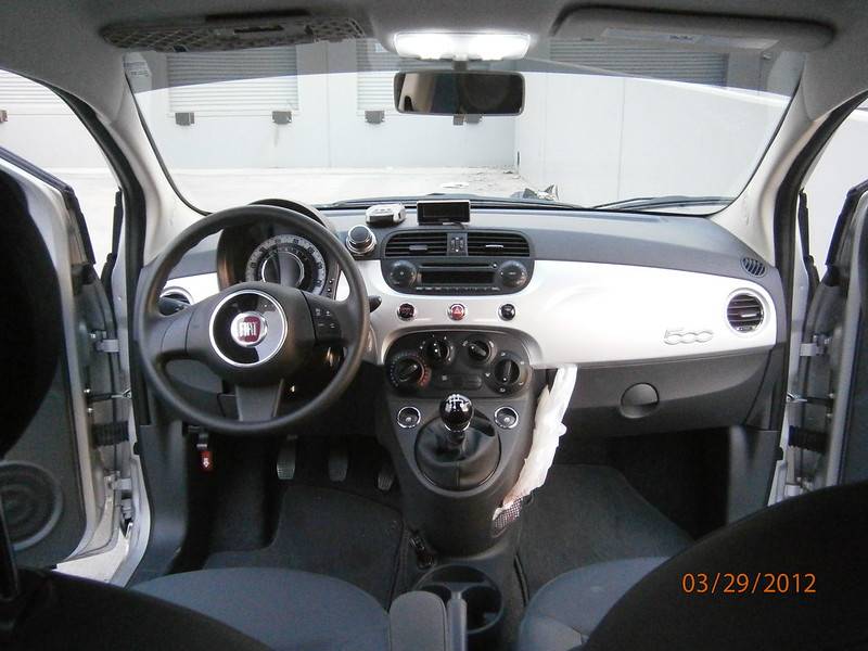

First here it is the day i got it..
Pictures of the car (More refrence size pictures soon)

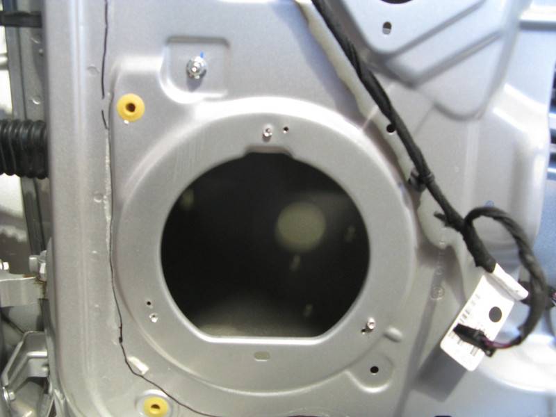

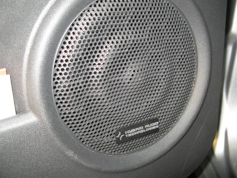

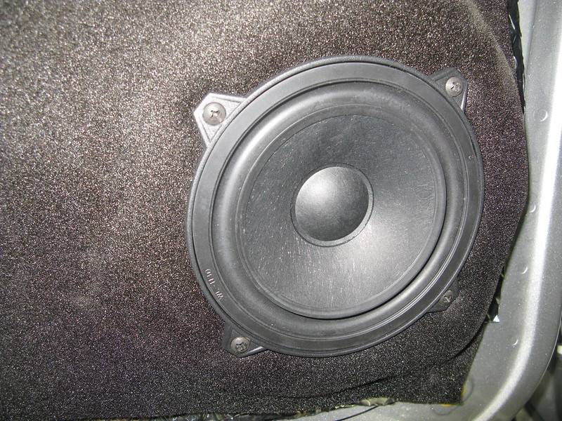

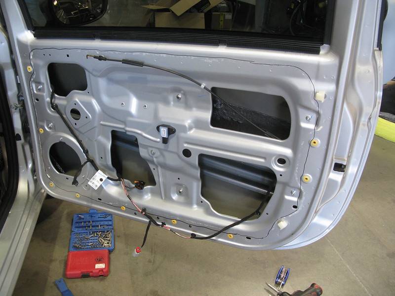

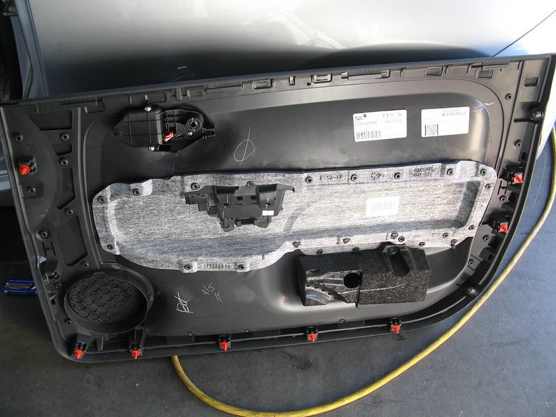

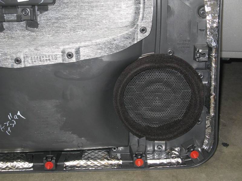

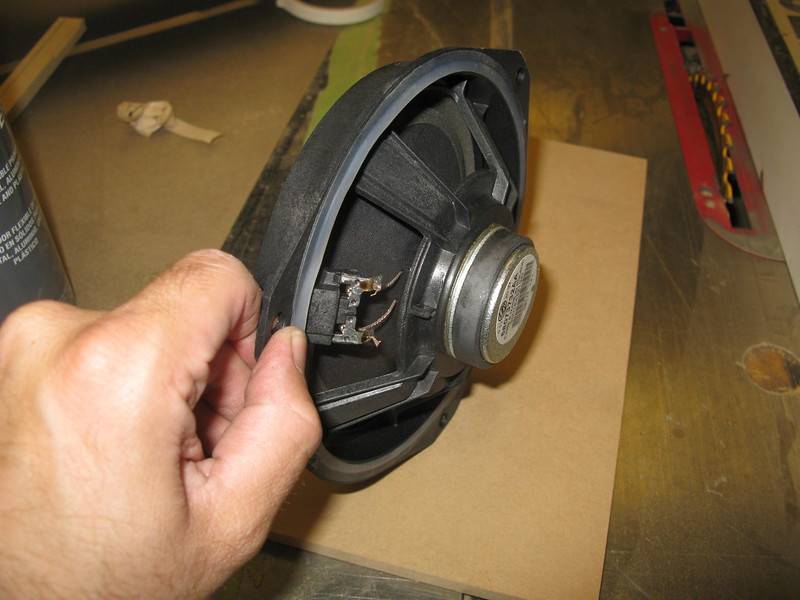

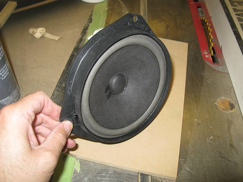

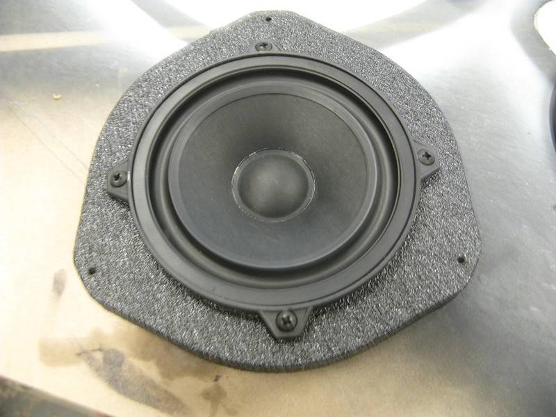

the OEM speaker

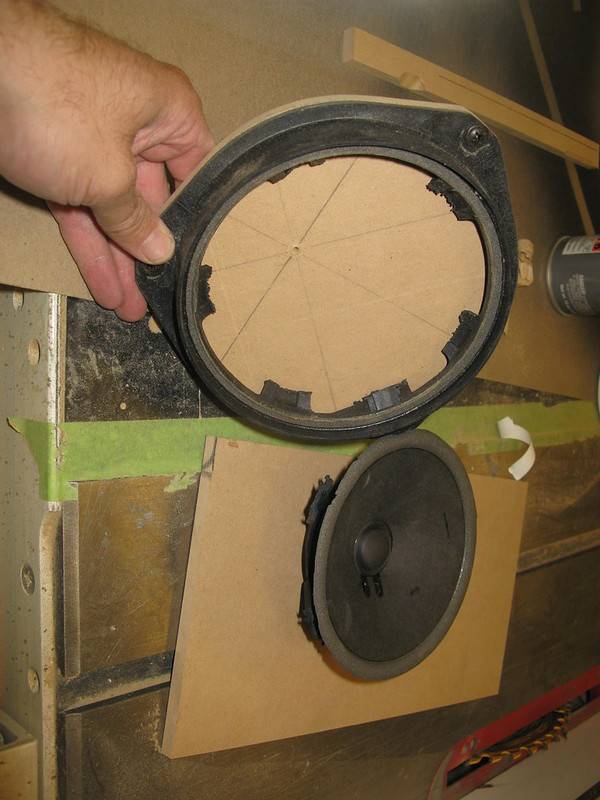

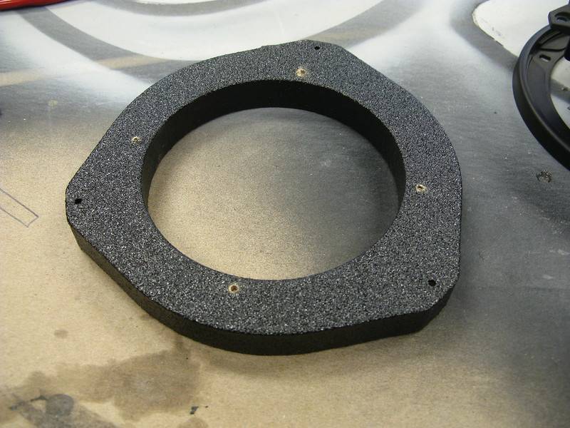

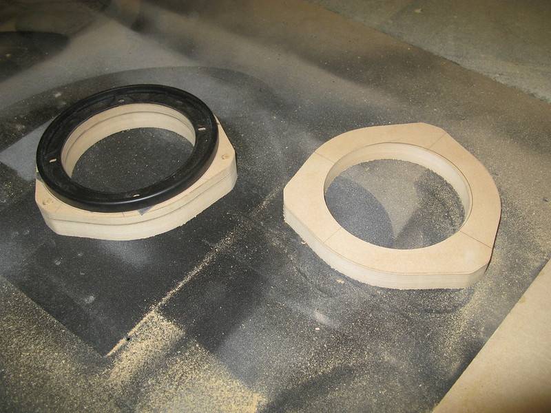

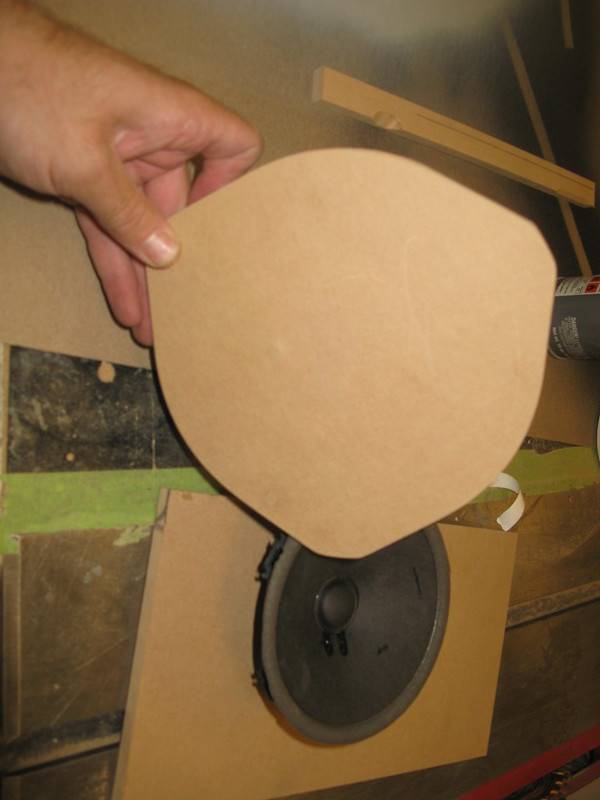

Needed to modify the speaker so I could make a perfect templet..

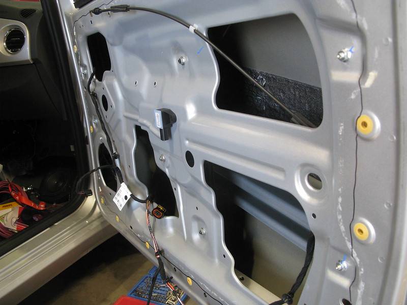

FYI you can install a speakers upto 5" deep in this door..
ok now I have My templet for the Fiat 500..I will finish them after work tomorrow
If you need adaptor rings made PM me I can hook you up..

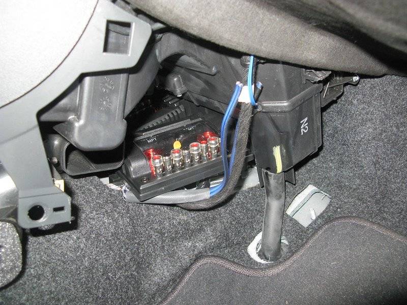

Ok so a bit done today, ran the speaker wire for the Midbass and tweeters, I found a spot for the crossovers.

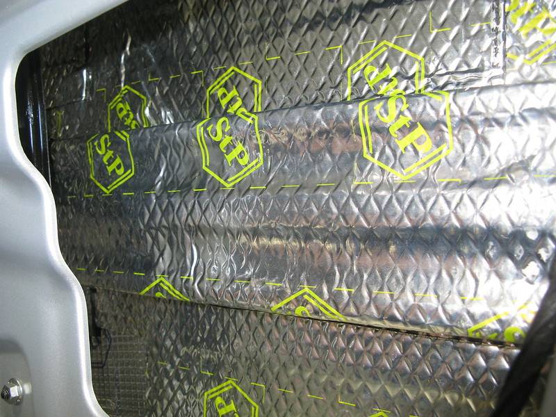

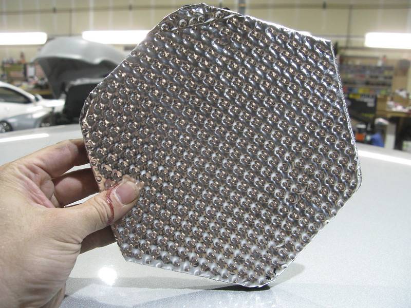

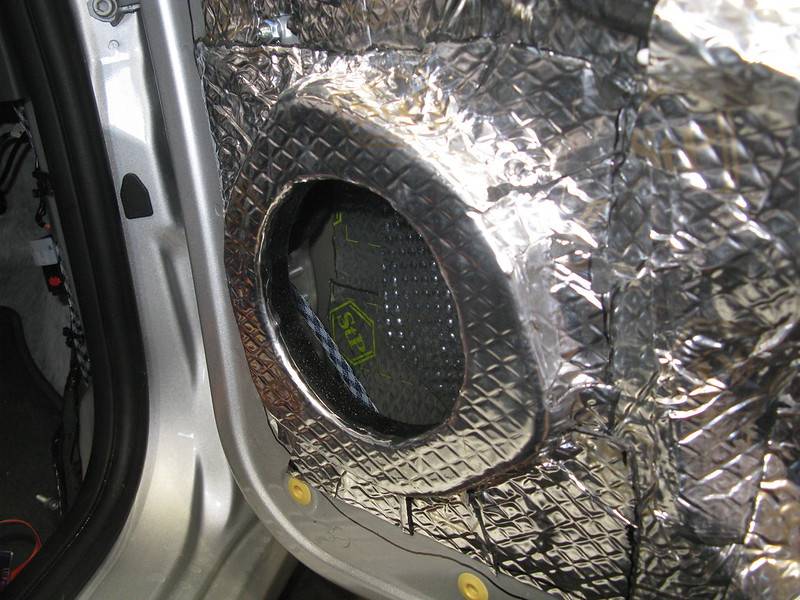

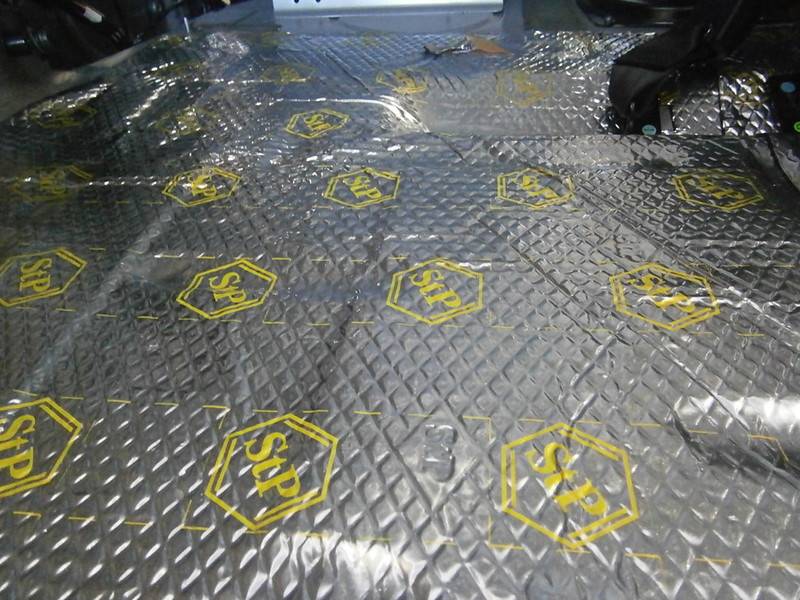

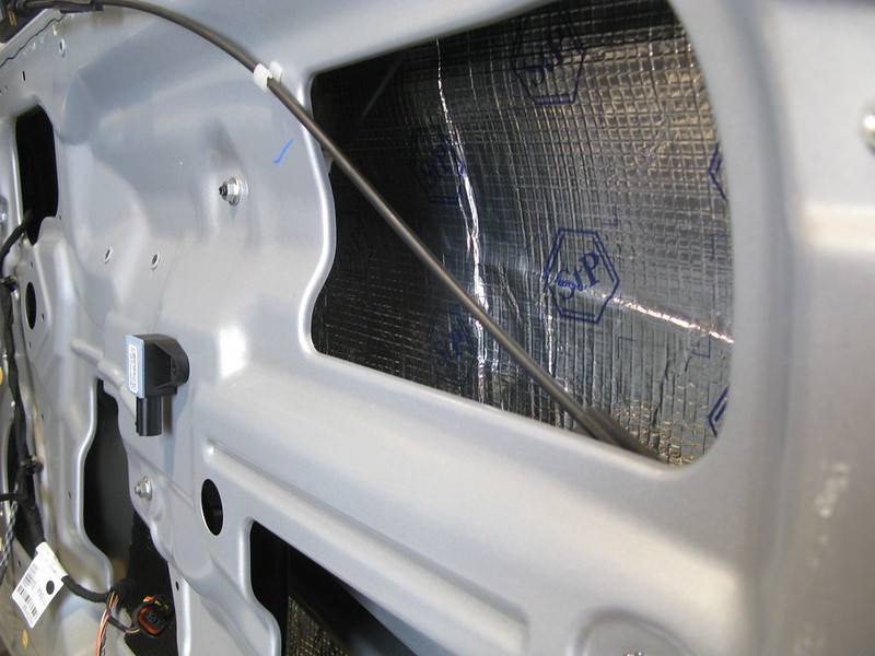

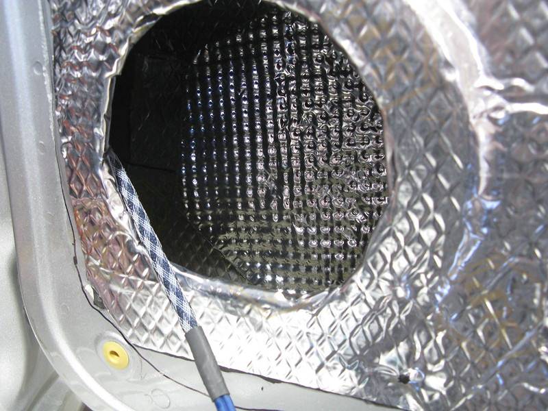

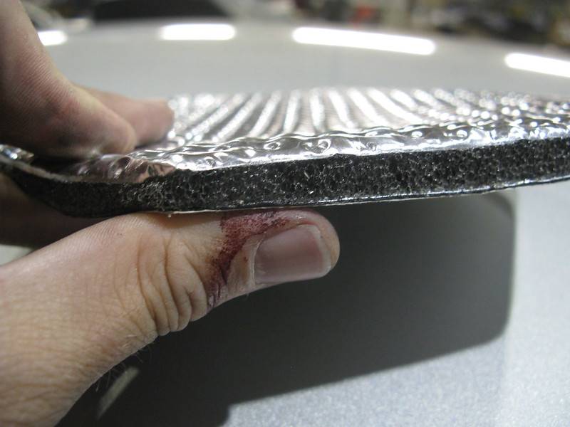

Now I am just waiting for my >>STP Sound Treatment

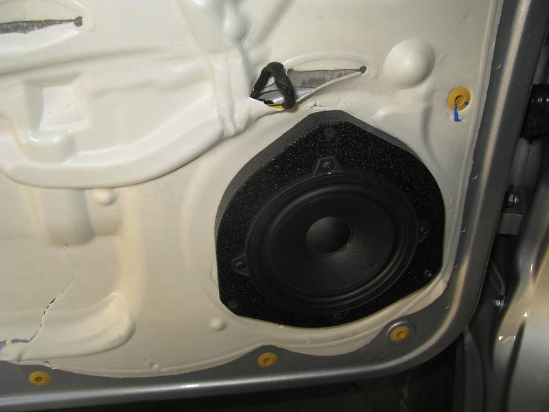

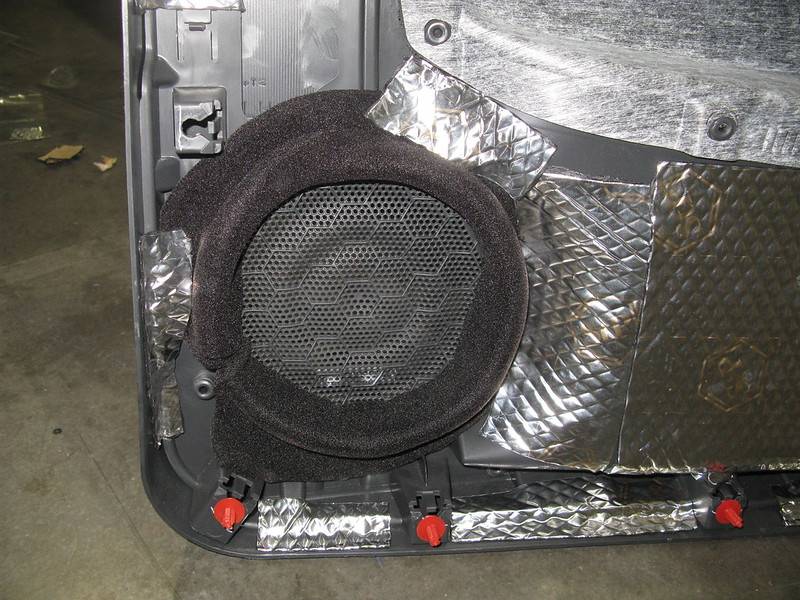

Made the Speaker templet and the base for the midbass drivers..
Got a bit done after work, Thanks to 4-The-Truck in Henderson, Nv for the Line-X spray!!

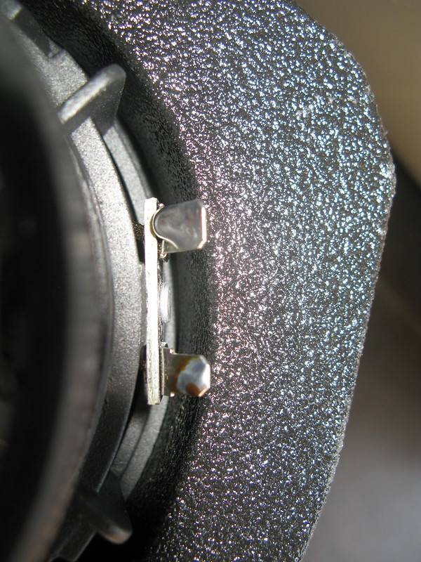

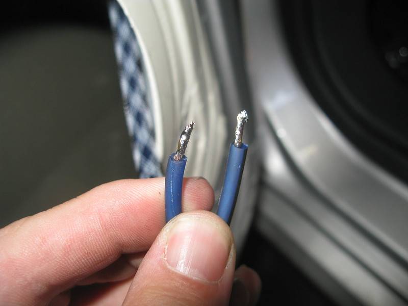

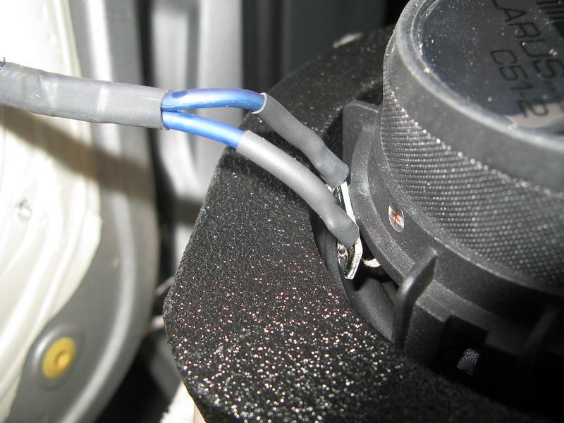

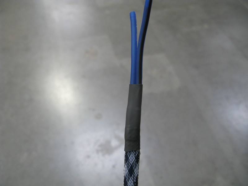

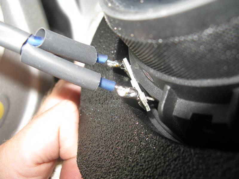

Tined the speaker leads
Tined the Speaker Terminals
Soldered on Heat shrink to make it safe, Negative wire has the Black trace

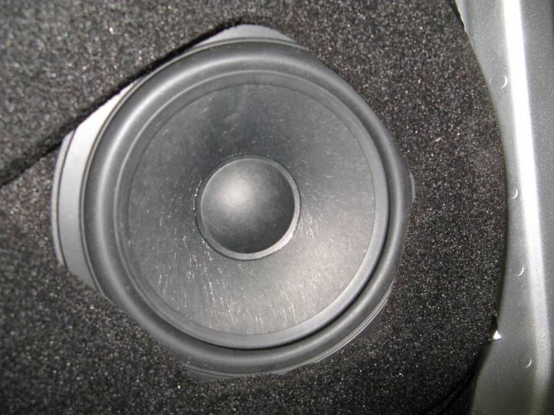

Speaker mounted I am thinking of Nut Serts for the final speaker mount to the door..

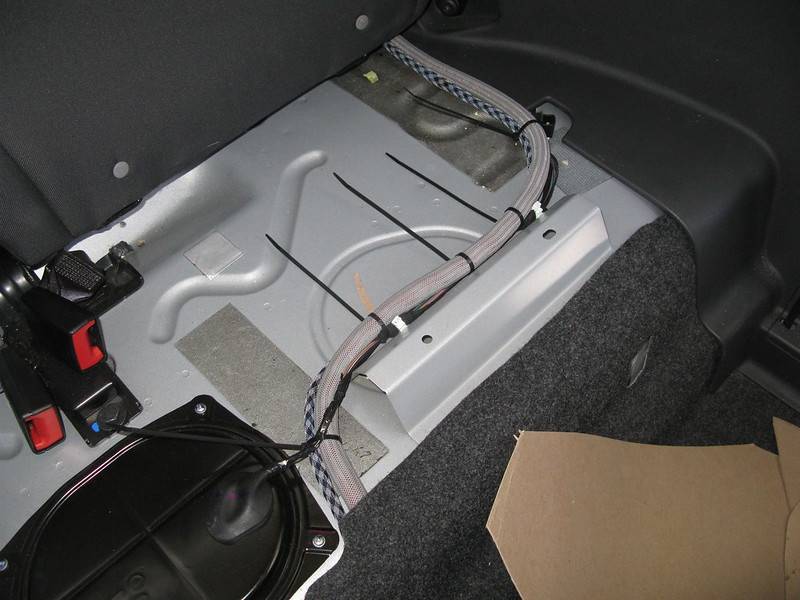

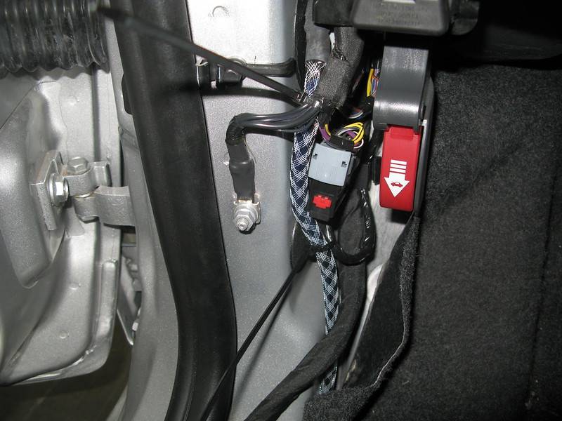

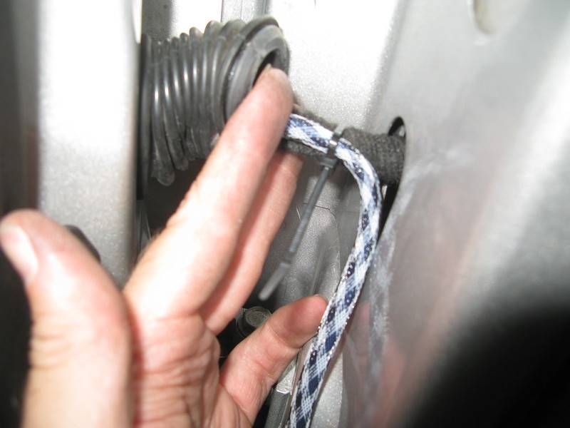

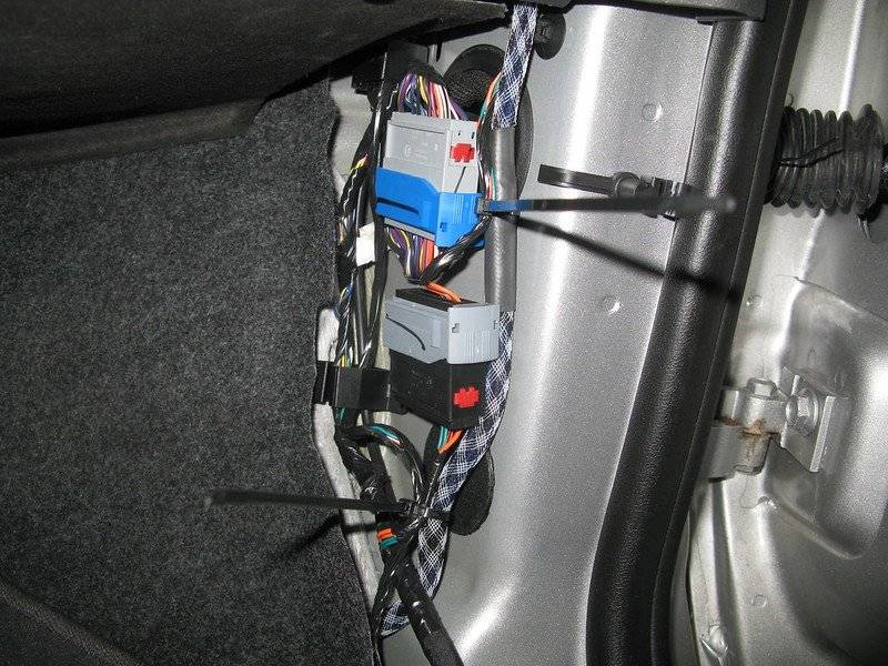

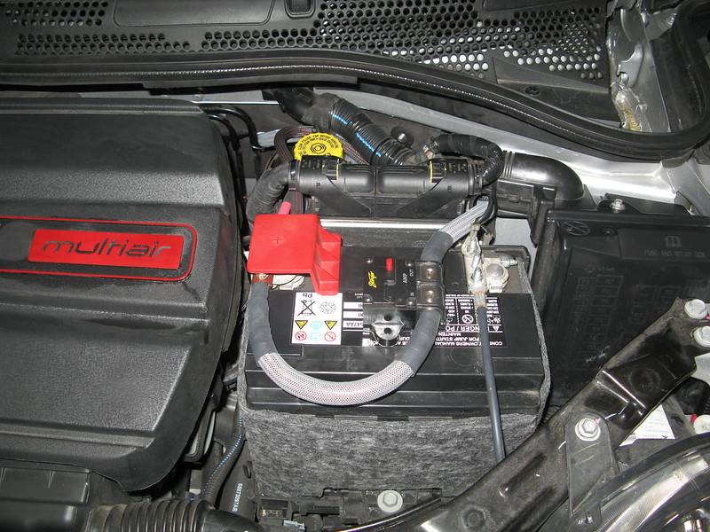

So the other day I got my old power wire out and cleaner it up, now covered in Grey Texflex, I have some pictures showing the proper way to run wire in the Fiat 500.
I Mounted my breaker temp till I get a chance to make the custom bettery holder.

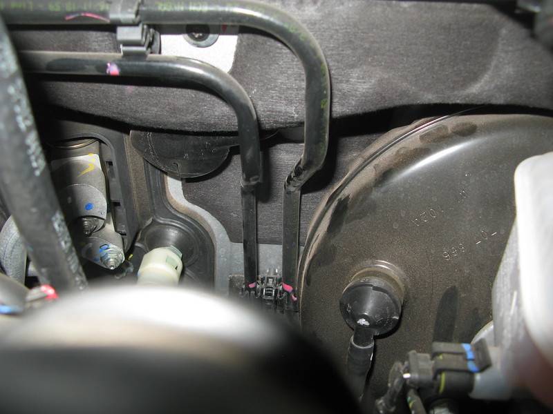

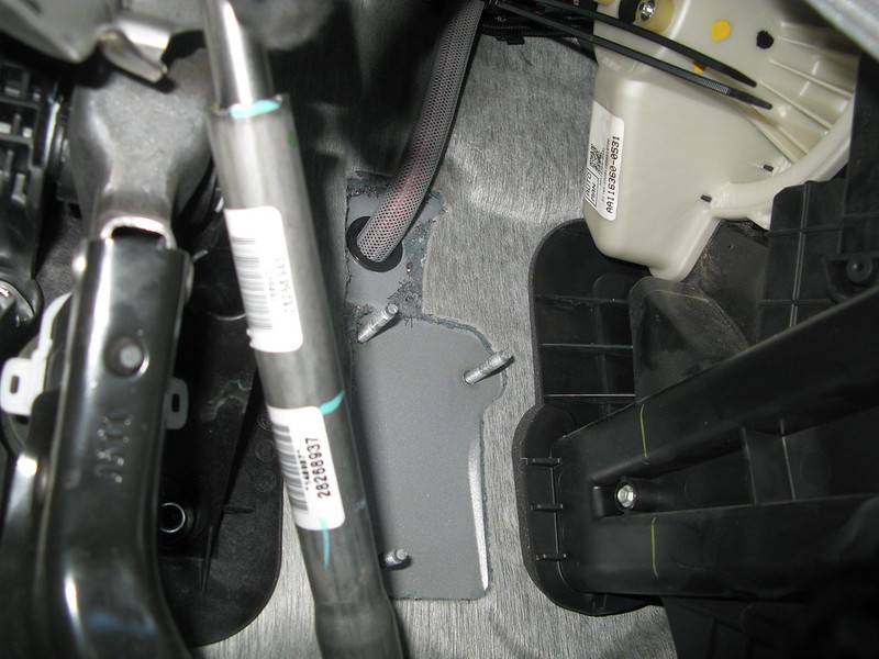

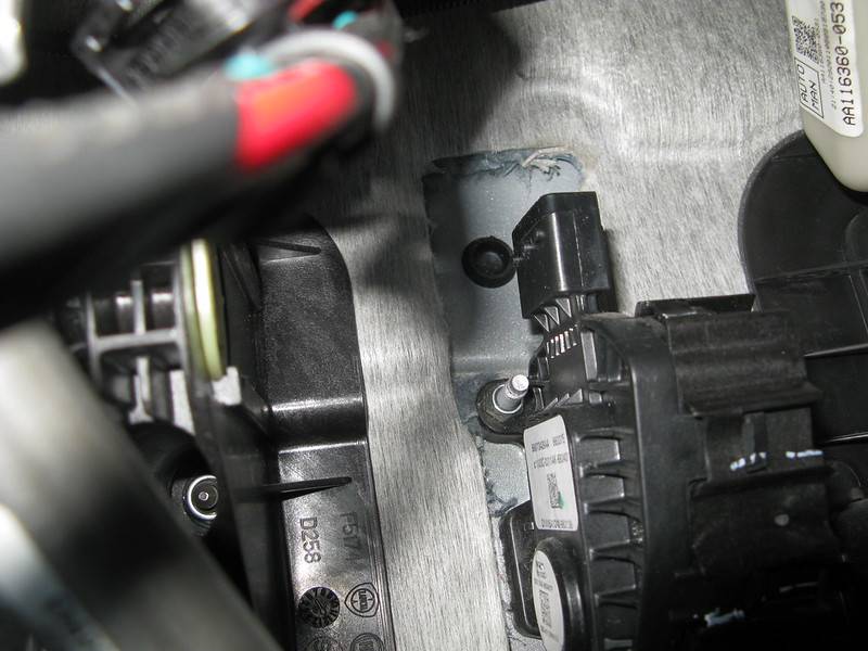

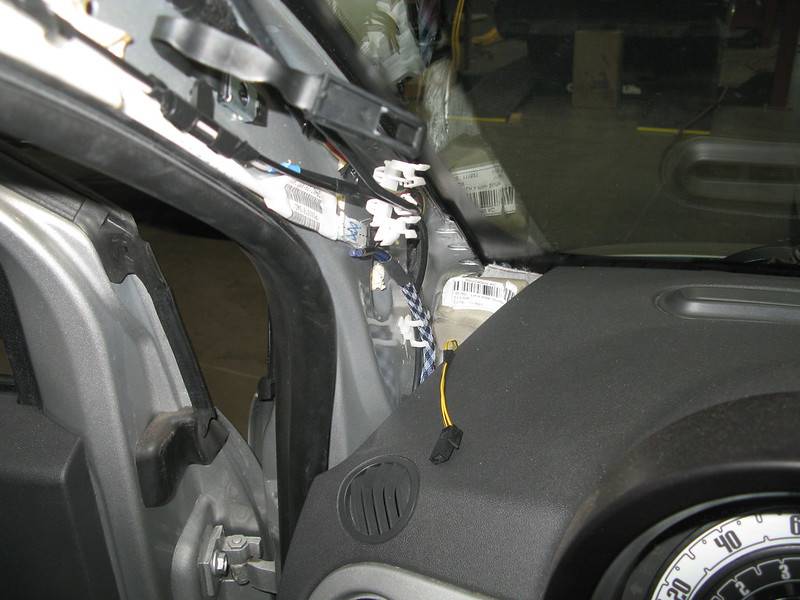

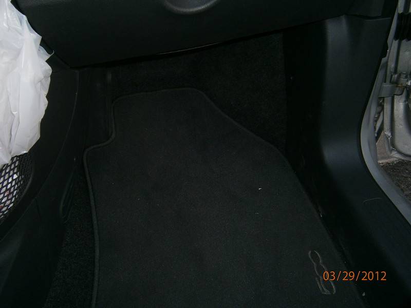

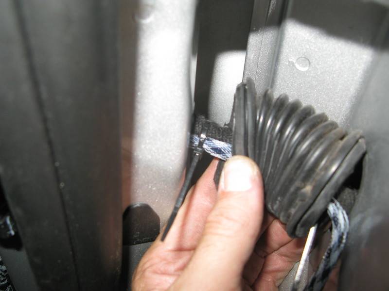

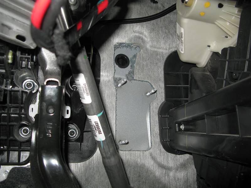

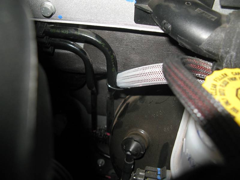

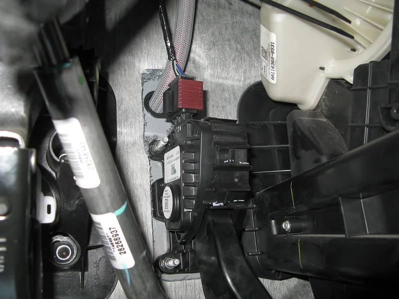

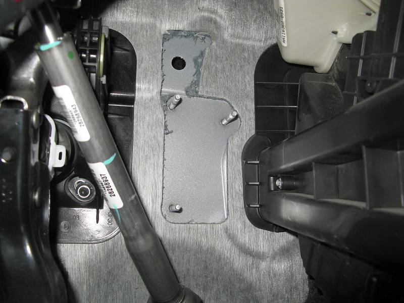

Ok get under the dash find the Burgundy plug Lock, pull and lift.. to remove the connector, you will need a razor knife to cut the fire wall cover away.

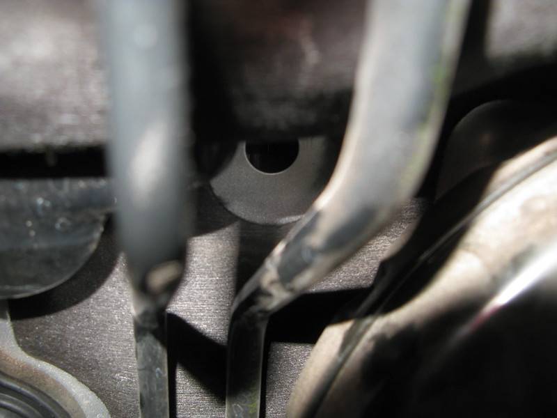

Here are some shots from the engine side.
Looking between the (Black Brake lines) you can see the rubber grommet.
On the second picture you can see on the right hand side under the lip the cutout in the firewall cover.
Use a 10mm deep socket to remove the throttle, I used a Snap ring grommet with rubber seal got it off ebay for $1.30
Sticky pad with ziptie mounted on the under side. (used 90^ bit holder)
I used (3) Zipties to mount the 0awg wire to the power harness under the dash II
The finished product.. I ran the rest under the console and under the rear seat.. more pictures later

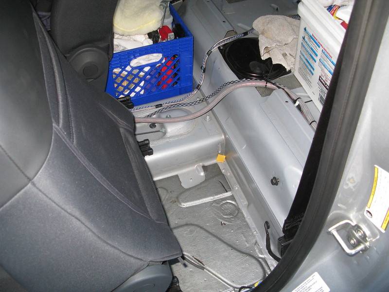

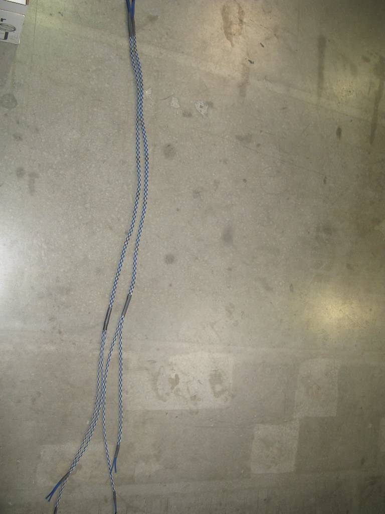

I also ran the speaker input wires to the back..
Waiting on more techflex to show up before running my RCA's and remote turn-on wires back.
I will finish mounting them after the sound treatment is done.

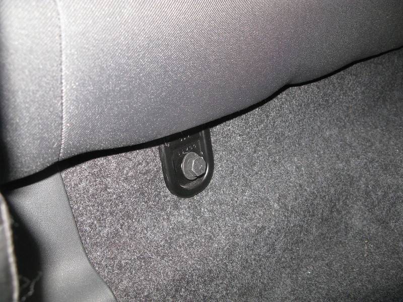

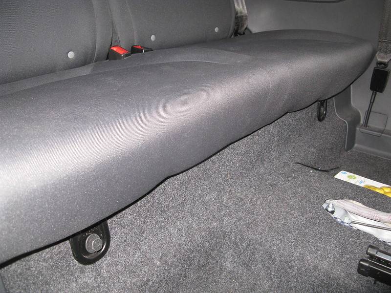

Tools needed: 16mm socket, Ratchet, flushcuts & zipties
Remove the (2) 16mm Bolts lift up and pull out.. its easy dont forget to put the seat belt conections back in place!

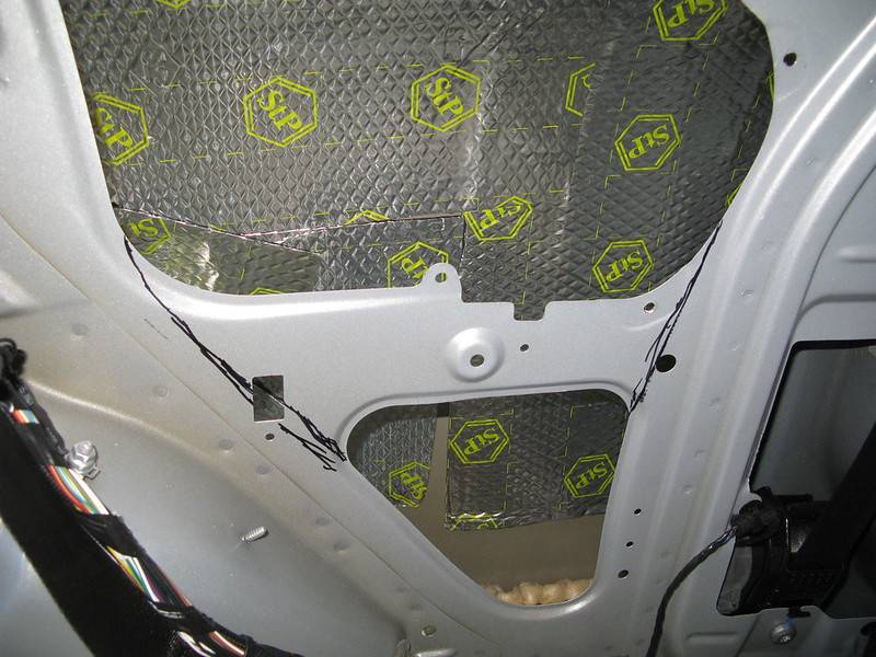

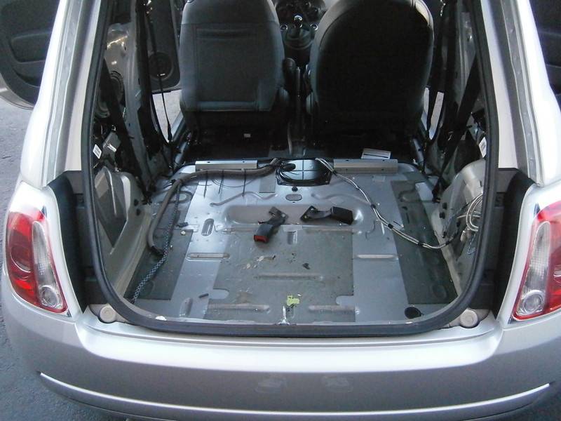

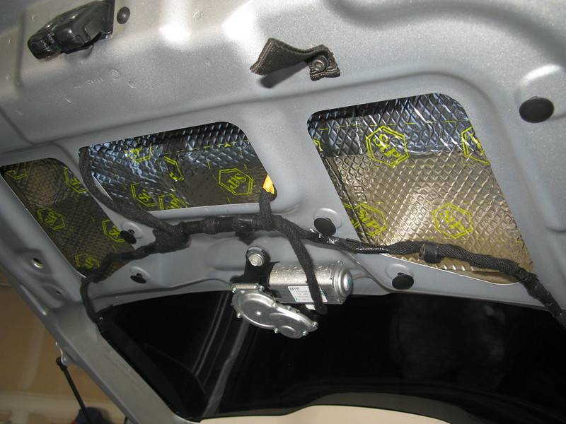

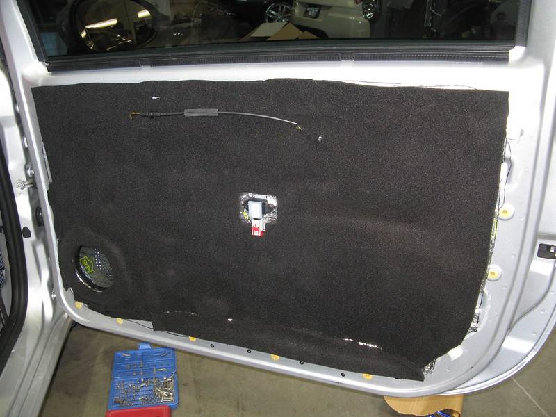

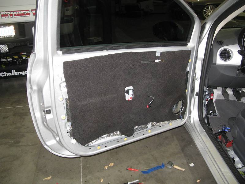

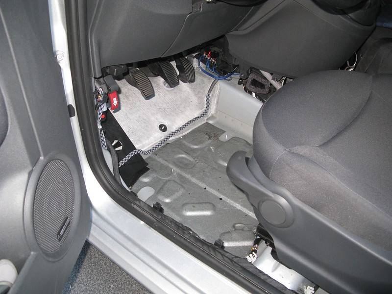

So here we are..
ready for the sound treatment..
---------- Post added at 03:33 PM ---------- Previous post was at 03:33 PM ----------

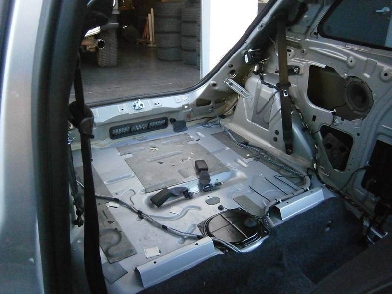

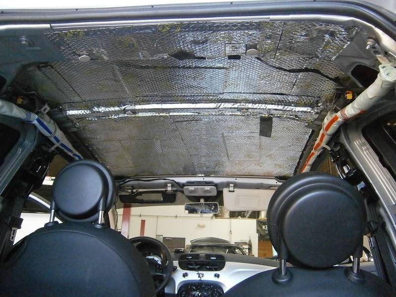

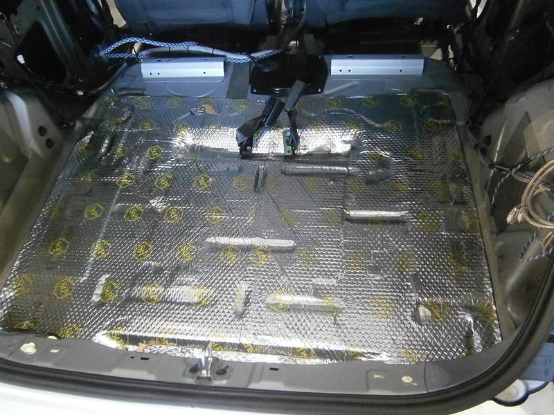

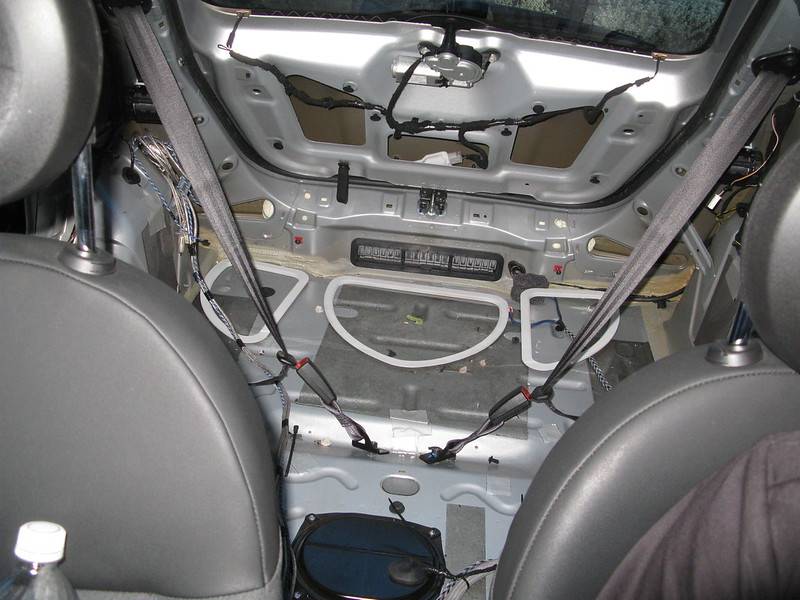

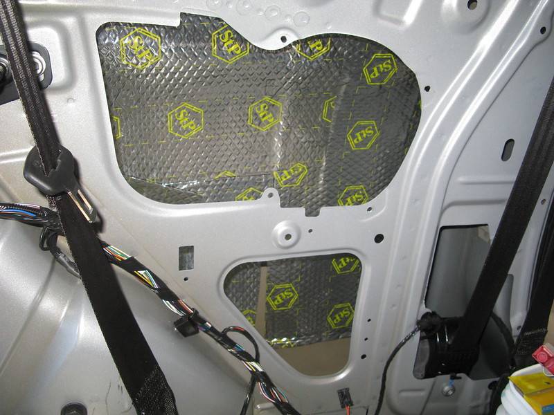

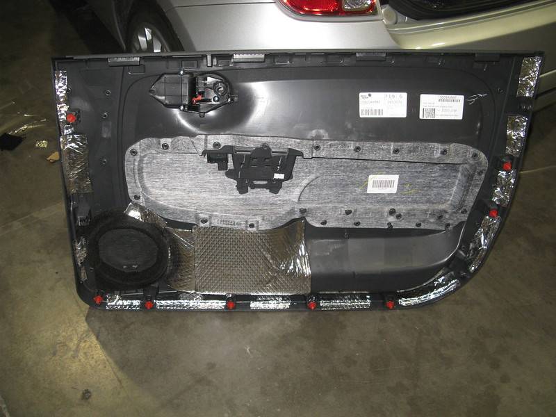

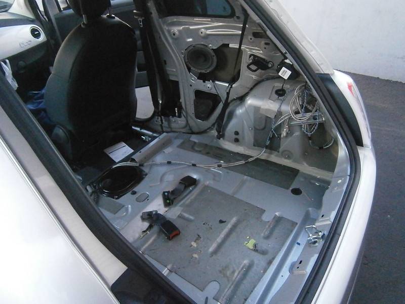

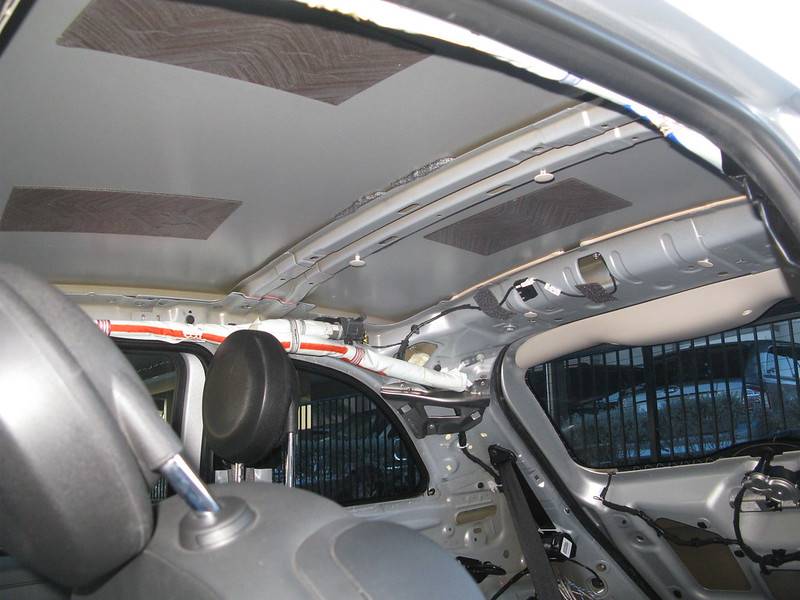

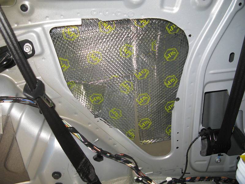

OK still waiting on my Sound Treatment to show up..
But the car is GUTTED!!
here are the pictures of the rest of it..

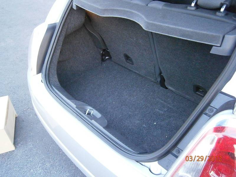

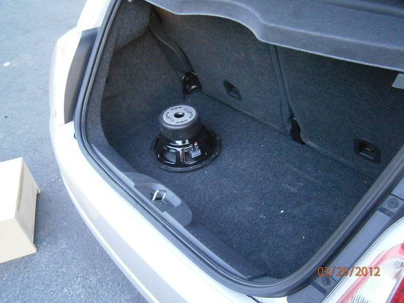

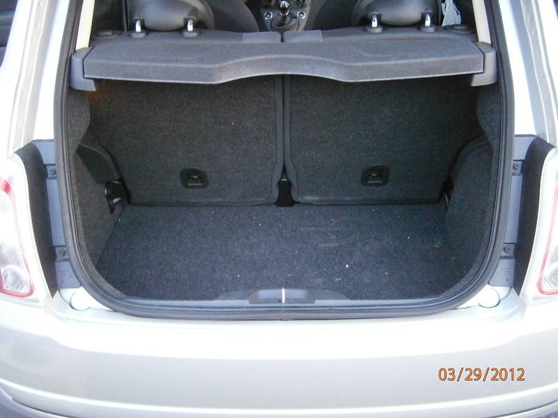

Thinking of doing 8" subs in the rear speaker location...
After the STP Treatment I will fasten all the speaker, RCA & power wires
---------- Post added at 03:37 PM ---------- Previous post was at 03:37 PM ----------
Whoops missed one..

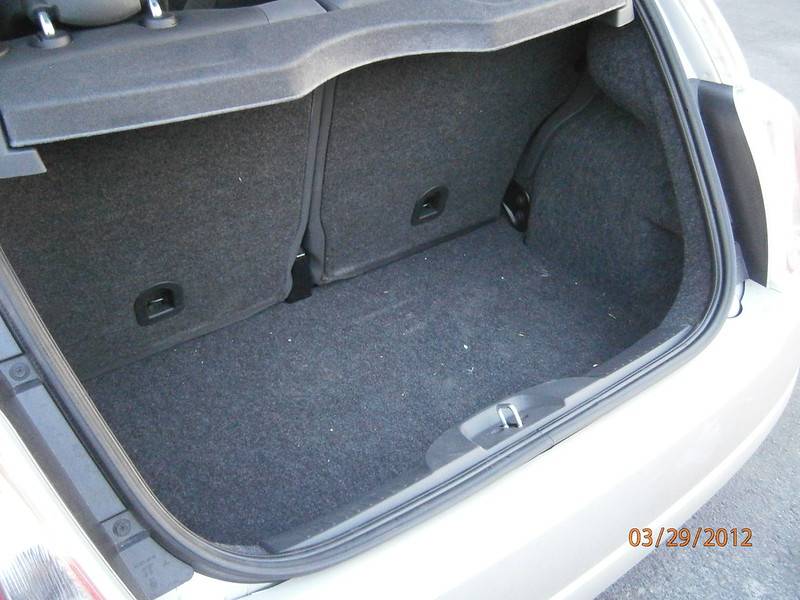

Also looking to install an 8" sub in the rear speaker location, So I did some trimming... quick shot with the tape said I can get just about .5^ so I should be good... here are some pictures..
