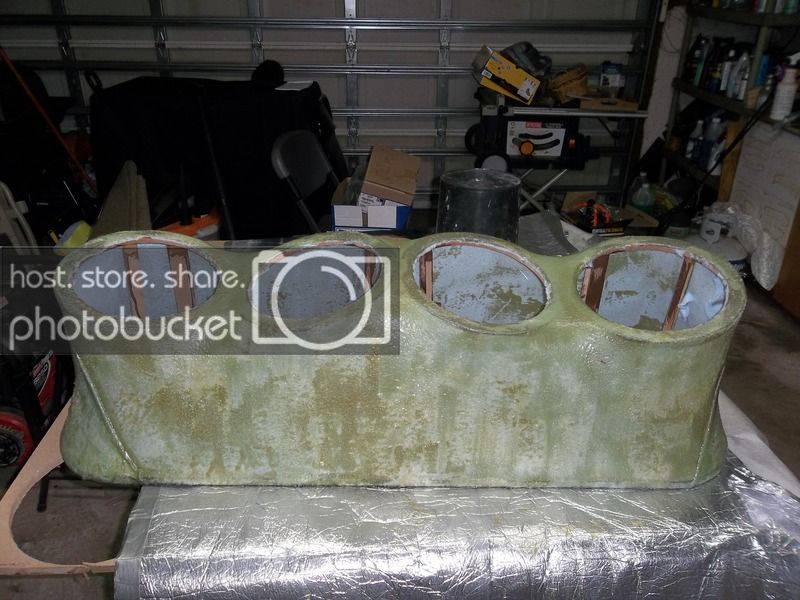

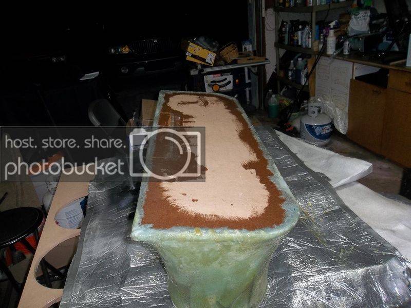

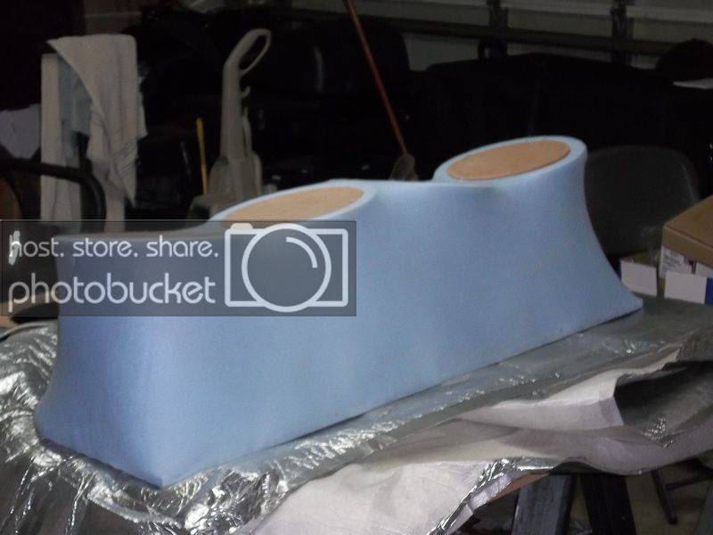

Day 1 -

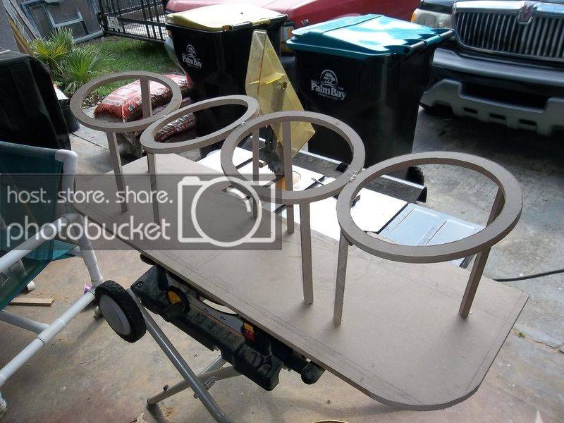

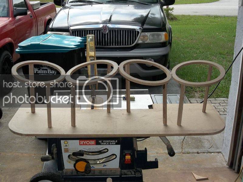

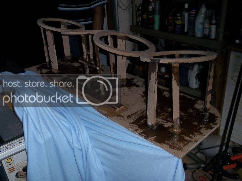

Cut Speaker rings, Bottom Cutout, and first set of braces. Hot glued them all together for fitment test.
Added fiberglass to strengthen joints, and attached fleece to the first edge. . .

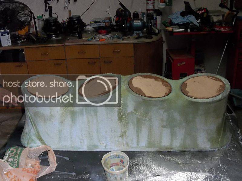

Day 2-

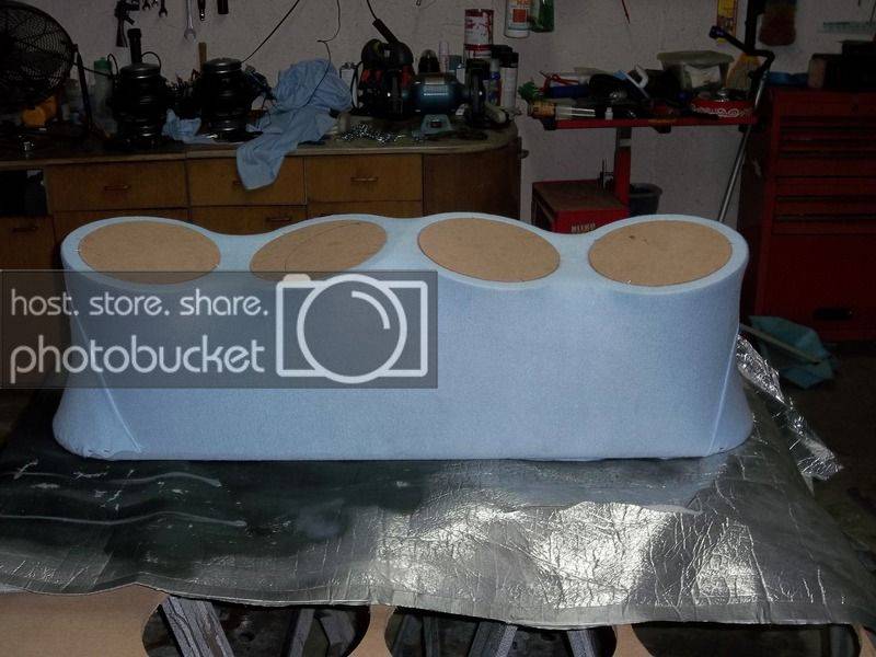

Covered entire box with fleece and dropped in the round plugs
Applied First coat of Fiberglass Resin. Only had a one quart can and i ran out.

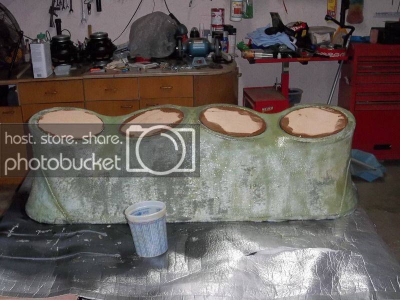

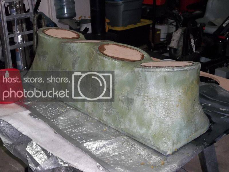

Day 3-

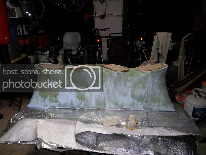

Bought a 1 Gallon can of Resin and applied a full coat over the enclosure. Once it dries, i can start applying the actual sheets of fiber glass
applied more to bottom edges to seal around the fleece

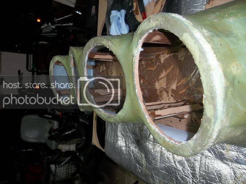

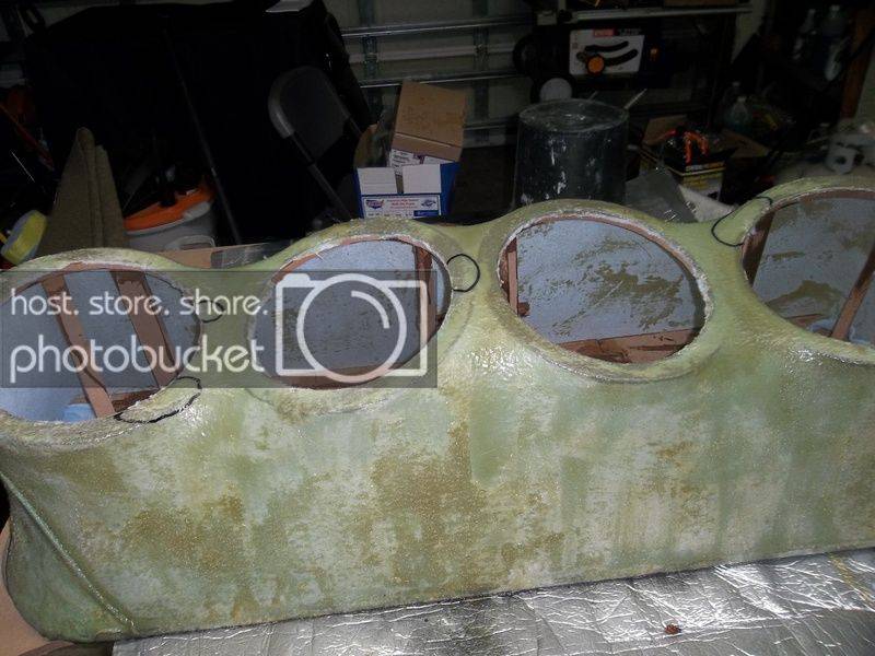

The first layer of resin has cured over the fleece, i knocked out the speaker ring plugs and did a test fit . . .

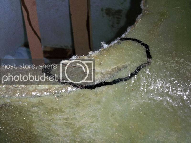

The black circles are where the resin cracked when removing the plugs. A minor setback, as all i have to do is apply more resin to seal the cracks. In hindsight, I would have probably wrapped the speaker ring plugs in saran wrap so the resin wouldn't have actually stuck to the plugs causing the few cracks.
This is the worst crack, i may have to actually cut this small piece off and apply some fiberglass strands to repair and strengthen it. .

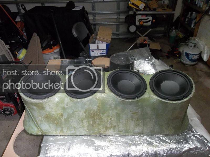

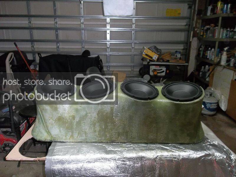

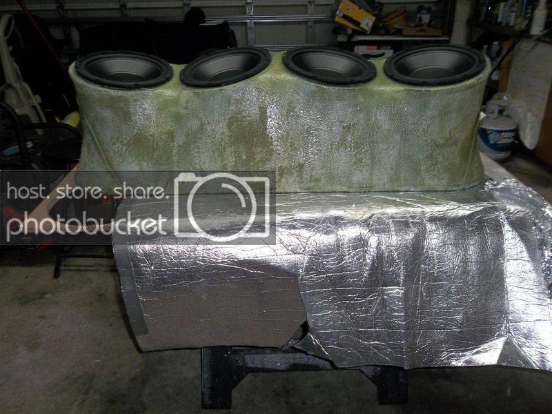

And here it is with the subs staged. .
