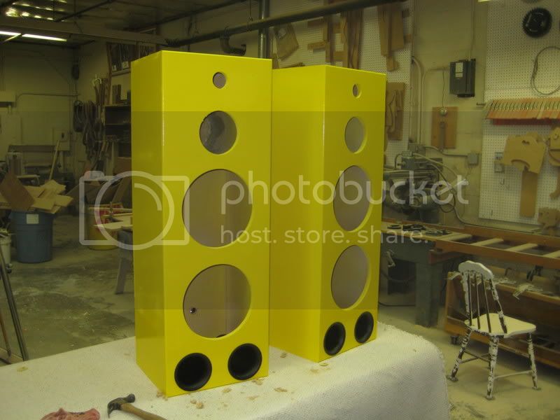

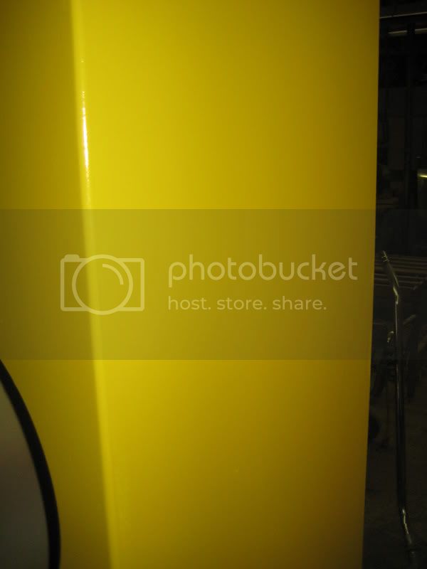

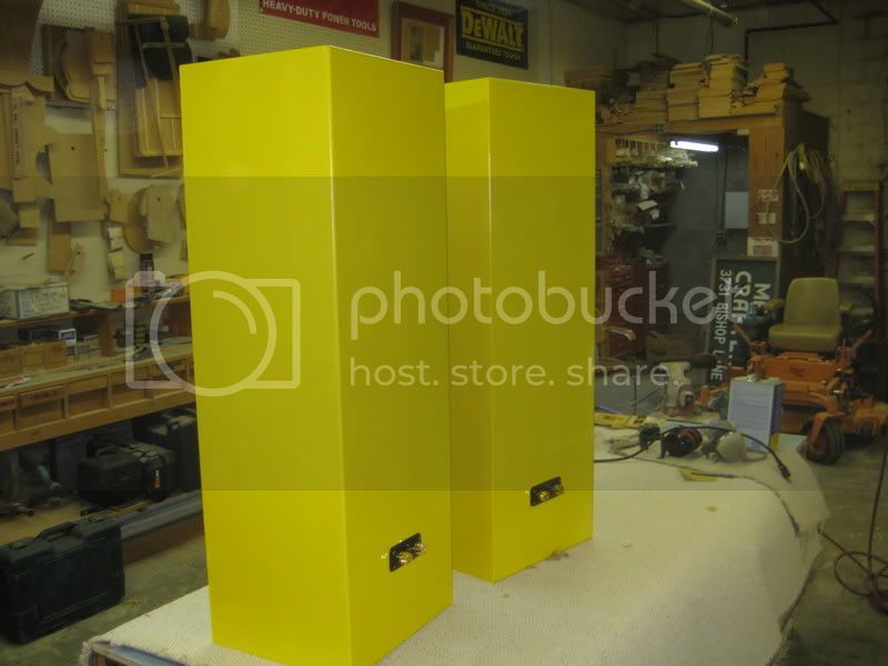

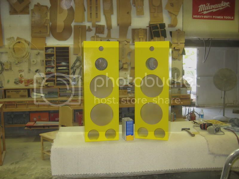

unfortunately I didn't get started on it. I had to move shit into my house. Im sorry for the disappointment. Heres some pics however..
Ports...
Terminals

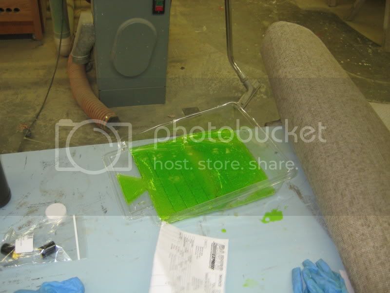

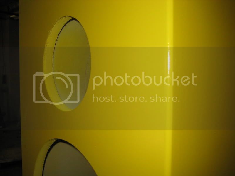

O well that makes sense. I tottally ****ed this shit up and i cant tell if they will even work. Also i went to put the tweeter in also made that hole to small somehow. **** my life. Im scrapping the whole project. **** crossovers.
This shit:

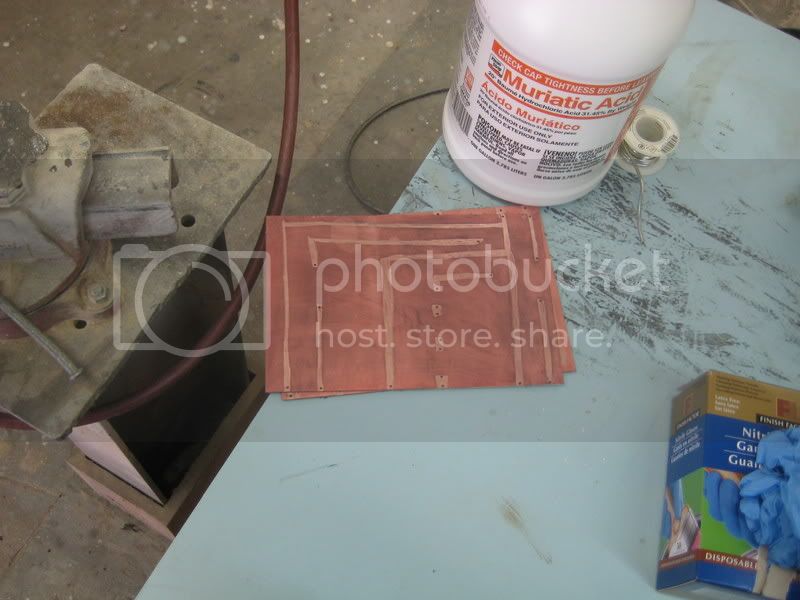

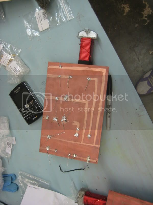

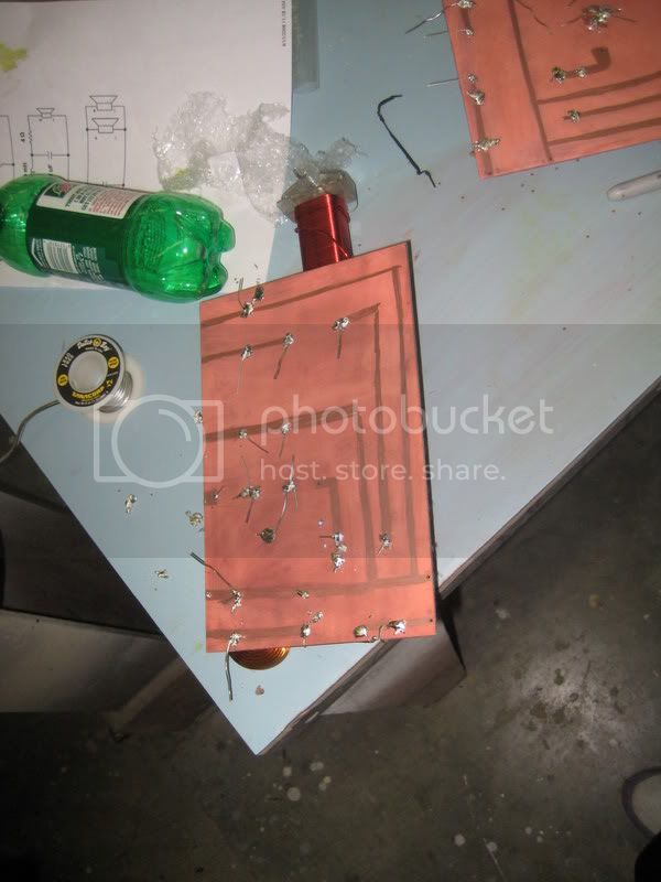

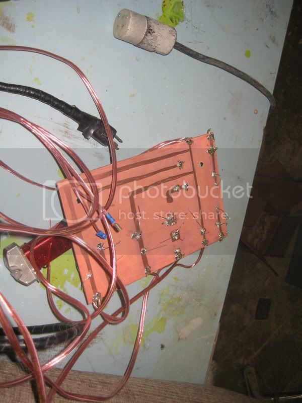

Heres the crossovers. They look like absolute shit...

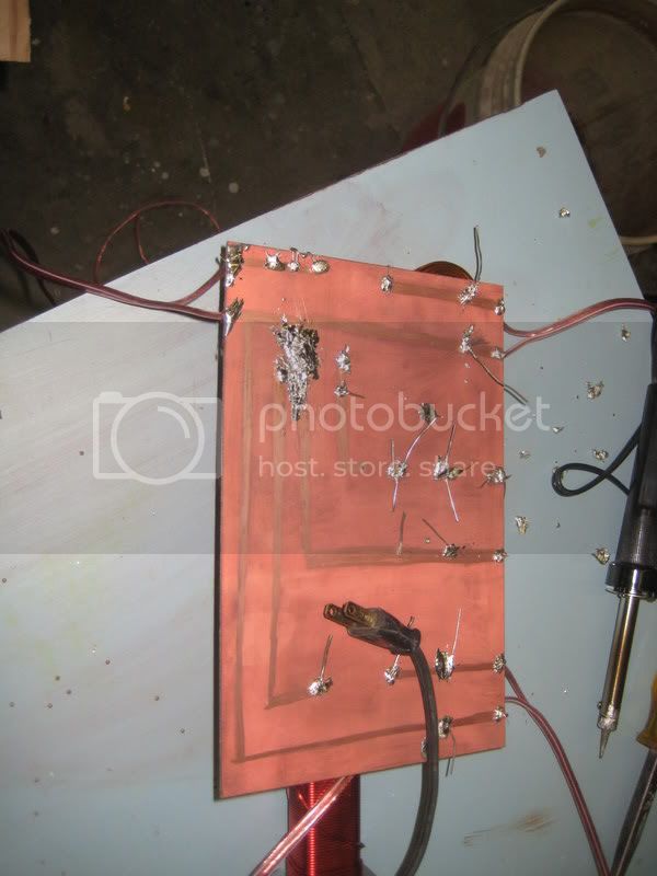

Here is where i ****ed myself with fuccking solder.
Here is close ups for pv.
Wow, what the hell did you do to the PCB's? Those aren't etched. You need to leave them in the solution until all of the copper is gone except for the sharpied parts. I see that the solution worked properly by the green color, but it should be much darker.

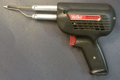

I consider precision to be anything where you need fine control over the tip. Holding something like a gun is nowhere near as precise as holding something like a pencil. That plus guns get far, FAR too hot for my tastes.
