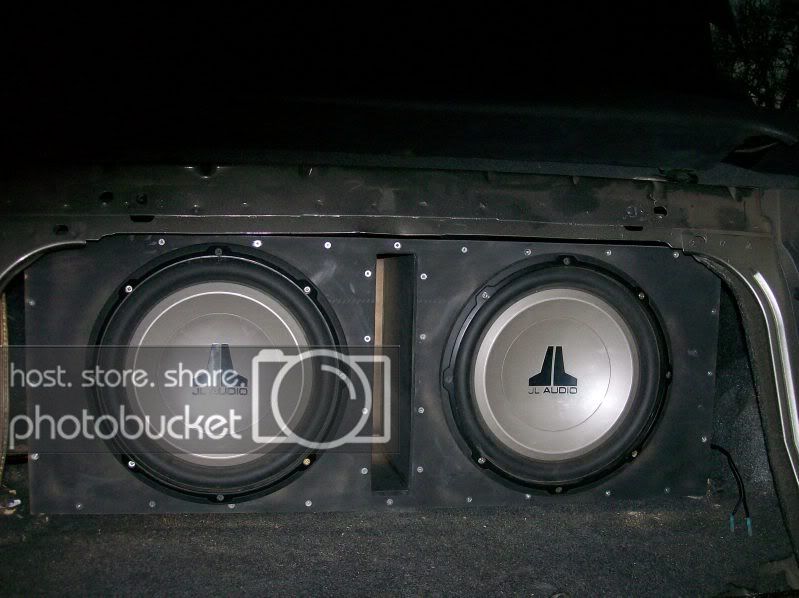

Look My Design Over! For my friends Mustang. 2 12" JL's
like that....
thats a pic a guy trying to build the box sent me to see if it was correct because I had built the design or a variation of it on many occasions..
the design came from a dif forum by a factory rep that also is an expert in the field and a former world champ it has worked amazingly well so if it is incorrect I would like to know lol
You did something wrong. A 12.5"x3.5" port opening is going to take up 12.5"x5" inside the box, times whatever length you need. You're saying the port is only taking up .28ft^3, which would mean it's only 7.75" long inside the box.
12.5"x5"x7.75" = 484.375in^3
484.375 / 1728 = .2803ft^3
correct i fat ******** the calc and forgot to calculate the total length that is only the 2 L's lol
it should be closer to 2.77 cf right?

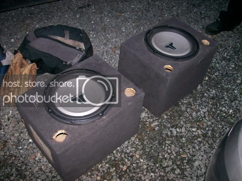

OLD BOXES, the car audio shop here DFM Car Audio's $400 Cutsom box! lol WTF

How did that wind up sounding?
I agree with RAM in the port discussion. I also second guess my lengths though...I wind up doing the math at least 10 times before I talk myself into cutting LOL.
I figure the needed length for both a single big port and dual ports, and find the difference. Then I figure the added length I need based on what percentage of the port is after the split...seems to work well. Like if I need 4" more length per port using dual 12"x2" ports, and I have half of the port length in the single port and half after the split, I'll simply add 2" to the overall length needed.
