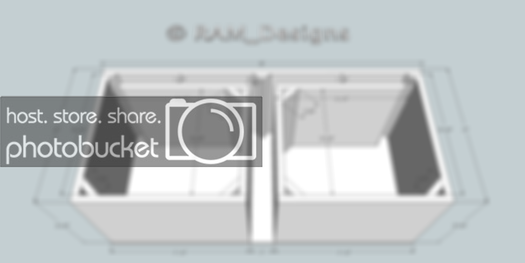

Look My Design Over! For my friends Mustang. 2 12" JL's

What's so hard for you to understand that splitting a single 12"x2" into two 12"x2" ports does not give you the same port area as the single 12"x2" port that he started with?

ok then fine since you seem to remember that thread ... riddle me this...
¾: MDF
32” wide x 14” tall x 17.5” deep
Port = 12.5” tall x 3.5” wide
Length will be an L on either side : 12.5” deep and then 3.75” behind each sub
what is the volume and tuning of this enclosure..

You are not taking into account that you're wanting to make it into two ports, so why are you not saying 2x2"x12"? With two 12"x2" ports you have 48in^2 of port area, which is twice as much as the 24in^2 you started with. Jesus Christ this is getting ridiculous.
I see what you are saying yes... but from what I learned that would be exactly the same as starting the slot off at 2" wide and tapering it to 1" ( ignoring the other side of the L and doing it as a single sub enclosure..)
or when you wrap the port back and forth in the box and forget to account for the bends... it changes the port volume...
area * length = volume = tuning... so explain it with math to me if you would.. I can understand that easier than words apparently

You need to be more specific about the box. It'd be better if you posted a picture. There's too many questions about the port.

It's just pretty simple, in order to keep the cross-sectional area the same, you need to halve the width when splitting the port into two separate ports. I'll try to find something...
In this case, the 13.5"x3" port, which has a port area of 40.5in^2, is divided into two 13.5"x1.5" ports. This gives each individual port 20.25in^2 of port area, or 40.5" total, which is the same as the original single port.
3.51 b4 port3.23 after port but w/o sub
You did something wrong. A 12.5"x3.5" port opening is going to take up 12.5"x5" inside the box, times whatever length you need. You're saying the port is only taking up .28ft^3, which would mean it's only 7.75" long inside the box.
12.5"x5"x7.75" = 484.375in^3
484.375 / 1728 = .2803ft^3
