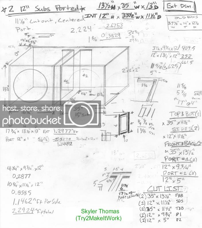

Look My Design Over! For my friends Mustang. 2 12" JL's

I just got done with this one, its 2.29 cubes at 38-39 hertz. the port is 2" x 12" with a port length of 17 1/4". With sub displacement it will bump that up to 40-41 for tuning and thats just what I want. Its 2 Old school JL audio subs getting about 500Rms. Thanks!
before i got to it the amp was in the back with his baseball stuff bouncing around. So im just taking the 2 Shat boxes he has out now and making him something 'decent' and i know what hes looking for, so thanks for your 2 cents.....
first off are you sure that will fit? if its a truck mustang the opening is a veryy small opening so check that! personal id tune lower for daily with hiphop rock ect....
Yes, I agree 100%, But this is what he wanted... I was very limited by the opening of the trunk. I made a model out of cardboard and did a test fit and it was close but it will fit. right now he just has 2 truck boxes in there and there the Kragen specials....

EDT: and i ran the option of doing two bigger seprate boxes at a larger price though due to wood used and he didnt want to.
Should i go with a 4" Round port then?? box is 2.75^ft by its-self....
Ya once i figured the box was going to be so small I was over there at 11 pm up in that **** trunk, double-checking everyting so i could make the box bigger so this is like max size with the lowest tuning i was able to do with out exploding....//content.invisioncic.com/y282845/emoticons/banghead.gif.8606515f668c74f6de0281deb475b6fd.gif
you can get a better tune in less space using round ports ( they take up less airspace is why ) it is really a matter of preference tho... my ears tell me slot is louder but it may just be my ears...
Yes something in the final sound of definite bass and not a 'whooshed' or cross washed bass.
