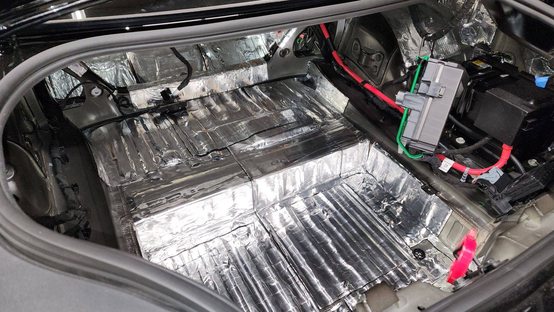

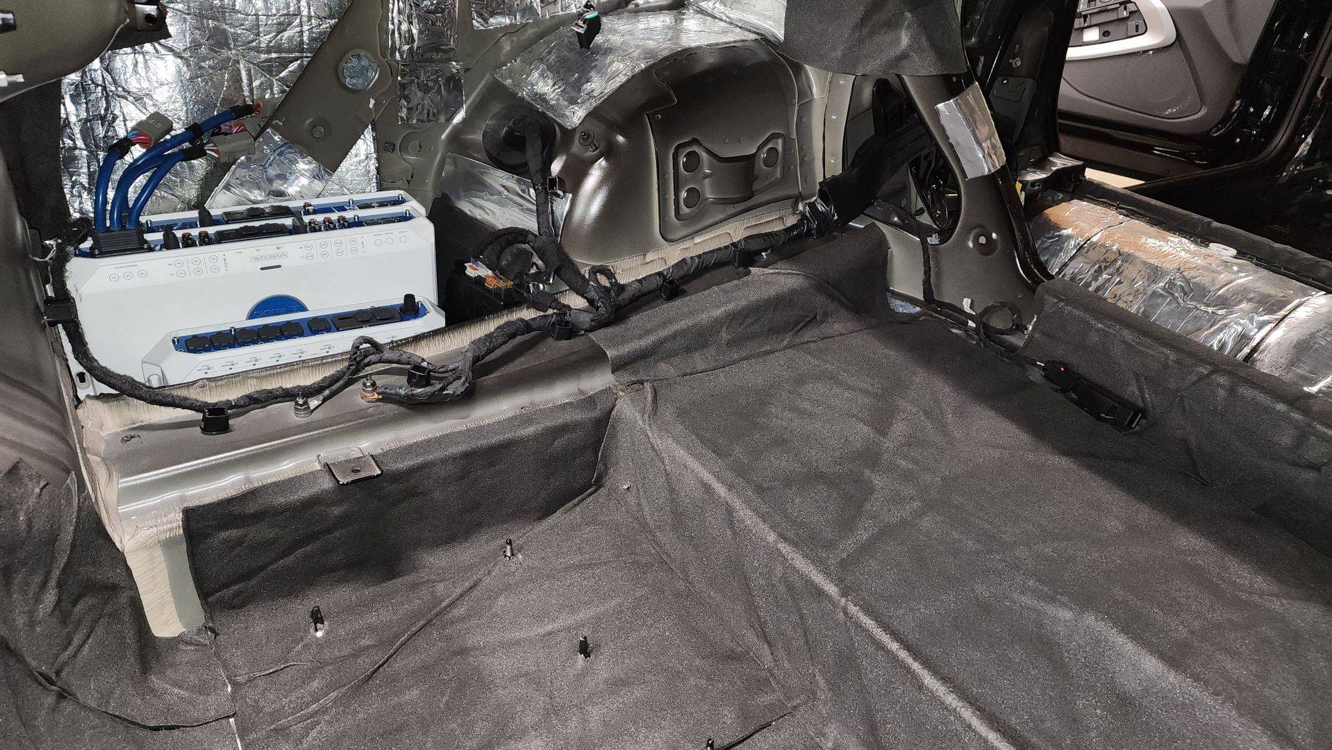

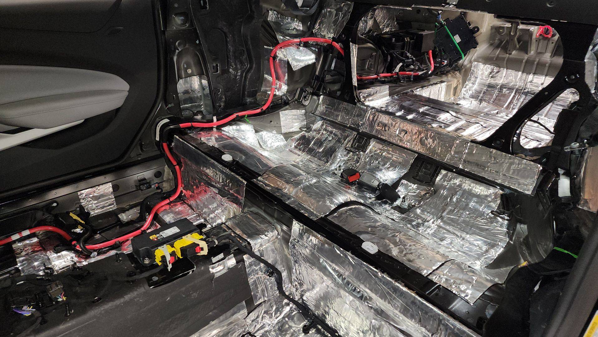

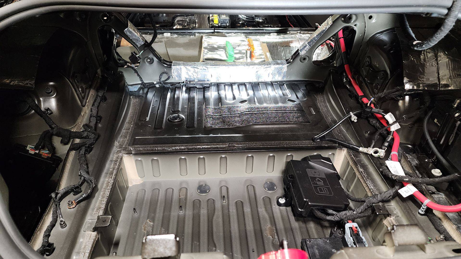

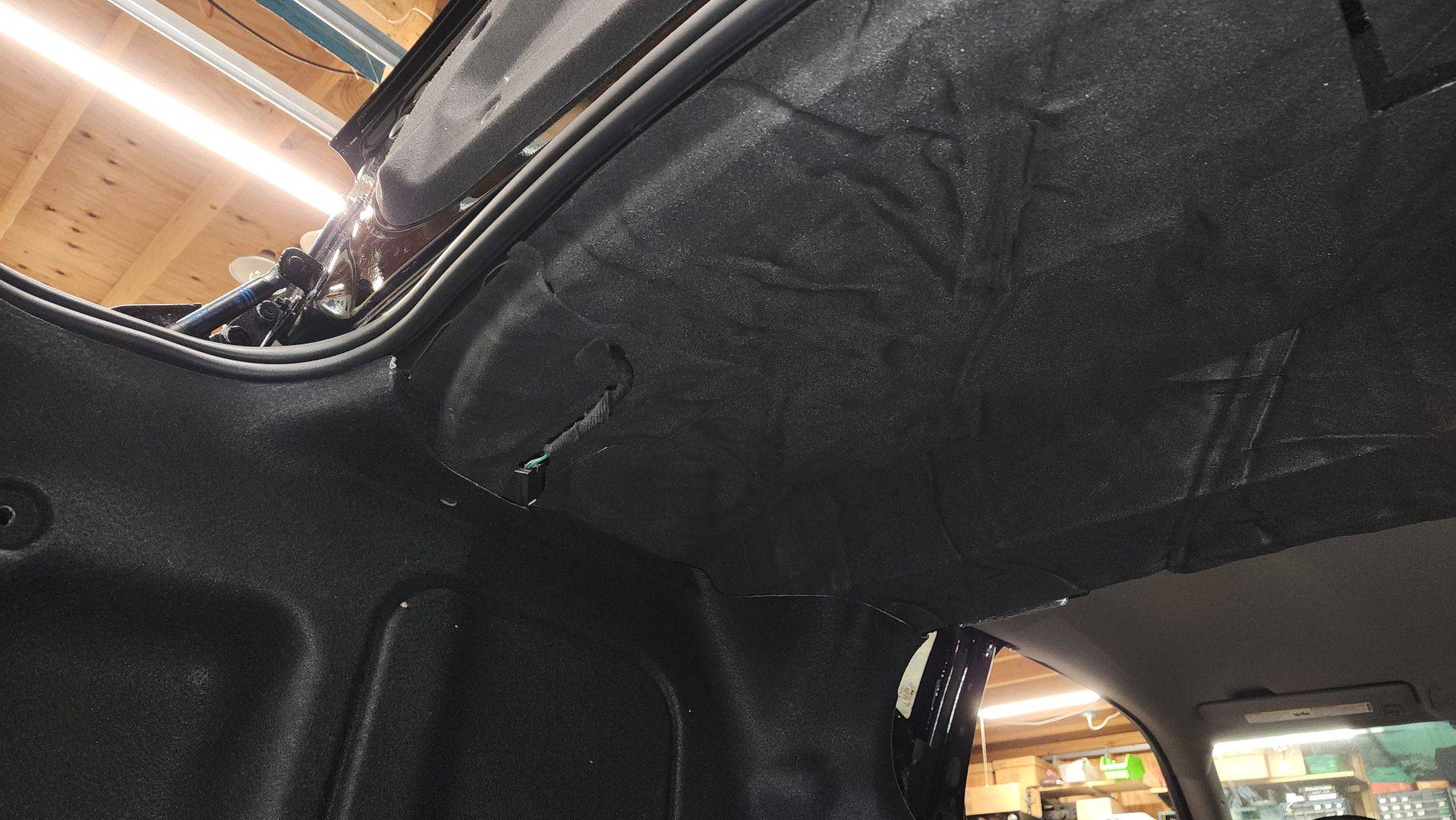

Bass in this car is interesting, it plays so low, so easily (those subs are in series for an 8 ohm load on the amp) it's different than what I've had in a long time. These doors are more well treated than any doors i've ever done, the doors are capable of response down to 30Hz with my Hertz Milles (though 40Hz was a more sane cutoff). I really want to cut the door panels to use the Alpine grills because I want more of their sound in the cabin and to bypass the waveguides in the stock door panels. The midbass in the doors is awesome and was one of my main goals with the build. Bass guitars are detailed with no holes or peaks, they sound the way we want and I attribute Guardian for their success. Guardian is better than any of the DIY solutions I've come up with in the past. Fibermat is also an awesome solution that we've needed. Our industry is plagued with a lack of sound absorption, it's a game changer.

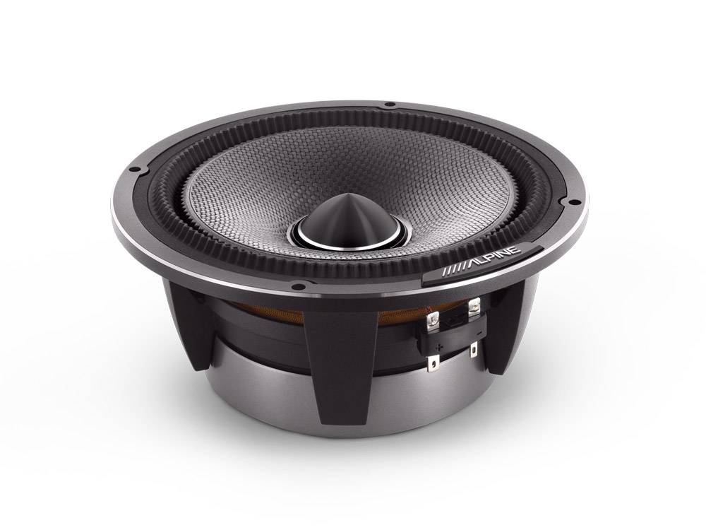

As far as the door speaker grills... can you design and print some with more acoustically transparent openings? I know you can add your own Alpine badges to them.
Alpine Badges Link
