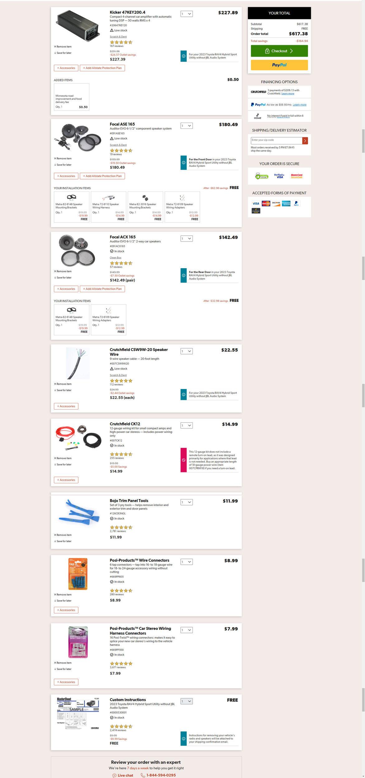

First question: I'm not interested in installing a subwoofer because space is at a premium. Here is a screenshot of a suggestion on an install I got from Crutchfield on Friday. Wondering what you think of this. About $600 is the absolute max I would want to spend on this upgrade. Total cost with extras is about $630 currently.

Here is a list of the product recommended:
Kicker 47KEY200.4 Compact 4-channel car amplifier with automatic tuning DSP — 50 watts RMS x 4 $227​
Focal ASE 165 Auditor EVO 6-1/2" component speaker system#091ASE165 Focal ASE 165 $180​
Focal ACX 165 Auditor EVO 6-1/2" 2-way car speakers#091ACX165Focal ACX 165 $142​

That appears to be a reasonable estimate for equipment. You don't have to be a rocket scientist to install car stereo equipment, but it helps to have some do it yourself skills. If you fit this skill level, go for it. Crutchfield and YouTube have some great videos on how to install car stereos. Crutchfield is also great with their support. Good luck.
I'd find a shop with those Focal's and listen to them. They aren't anything special. I think that your ears can do better with a little more research.
Kicker's key200 is pretty good. Just enough power and the autotuning works well.
Concerning sound proofing, that is for you to decide. There are builds on diyma/rav4world/reddit.... that shows some info. And, Resonix has some info/videos to watch on their website.
You might also get better pricing from other online retailers.
