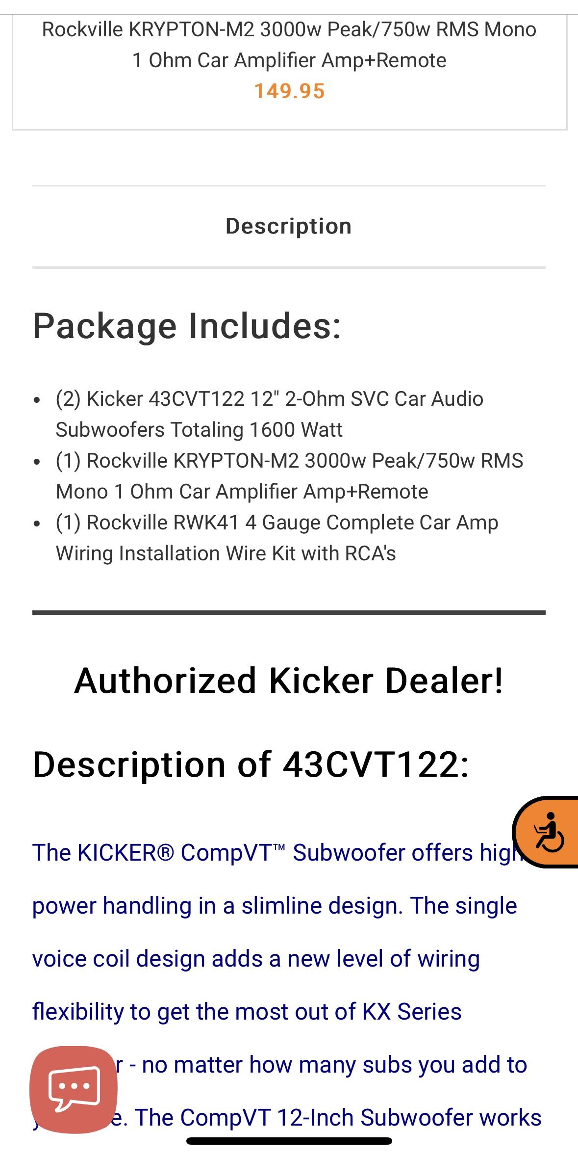

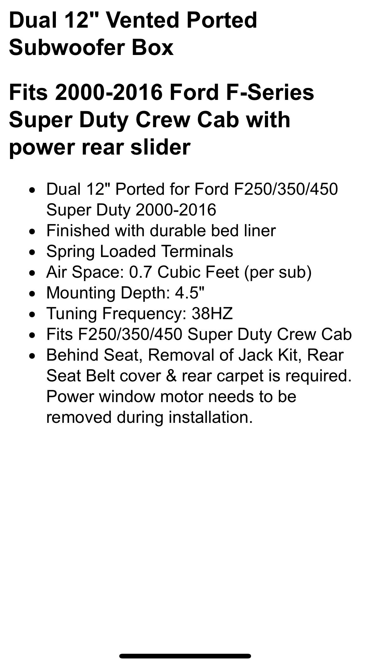

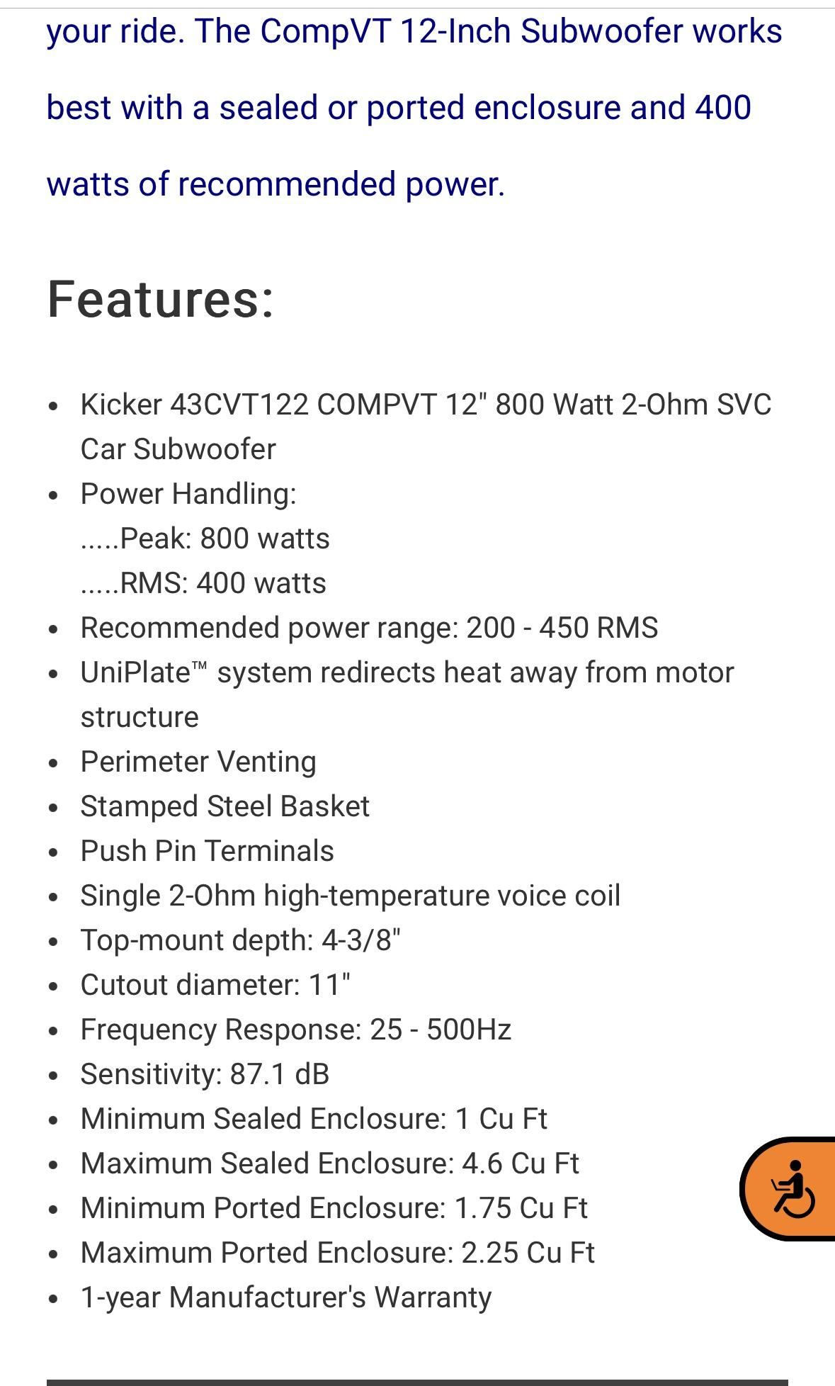

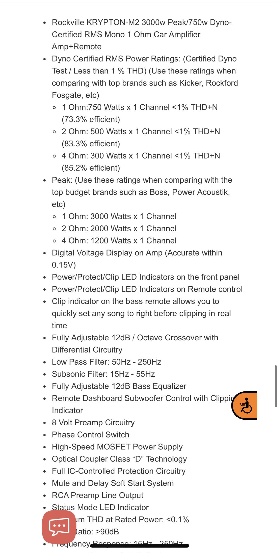

2007 f250 crew cab with a behind the seat non ported box (0.65 cubic ft of airspace). Is this a good combination?
Pioneer TS-A3000LS4​
Those pioneers are recommended at .65
And a Stinger Audio MT-1500.1 would be about right for an amp
But that little airspace is gonna hamper the low end on pretty much any 12
Ok, thank you. Would 2 8’s or 2 10’s be more suitable for this application?
