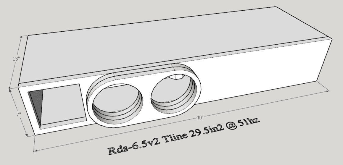

Idk but that ^^^ almost looks like a tline type footprint to me, with those dimensions maybe for a pair of 6.5's.

I haven't used Hornsrep in years and now probably can't even use the program, that said I am familiar with the design of Tlines and know a few tricks.
I'm going to see if I can render one in Sketchup that'll be punchy with good extension and output for my today project in that footprint I quoted above.

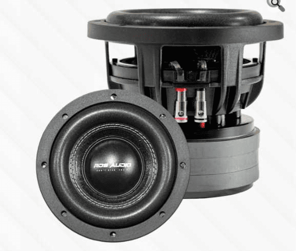

Maybe for a pair of these...
While not being "perfect" candidates for a Tline, a Tline is generally the perfect enclosure for most subs. I know how these little beasts perform at lower frequencies so clearances should be the biggest problem designing.

Without driving myself nutso relearning Hornsrep I took a stab at something that may go in the 7"h x 40"w x 13"d footprint Op listed as one of his space options. Without actually modeling it up but knowing what criteria to use or avoid I came up with this little creation. It should extend at least an octave under tuning in car and with the line area I used along with a few tricks it should be snappy with very low output limitations.
Those lil' beasts have 6.8" mounting depth so I had to adjust my thinking during designing... lol.
