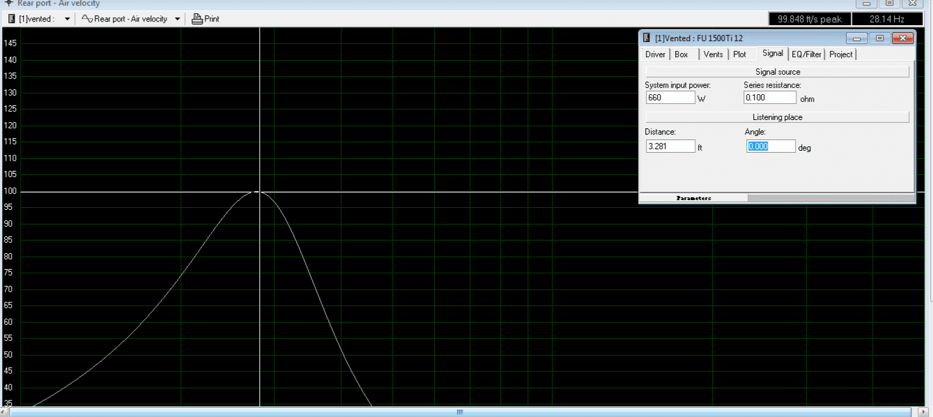

Looks like that 1st box should be ok for a 1K amp... just barely. If I got this right, 2.7ft3 minus .39ft3... that's 2.31ft3 net with a 2 x 12.5 port and the port wall (inside bend) is what 24"?.. Quick and dirty in Torres that's around 26" long... if you get 660 watts to the sub it'll be at 100fps at that point. So yeah... for 1K on that sub it looks like it might be alright and the tune will be close.
IMO you'll probably be ok... but that sub man... you are just tickling it. Why get a fairly expensive sub and underpower the h*ll out of it?
