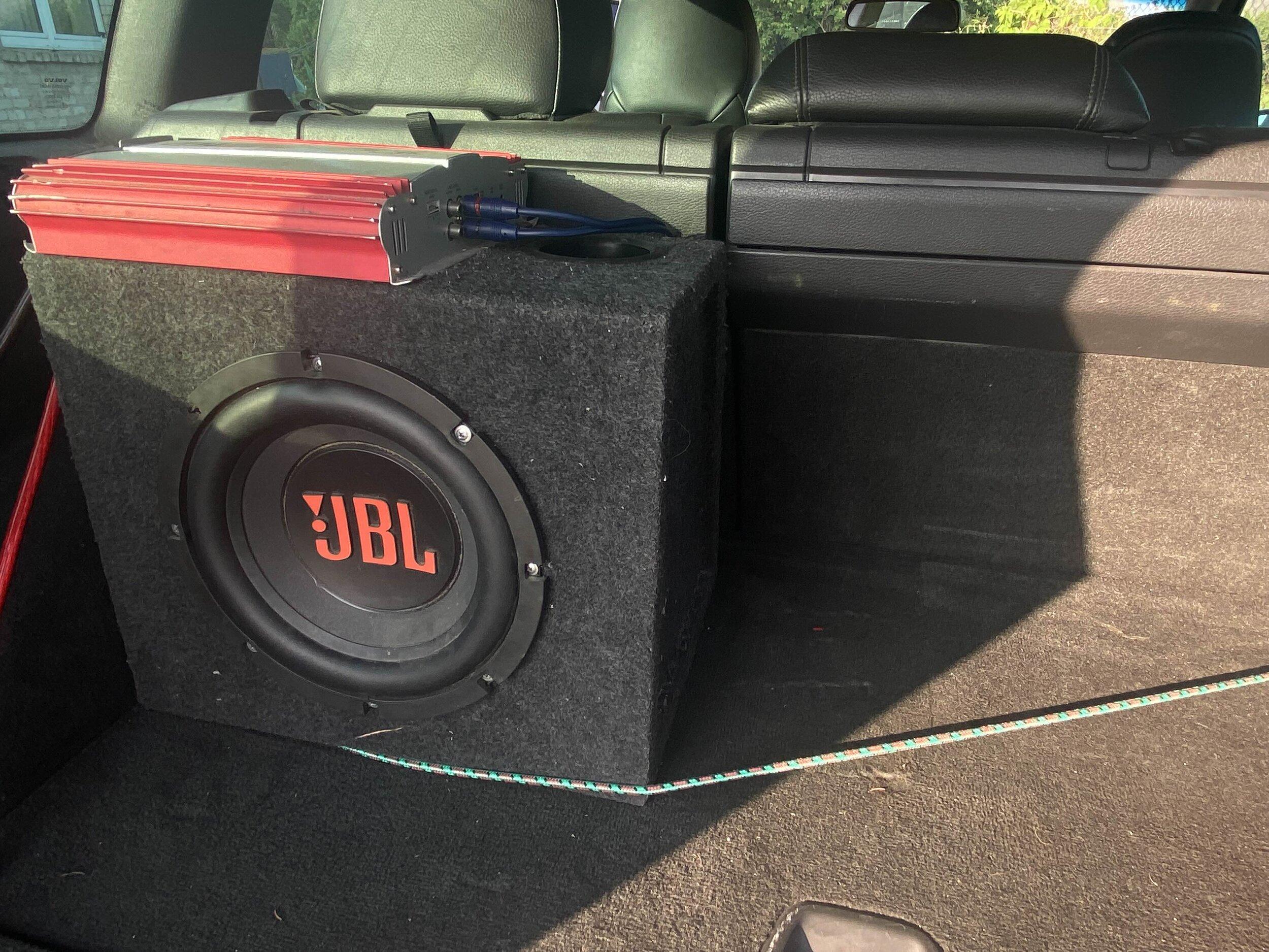

Sorry, I dont really know the specs or dimensions of the box, it is ported though, ill attach a photo here for estimation, i can measure it if that helps?
Sorry, I dont really know the specs or dimensions of the box, it is ported though, ill attach a photo here for estimation, i can measure it if that helps17View attachment 65945
A very rough guess would put the externals on that box at 20x20x6, which is 2400 cubic inches. A cubic foot is 1728, so your box (minus the woofer) is about 1.2 cubic feet.
Get measurements if you can, but I'd say the box is WAY small if the specs on that woofer are correct.

Sounds like a peaky enclosure tuned around 45hz. First thing I'd try is moving the sub as far to the rear as possible. It should be rear firing. That will reduce cancelation to a minimum.
If that doesn't help, then I try building a new enclosure. It's guesswork without TS specs. If you don't have TS specs, then I'd go for ~1.25cuft net tuned to ~35hz.

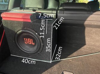

Alright, since the back is slanted I found it easier to show it in a photo lol hope this is okay
port is round, 7.5cm wide 11.5cm long
Assuming the wood is 1.25cm thick, and the driver takes up 10% of the box volume, you are right at about 31,000 cc for that box. If those #s are accurte, the port tuning would be dang close to what Jimi said, at around 50Hz.
You could experiment with lengthening the port (to 20cm for 40Hz tuning), but don't expect miracualous changes.
So, it doesn't seem like the box and port are off the mark.
Let's talk about the rest of the system setup. Jimi already mentioned experiemtning with box placement. Tell us about your head unit, the amp settings, how it's connected to the system, etc.
