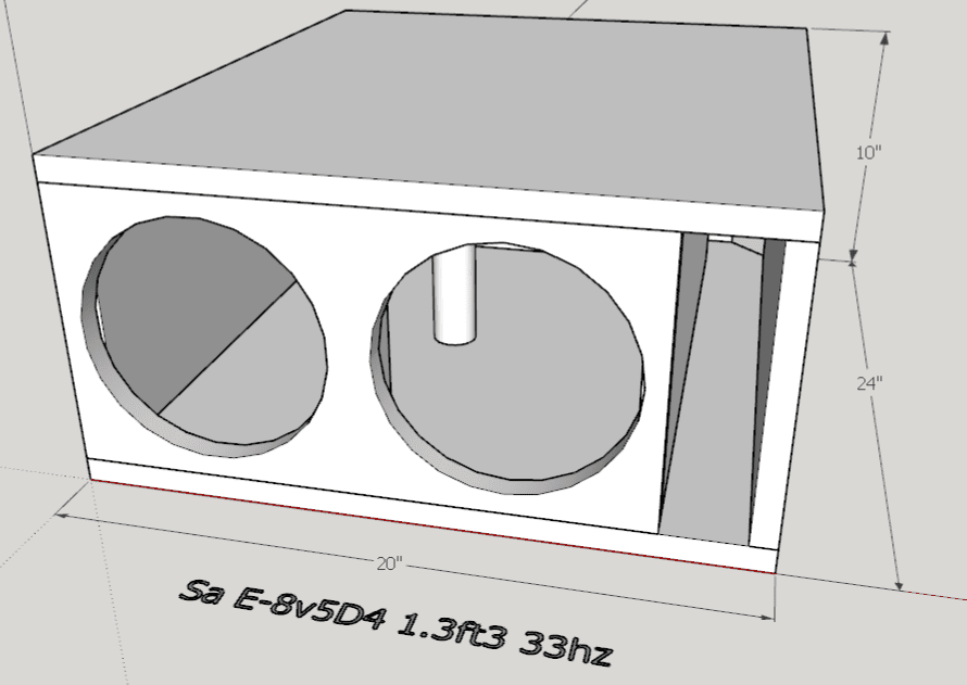

Currently I have a place about 20" wide, 24" deep, and 10" under the sofa. Or a pocket on each side that is 11h,11w, and 14d.
Would probably do well with a pair of solid 8s.

That under sofa space works out well for this...
Decent lil' subs too... and not too power hungry but will take some power (
them sundown coils). Looks like a set of 8's is how I'd do it in that space.
Is this box completely open to both subs or divided into 2 chambers? Don't think I've ever seen multiple drivers pushing a single port. Then again I'm definitely not very knowledgeable in this area.
Who could build this for me?
Is this box completely open to both subs or divided into 2 chambers? Don't think I've ever seen multiple drivers pushing a single port. Then again I'm definitely not very knowledgeable in this area. Who could build this for me?
Single chamber, single port... why not DIY it?.. it can be done under $100 with tools I think. That is ported for a lot of power... around a 800-900 watt amp IIRC to get to rated power in that box. But seriously... the BEST option is to give up some space if you can and go with a Tline like others have said... That ported box will do ok tho... probably not blow you away tho in semi cabin with a sleeper.
