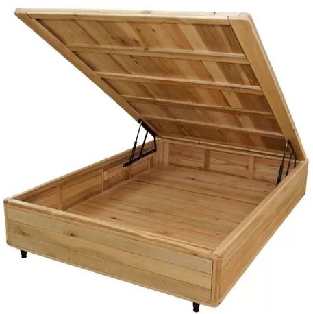

Option A) A simple "trunk bed" system:

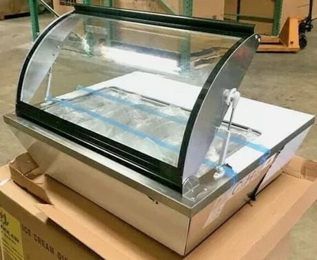

Option D) A rounded small class lid that opens up:
(in reality, the curved glass in the above image is not openable, but you can imagine it opening up like in the previous image)

Option A seems to be the easiest one to build. Because I can easily buy a ready kit with that metallic joint and the piston used to lift the lid:
I actually sleep in a bed that is just like the one in that picture.

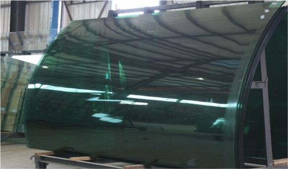

However, all of the 3 ideas have the same challenge, which is to avoid vibration (resonance) and air leakage. In that sense, option D seems to be the most promising one. Because the curved glass is much better in holding resonance than the flat wood. Also, it allows me to create a box that goes up to the car's roof. And if another piece of glass is added on the back of the box, then I might still be able to use the car's rearview mirror. Just need to keep those glasses clean. And the curved glass is kind of easy to buy as well:

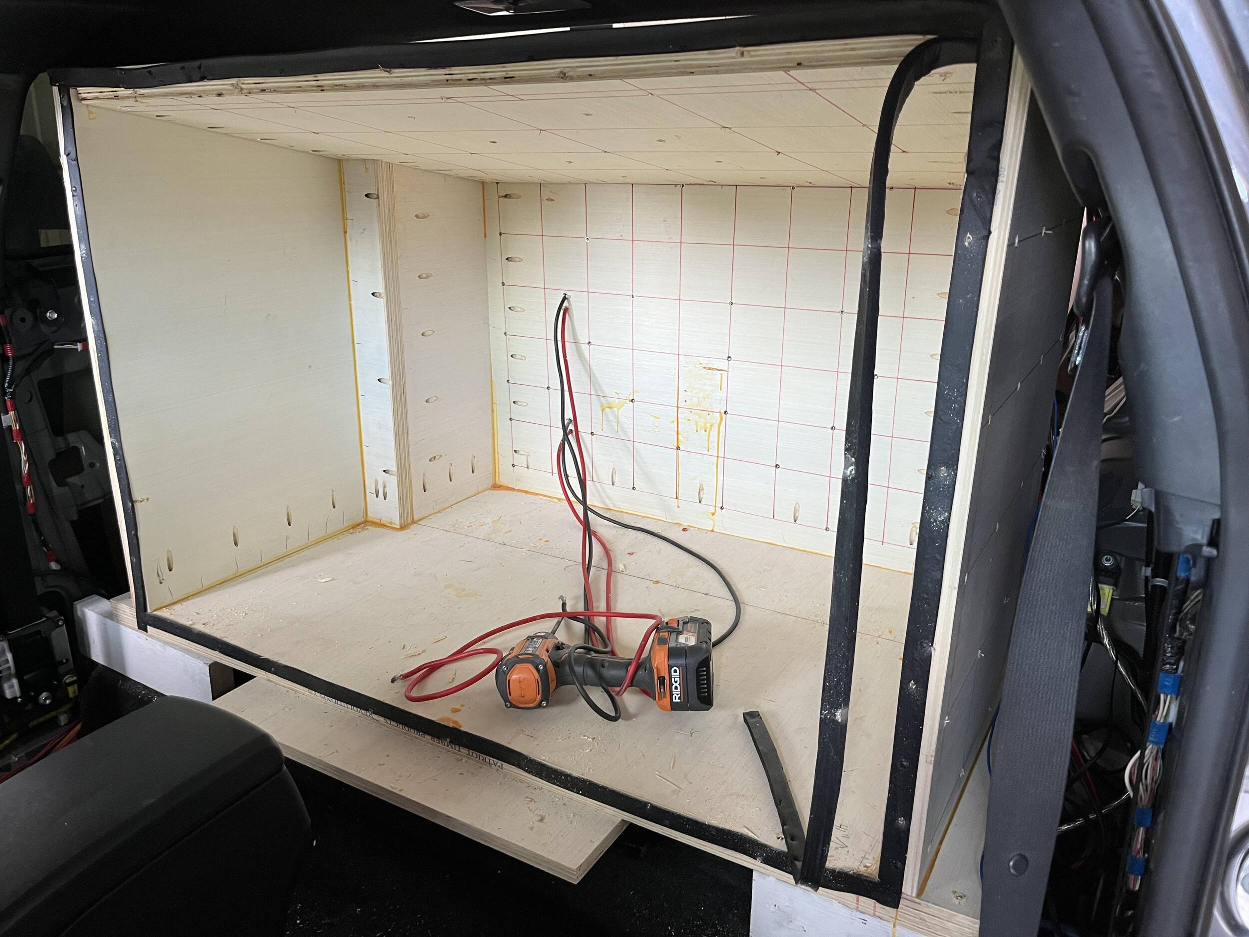

Removed my 2 18 baffle for a 4 12 baffle while keeping the shell intact.

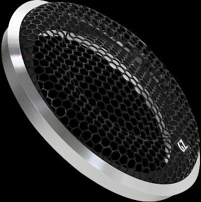

Isn't that problem resolved by using a good subwoofer grill like the one below?

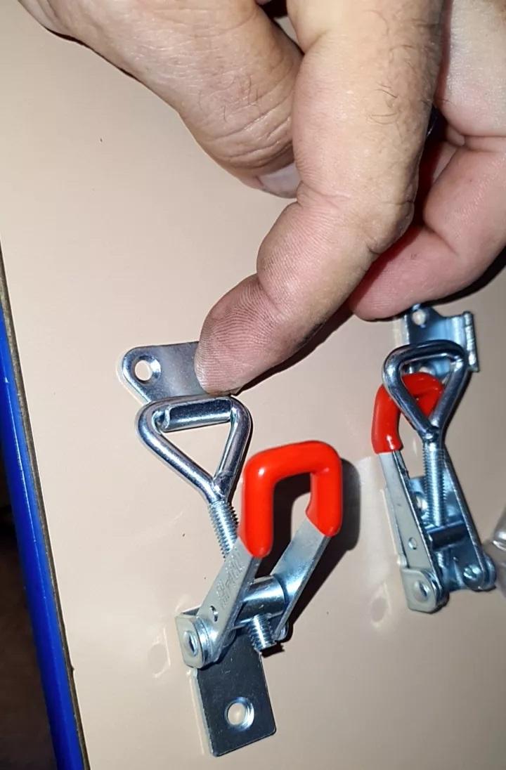

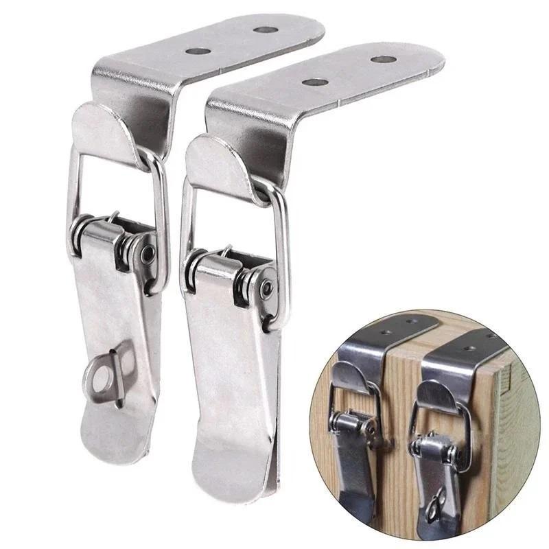

Do you think a few latches similar to the one below can accomplish that?
Do you think it is an impossible task or just a difficult technical challenge?

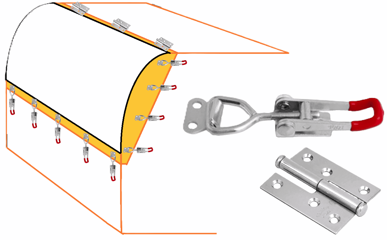

I have found those 90-degree latches that look good for a flat lid:
However, I think the ones below, are more appropriate for a lid with curved glass:
Because those are stronger, easily adjustable, and work on a flat surface, which would be the case:

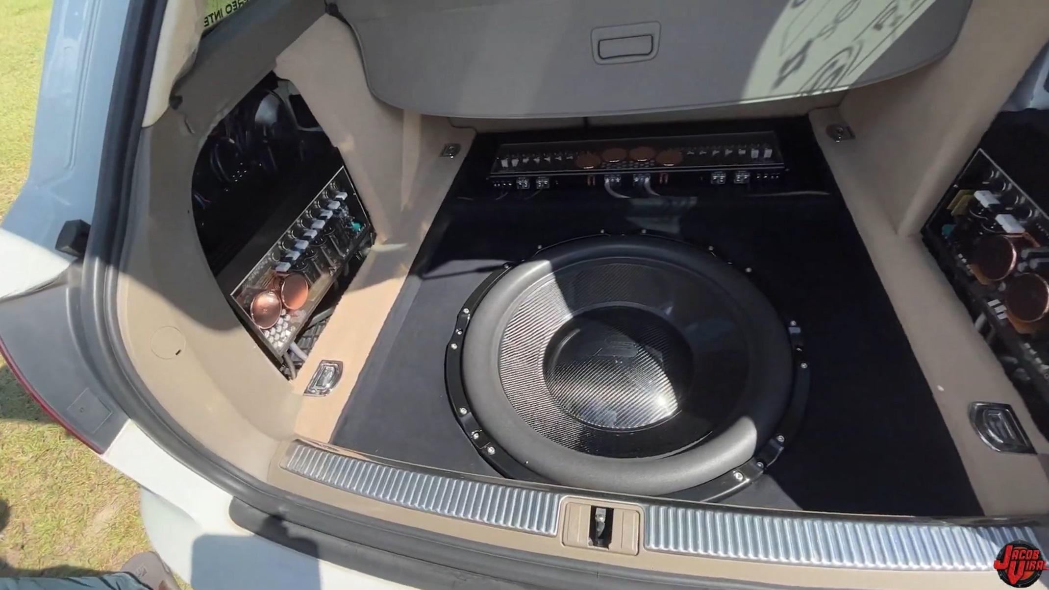

Most infinite baffles vent into the trunk. I wouldn't feel comfortable with the motor exposed like that.
Yes. Unfortunately, people care too much about the looks. I guess that's why they installed it that way. They said it will get a grill down there but I doubt it will hold the impact of a speed bump.

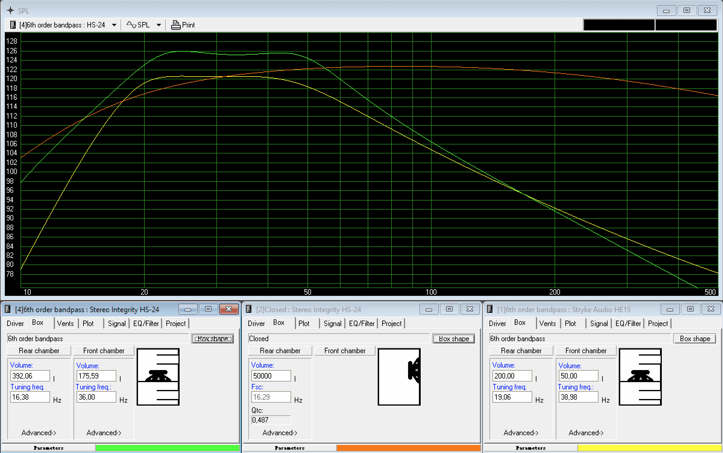

Or did you mean that IB systems can hit 20 Hz more easily? Well, for me the chart below proves otherwise.
  • Green line: HS-24 at 3000w in a 500 L enclosure with BP6 with 620 L (taking the ports into account)
  • Orange line: HS-24 at 3000w in IB setup (simulated with a 50k liters box)
  • Yellow line: the He15 driver I have at 2000w and using a total of 330 L (taking the ports into account)
All three designs required a high-pass at 15 Hz to avoid damage from excessive cone excursion; using 2nd order for IB and 4th order for BP6. In WinISD, placing the HS-24 in a 500-liter box produces the same result as 5k L (IB simulation). Actually, the 500 L box is slightly better, and without the need for a high-pass filter.
For me, the conclusion remains the same: BP6 always takes much more bass from whatever subwoofer. It works best for drivers with low Q, but the high Q drivers also speak louder in BP6.
