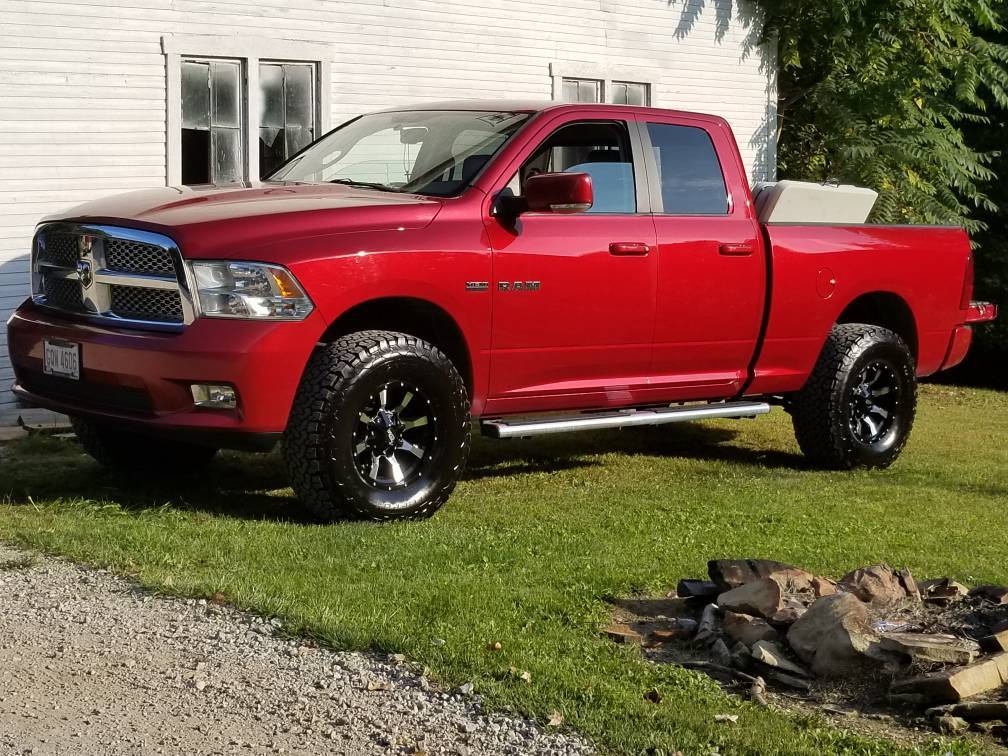

Here is an outside pic if my daily.

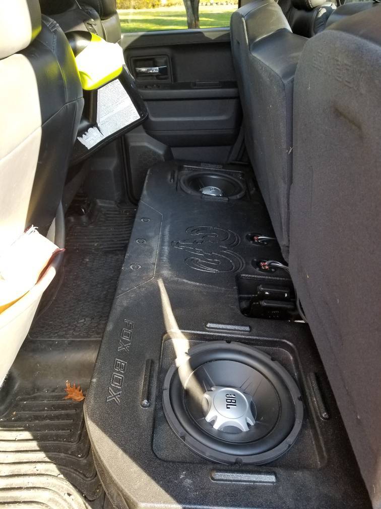

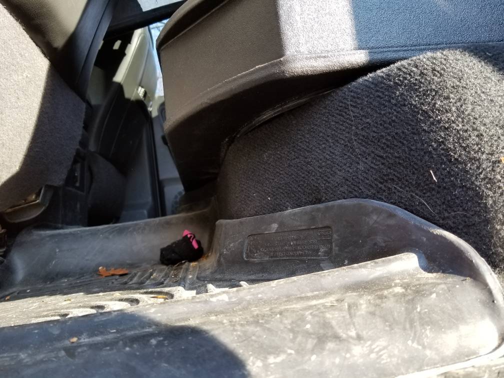

Here is the work truck box. You lose the cup holders. It could be a bit more "refined" but hard to beat for the price and proven. It comes with spacers for the seat I believe. It has been a while.

That's awesome yo! I think I'm definitely going to go with that Fox Box. I don't really feel like spending the time fiberglassing a custom box myself nowadays. It's going to be enough work for me to just deaden the cab lol.

i'm not a truck guy but man thats a good looking one.. even i would drive that lol..
