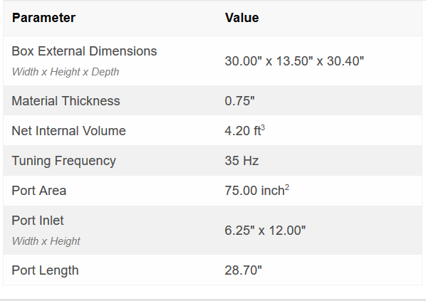

I have a Fi SSD 15 (1500RMS) and a Taramps MD3000.1
I designed this box for highest SPL in the 34-39 range. Would you change anything? I am specifically wondering about port area and length. It's 5.72 gross cuft. Port displacement is 1.35 cuft.

Personally I'd ditch the slot and go with a properly sized adjustable aero, tuning 4-6hz under wherever your cabin peaks for Spl. Then Test... Test to find what gives best output. Configure it for your vehicle and also bear in mind power when sizing the enclosure if your shooting for #'s.
If you want it to peak lower than that cabin peak you'll lose output but gain extension the lower you tune (lower peak, more lows). My Bl-18 loved 40hz or so and peaked 47hz in my small Suv.
What vehicle?
Goals?.. SPL or daily loud and low?
Some people think loud and low is Spl whereas #'s usually require a higher tuning IME.

I've used that driver and the ported box is closer to about 2 cubes. We did 1 in a stuffed/sealed 1-1.25 cubic foot box, stuffed with 1 lb of...
