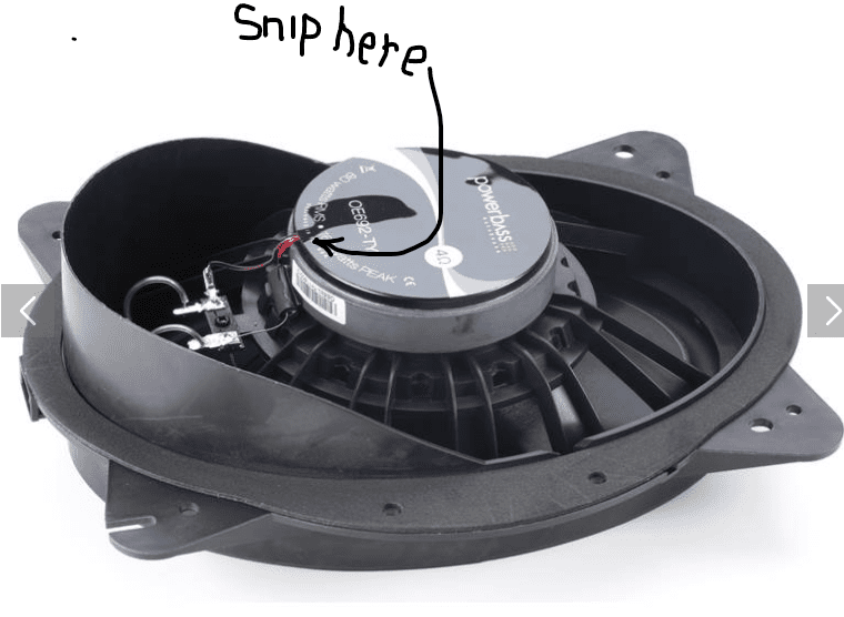

Coaxial option (requires that you splice into or seperate the tweeter wires already on the speaker and feed the tweeter leads from the car to their respective inputs on the back of the coaxials. This also means that you will ignore the dash mounted speakers an only use it's speaker wire (lead) fro the tweeter on the coaxial driver.
Crutchfield has these the front and the rears, all you have to do is remove the leads going to the tweeter, bypass the cap and run the Camry tweeter leads to these wires, the bass wires to the bass driver.
You can tape off the leads and ignore the cap and wire, they will no longer be needed and can just sit there.

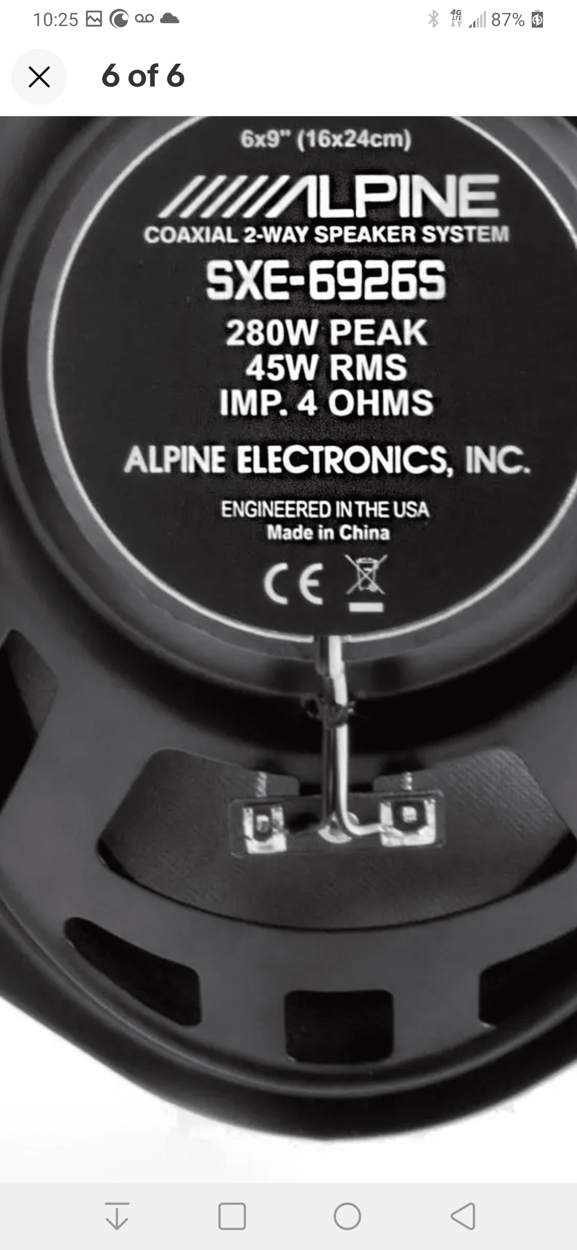

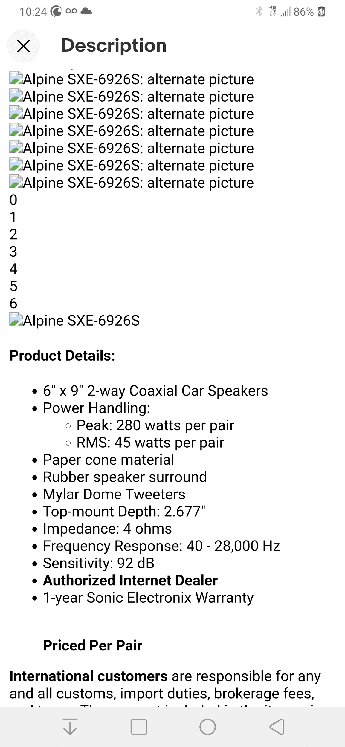

My question still regarding the Alpine SPE-6090 that the blog post uses is that they are rated at 4 ohm. Because this is a coaxial speaker with 2 components, does that mean each speaker is rated 4 ohm, or because I need to split them up will they each be less resistance?
I really don't fully trust any of these folks because they all recommend 4 ohm speakers, but don't really warn that you are going to have volume issues with them. Any comments which attempt to address that issue appear to go unanswered.
So I am NOT concerned that 4 ohm speakers won't work, because I am confident the crossover is done in the amp based upon other things I read. But I am concerned that 4 ohms speakers will cut down on my volume. I don't blast my stereo, but as I can't really know what the drop will be, I am concerned to risk it.
