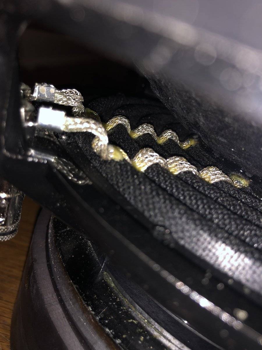

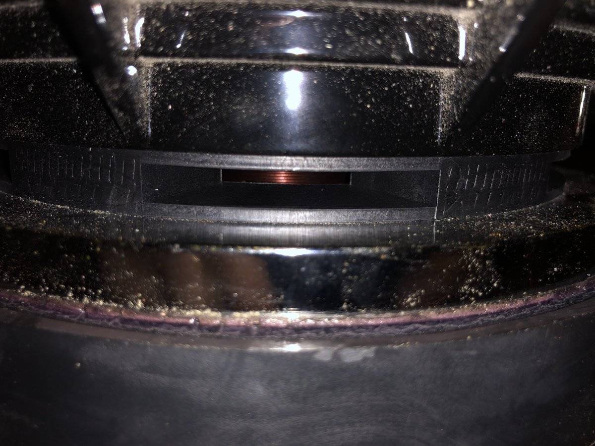

it’s ps4 away but it’s still throwing a fit. Seriously though just got out of box. Was a little dusty in the box but not bad. Pushed cone down and there was no rubbing. Tensel leads, spider, terminals and coil from what I can see are all good. Not really sure why it’s doing this. Don’t think it’s the amp because of the way it almost seems to seize up and quit looking. Added some photos if those might help.

hmmmm, it looks fine, but of course we cant see behind the spider, and i guess there could be a bad winding on the former too

I’m thinking that’s what happened. From being overpowered and having it for few years I think the coil finally got too hot and there’s a bubble in it now. Going to just recone it and hope that fixes the problem
