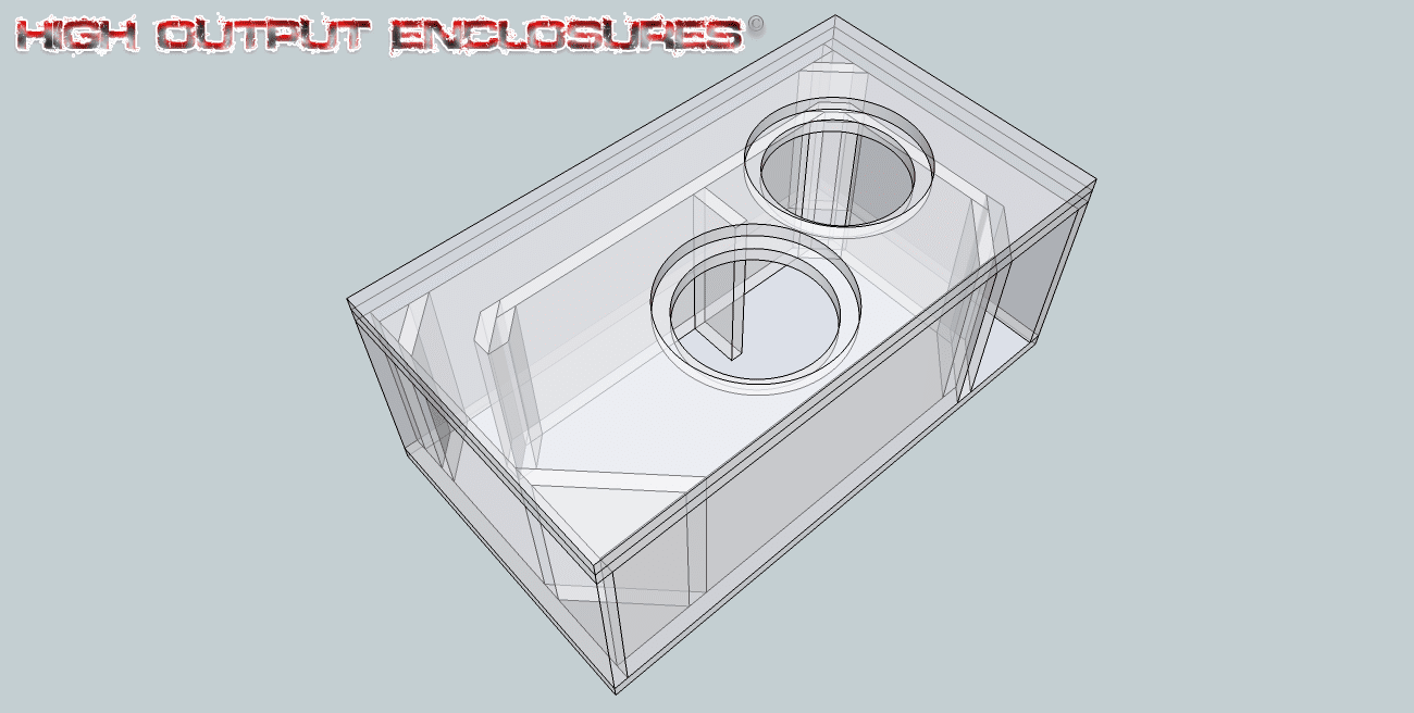

My first sa-8 box design from 2011:
28645

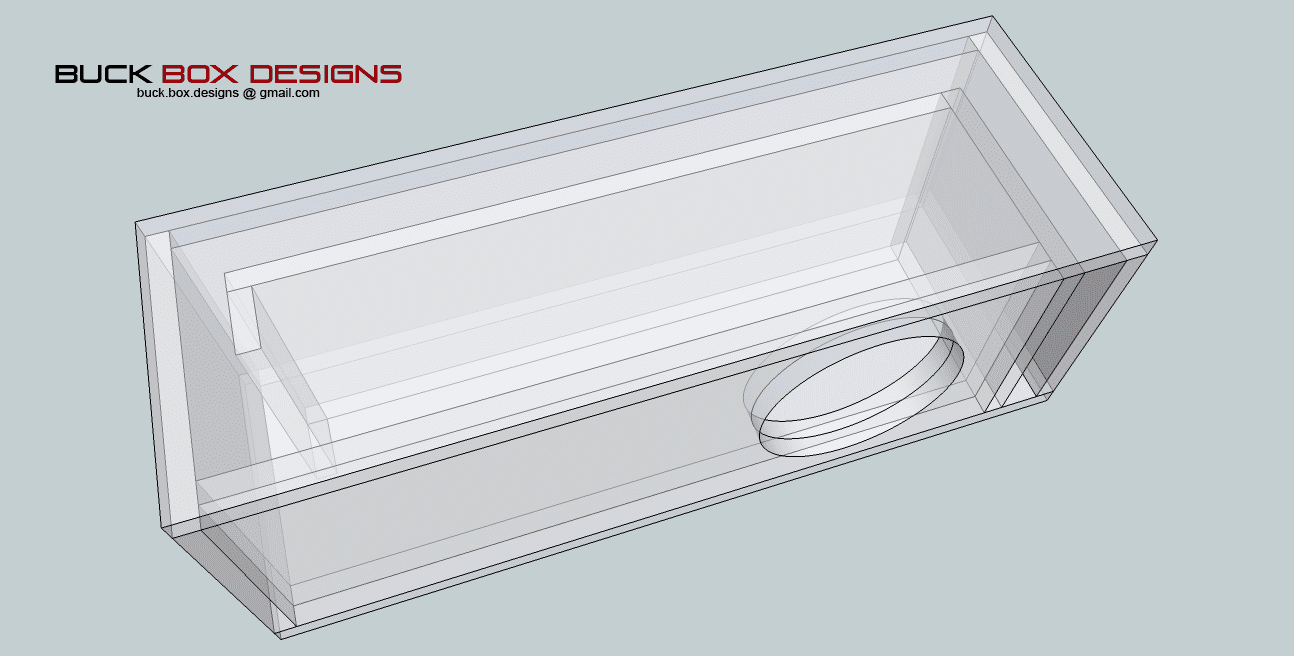

2012:
28646

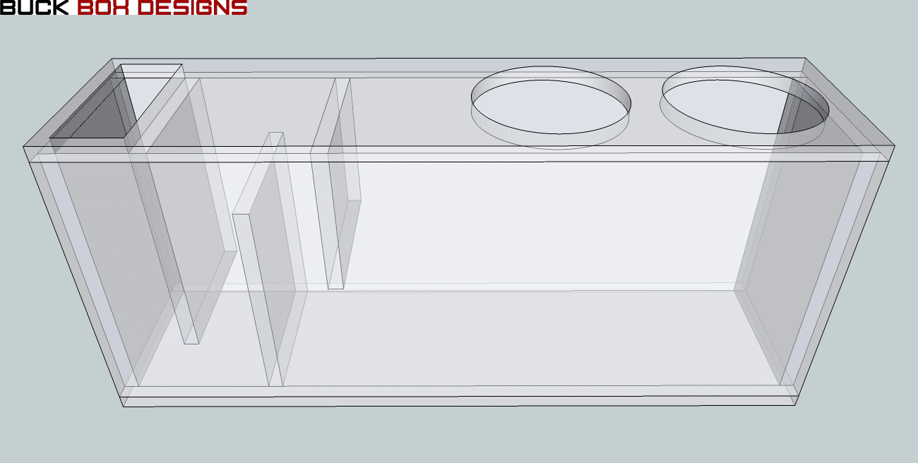

2013:
28647

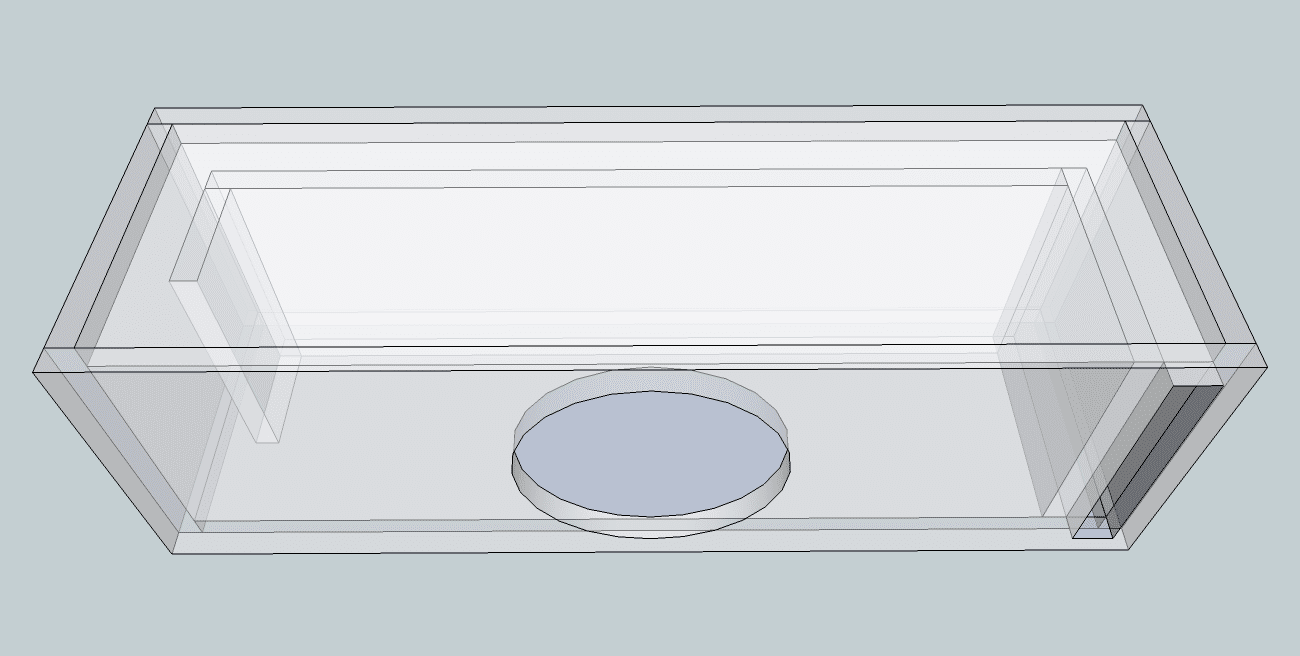

2014:
28648

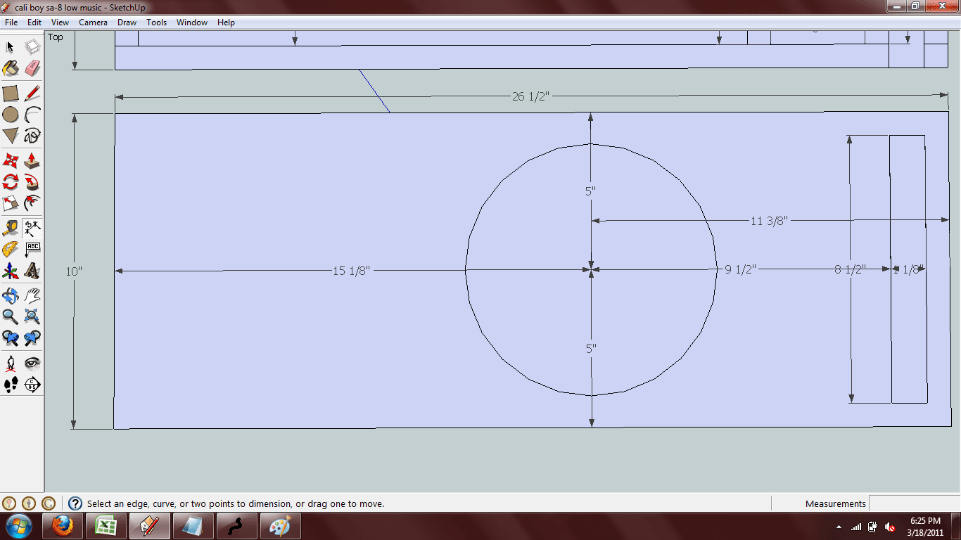

Was sick in 2015 so 2016:
28649

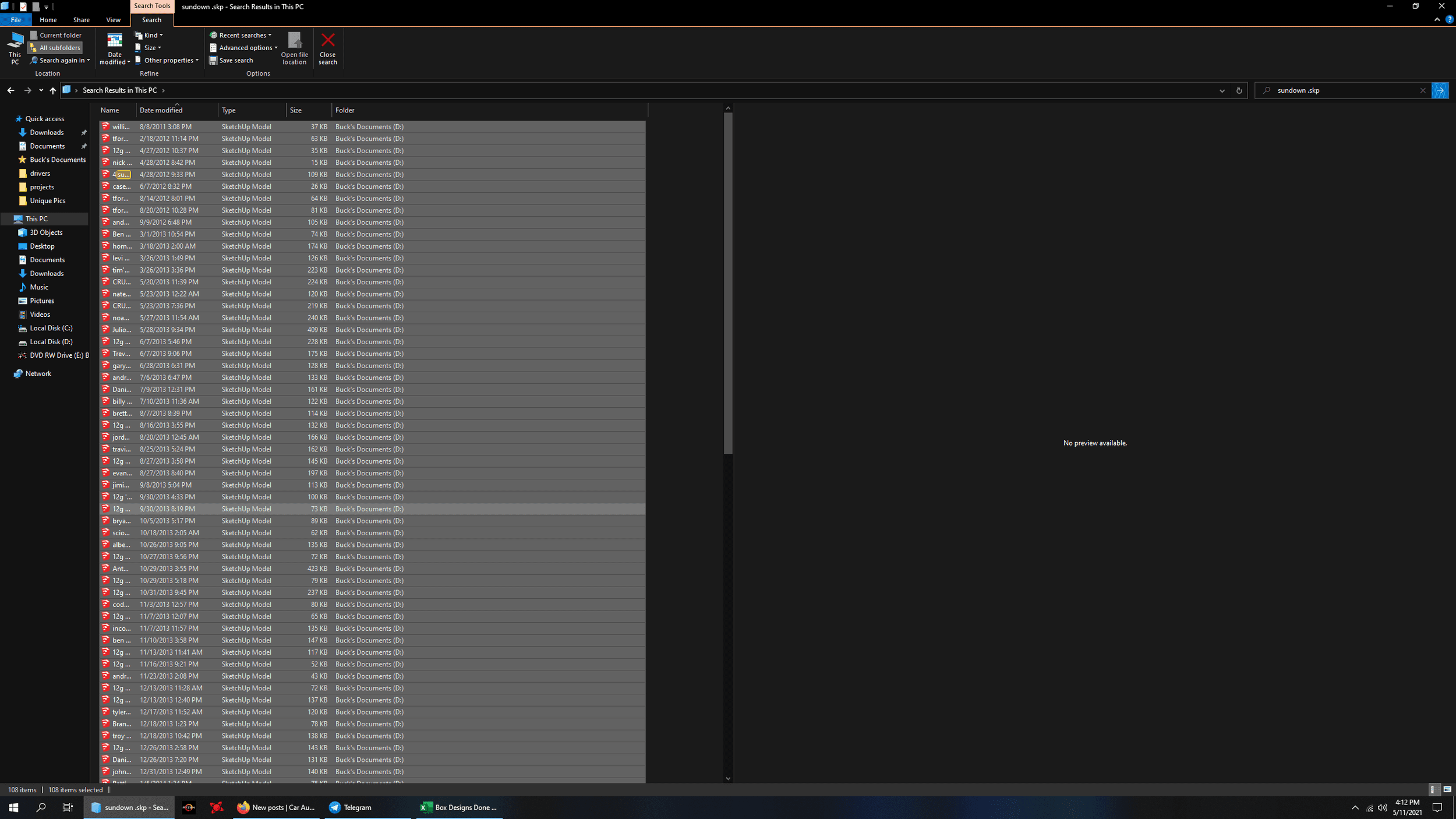

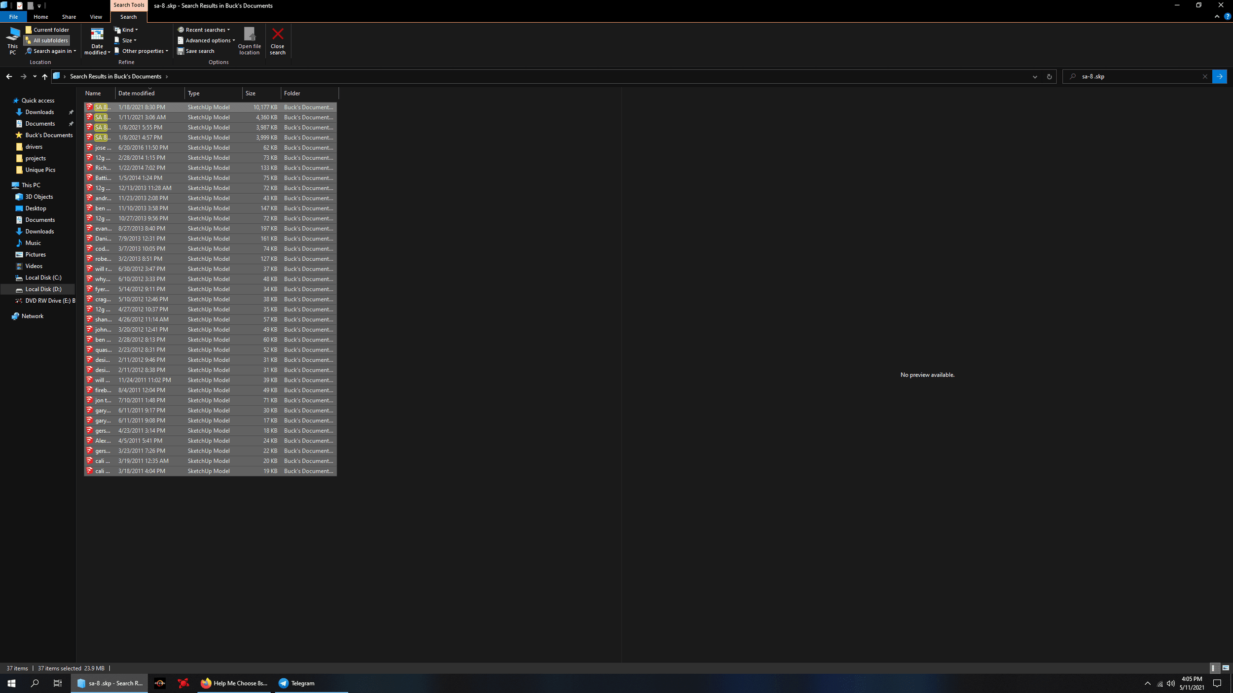

I have more but some I can't show due to business agreements. I have 37 sa-8 designs saved on my computer.
I worked for/with a Sundown dealer. I've designed, built and then installed many Sundown sub boxes myself, in real life. Please trust me on that.
