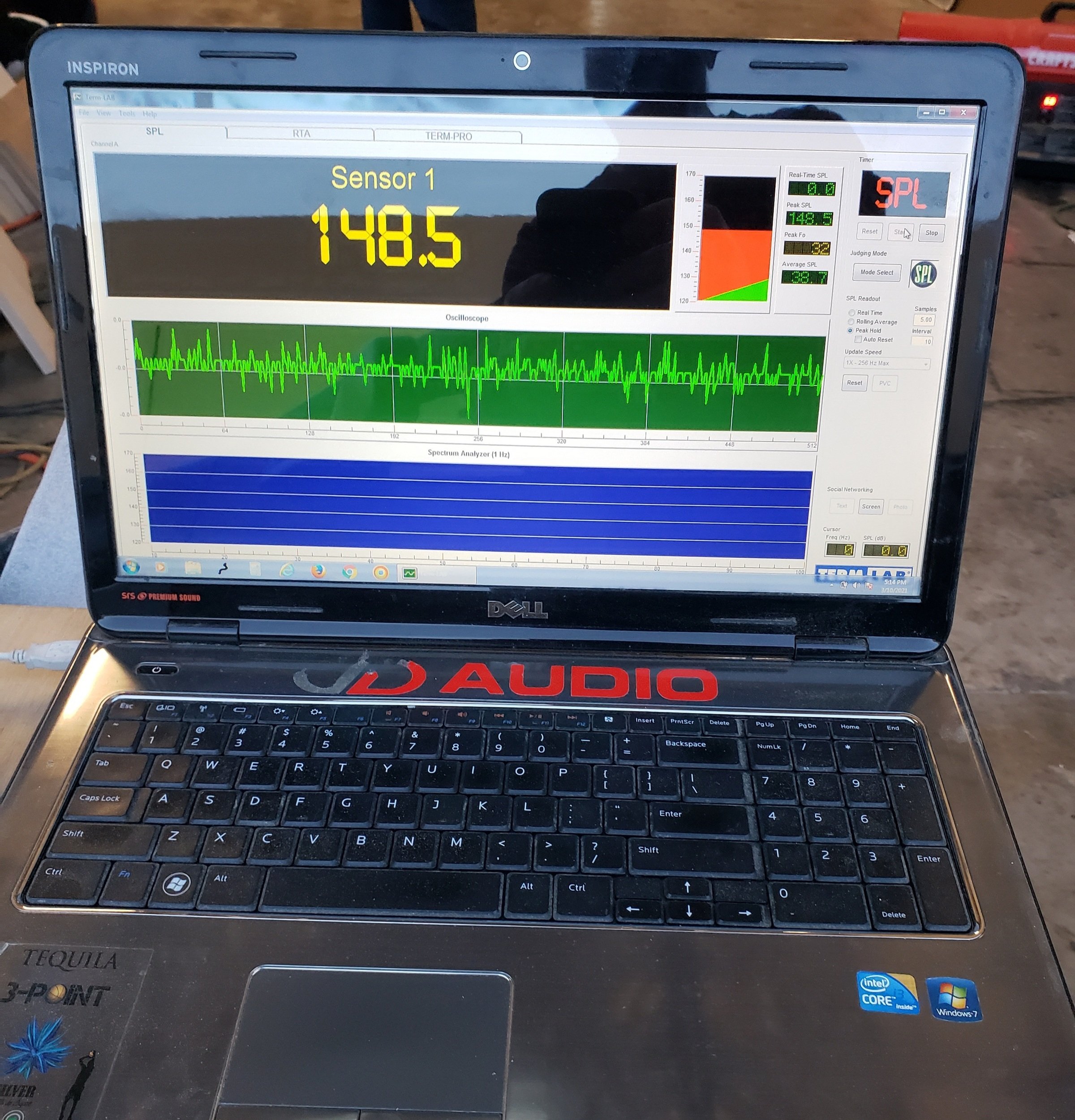

My current 8's seem to play pretty low, but nobody even talks about them. They did a 148.5 @ 32 hz. Are people wanting 8's to play lower than that? The VFL's didn't even make his list. Those F8l 8's look pretty nice to me.

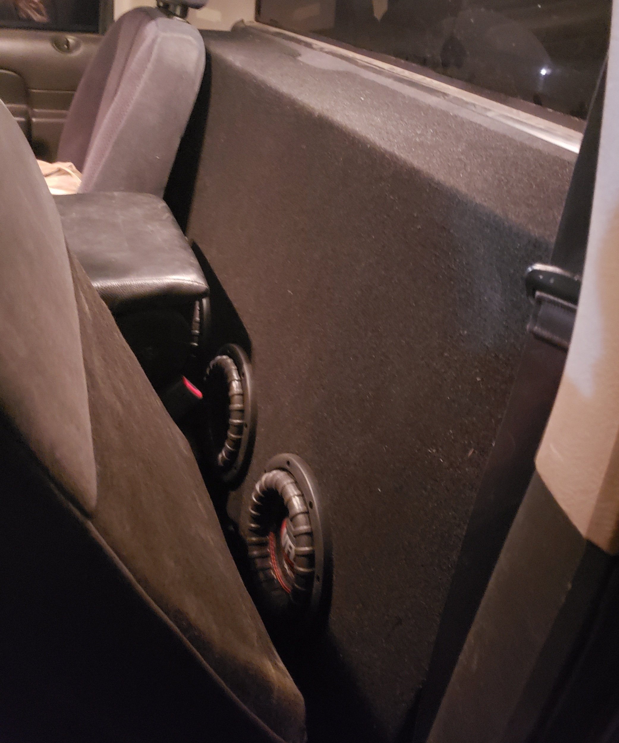

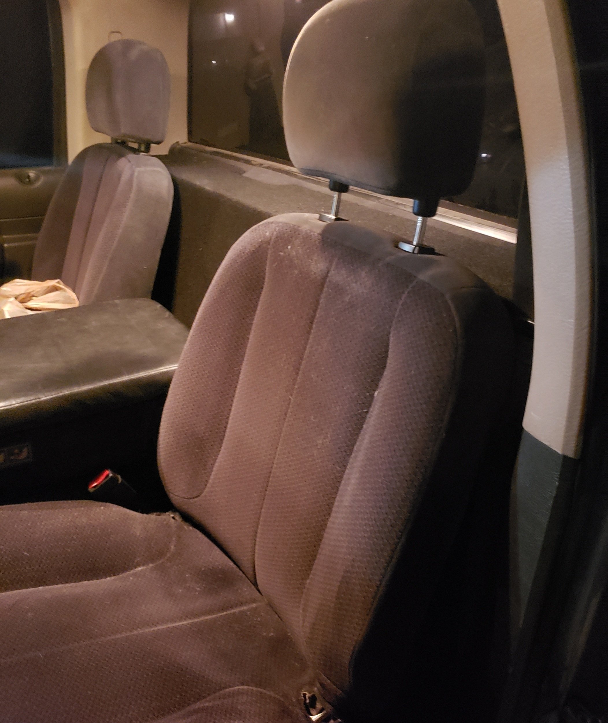

I'm currently running 4- VFL 8's on a Sundown SFB3K. The box is 4.1 cubes net after sub and port displacement tuned to 33 hz. It's behind the seat of my Dodge truck. Here's a couple of pics.
