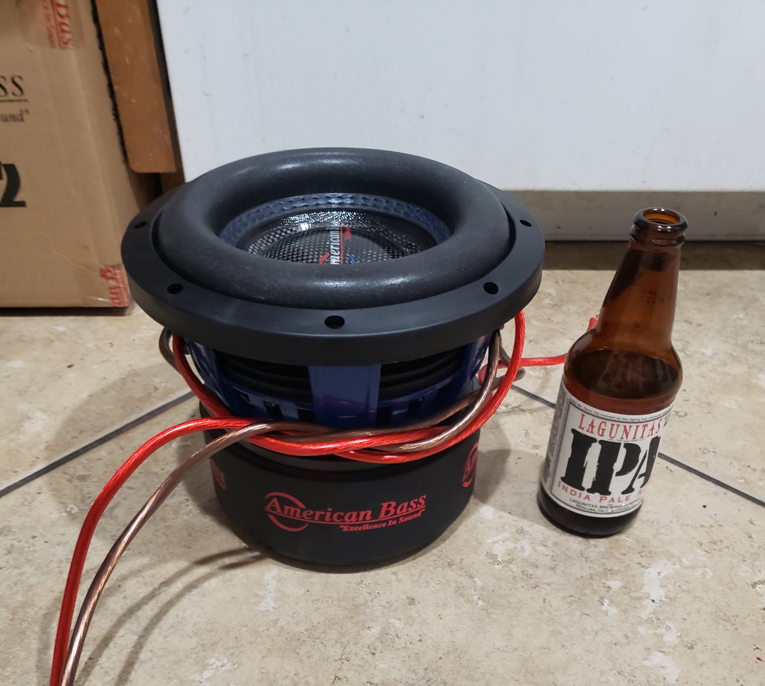

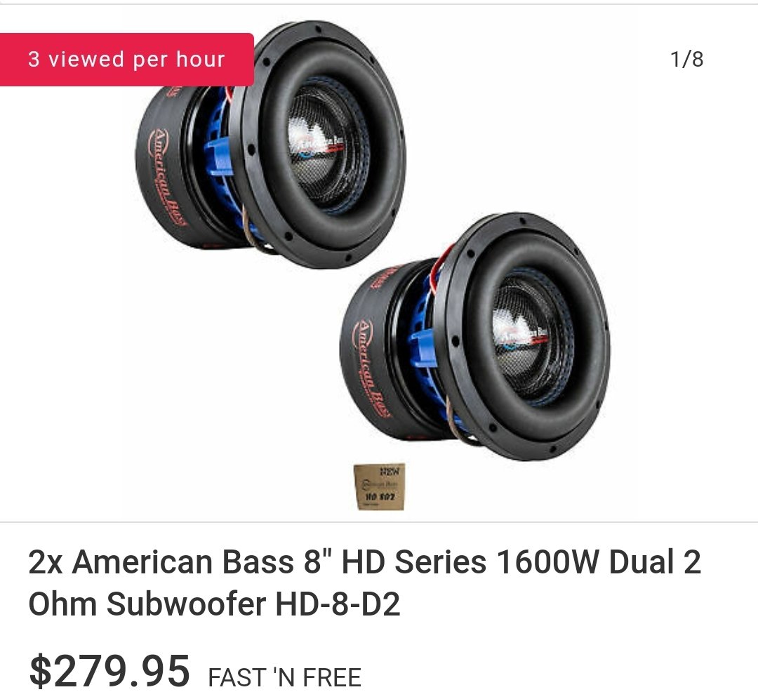

The bottom line is that you will have to hear the subs in person to judge. You might think the zvx is killing the sa8 and wonder why people on the forum told you otherwise. I will chime in on not liking the sound of the L7s, but some people think it sounds good. I would pick the lower priced 8 with a 2.5" voice coil if you don't have much experience with 8s. Most people are going to recommend the more expensive stuff, but you probably couldn't tell the difference between the sa and evl? The best bang for the buck is going to be the Blue basket American Bass Hd.

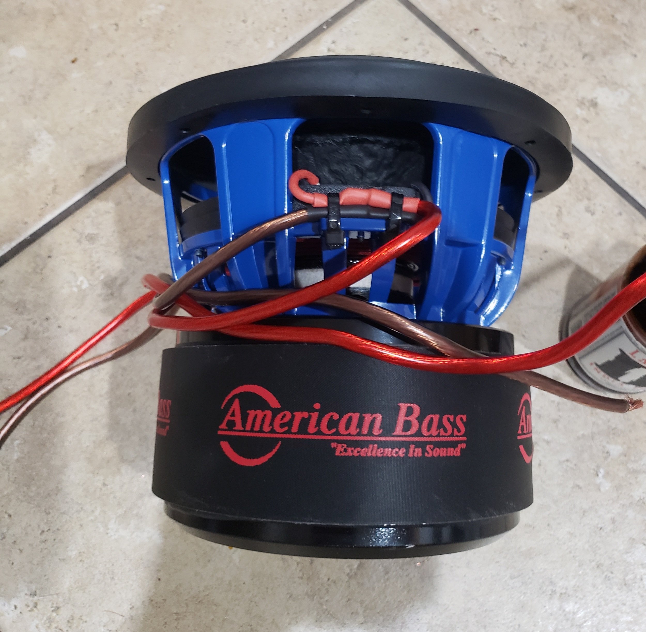

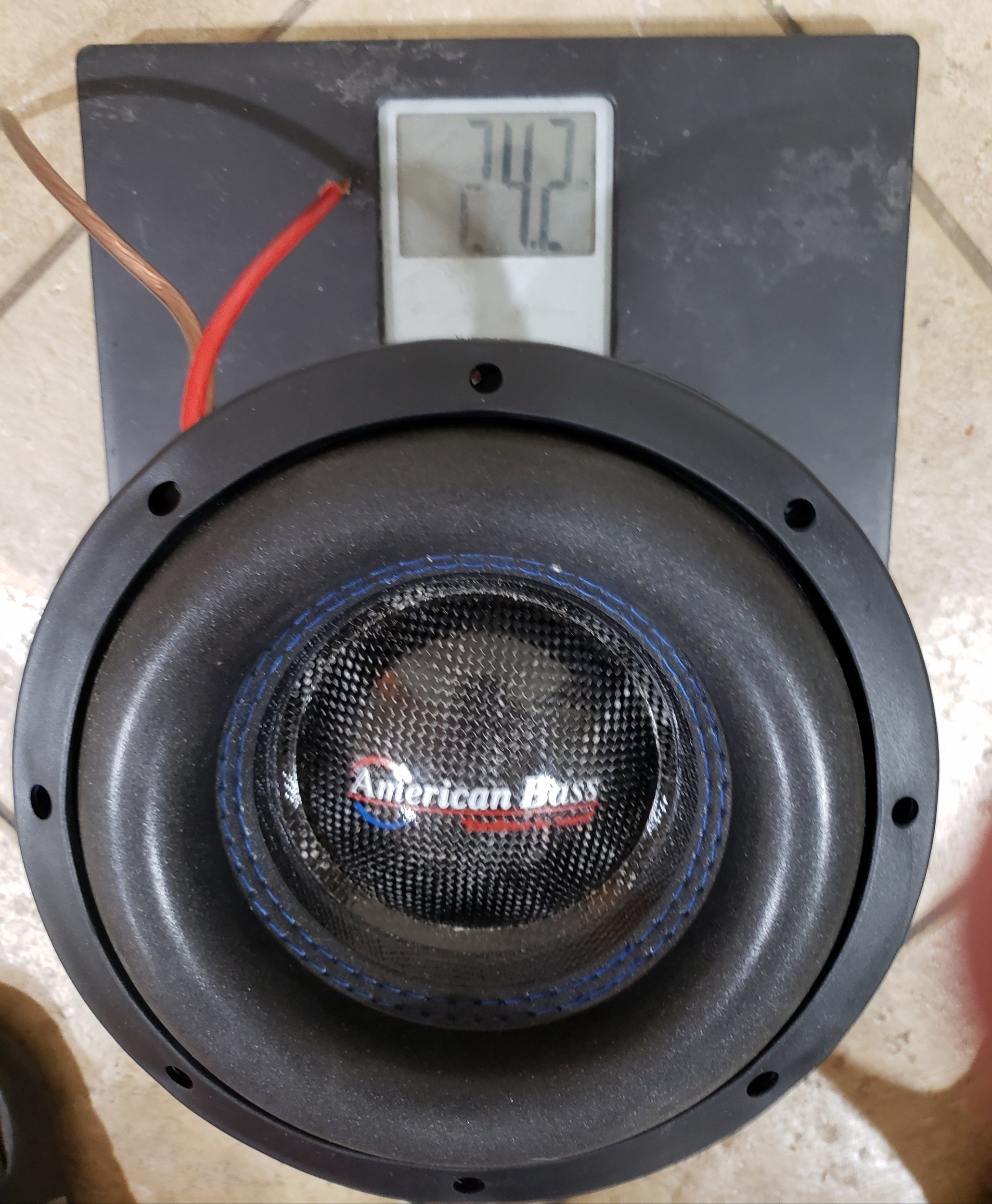

It's for a 2020 Jeep Wrangler Unlimited. Looking for big bang in a small space.
I'm getting ready to install two of these 8's.
