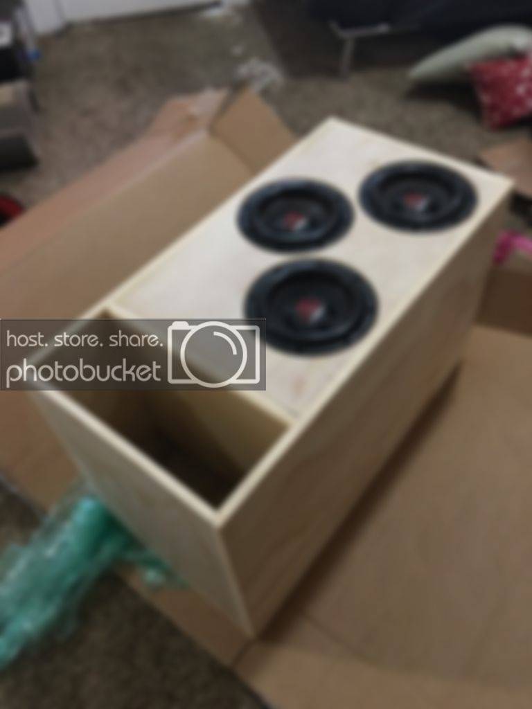

This thing is artwork.
I had initially planned on building a vanity panel and wrapping in black leather, either that or smoothing the box and painting gloss black to match the outside of the car. however, after seeing how nice the wood of the box really looks I am seriously thinking about sanding, and staining to match the dark grey burlwood accents in the interior of the car. What does everyone think for finish??
Ya he is truly an artist with plywood isn't he ! That thing looks awesome. I want to something like that in my truck if I could ever shake the SPL bug. And when I do I will definitely be calling him !
