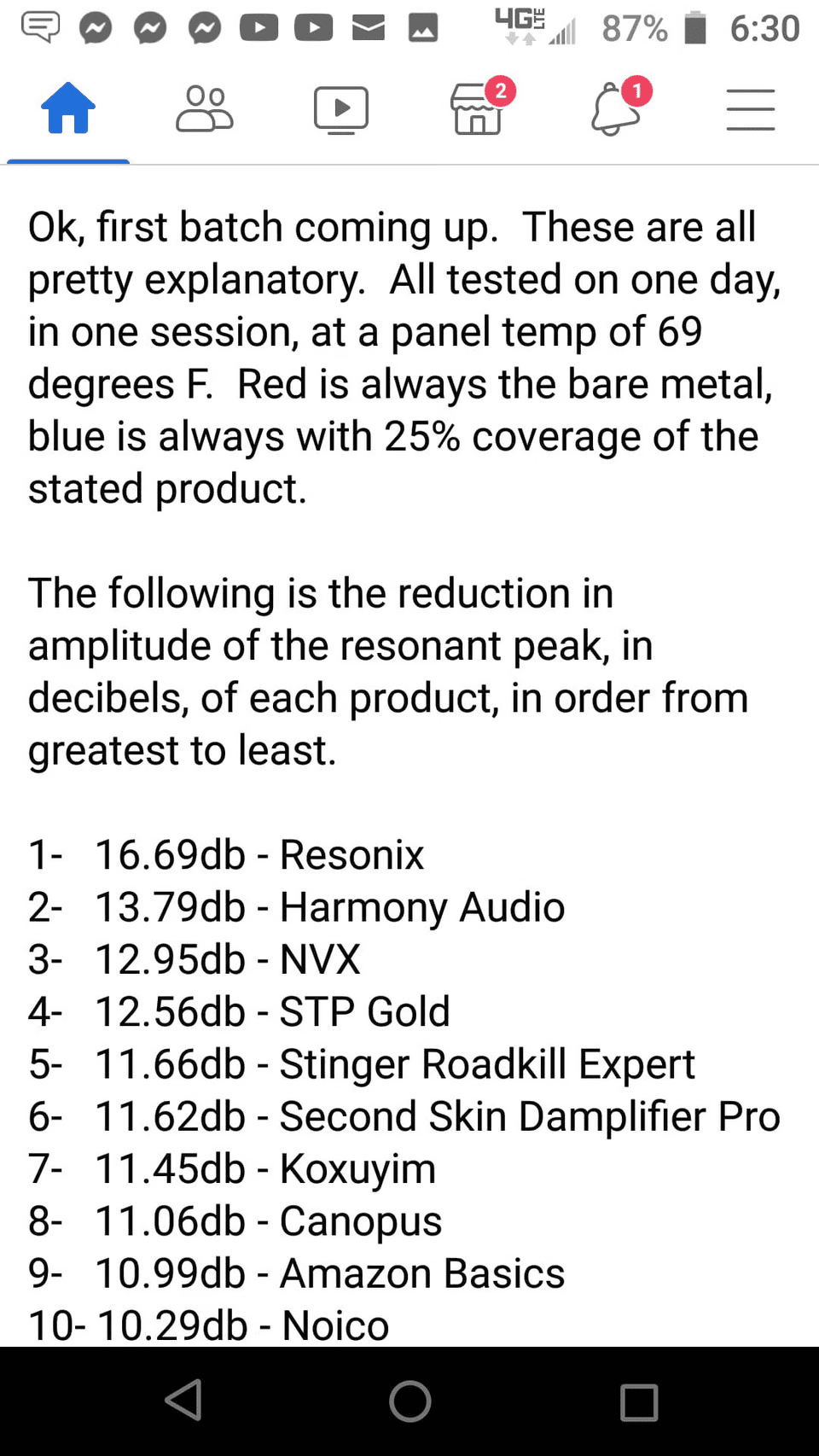

just seen this on forums idk the creidbility but somone testing sound deadening brands
Unless you're building an EMMA car or chasing pitch perfect sq...save some money and go with something else on that list...resonix isn't easy on the cc 😂
oh for sure it gets expensive easy 700 for their stg 3 2-door kit pretty pricey
his videos though are pretty in depth and gives tips on things that are effective or not-effective
also figured why them test results would be helpful in finding alternatives
