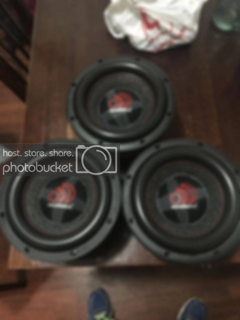

HDS208s but nobody has any. So its either wait or order the SA-8 V1.5.
Its been like Christmas at the house lately!

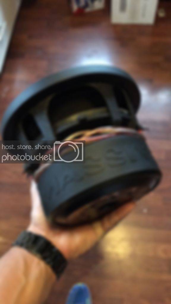

Massive Hippo 8"s

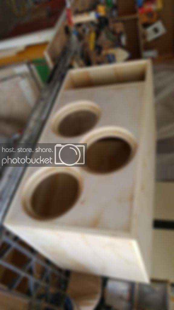

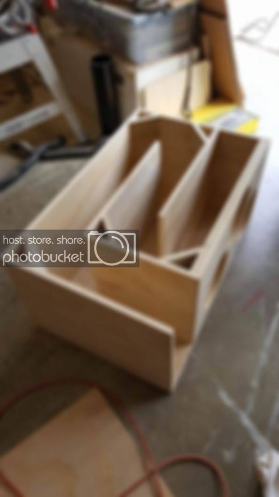

And Stang just sent me these pick this morning!
Custom T-line enclosure. Now I just need to pick out an amp...
