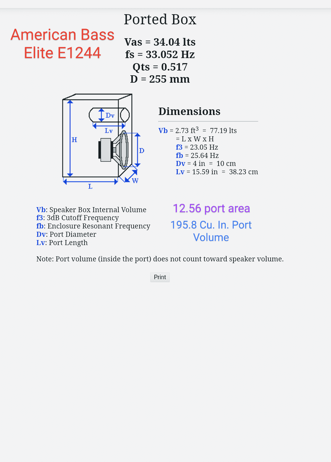

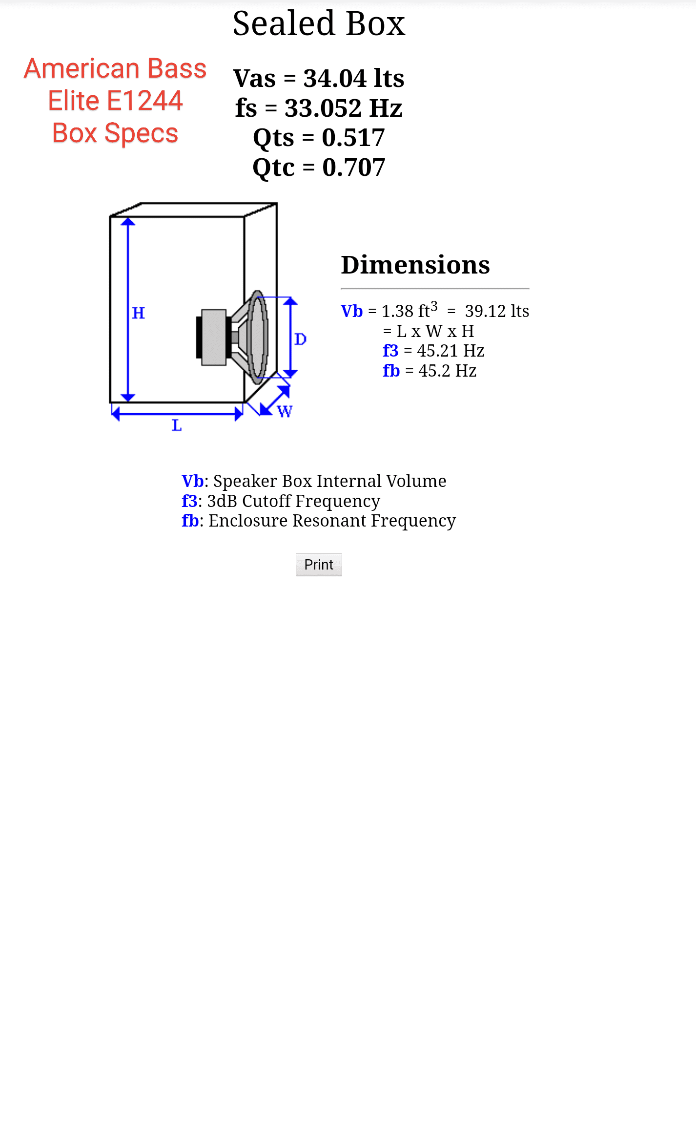

Ok understand, can u give the a good box size at 32 hz and length of what to cut? Am kinda new to this
I do not have the dimensions but drawing has net volume and port dimensions.
