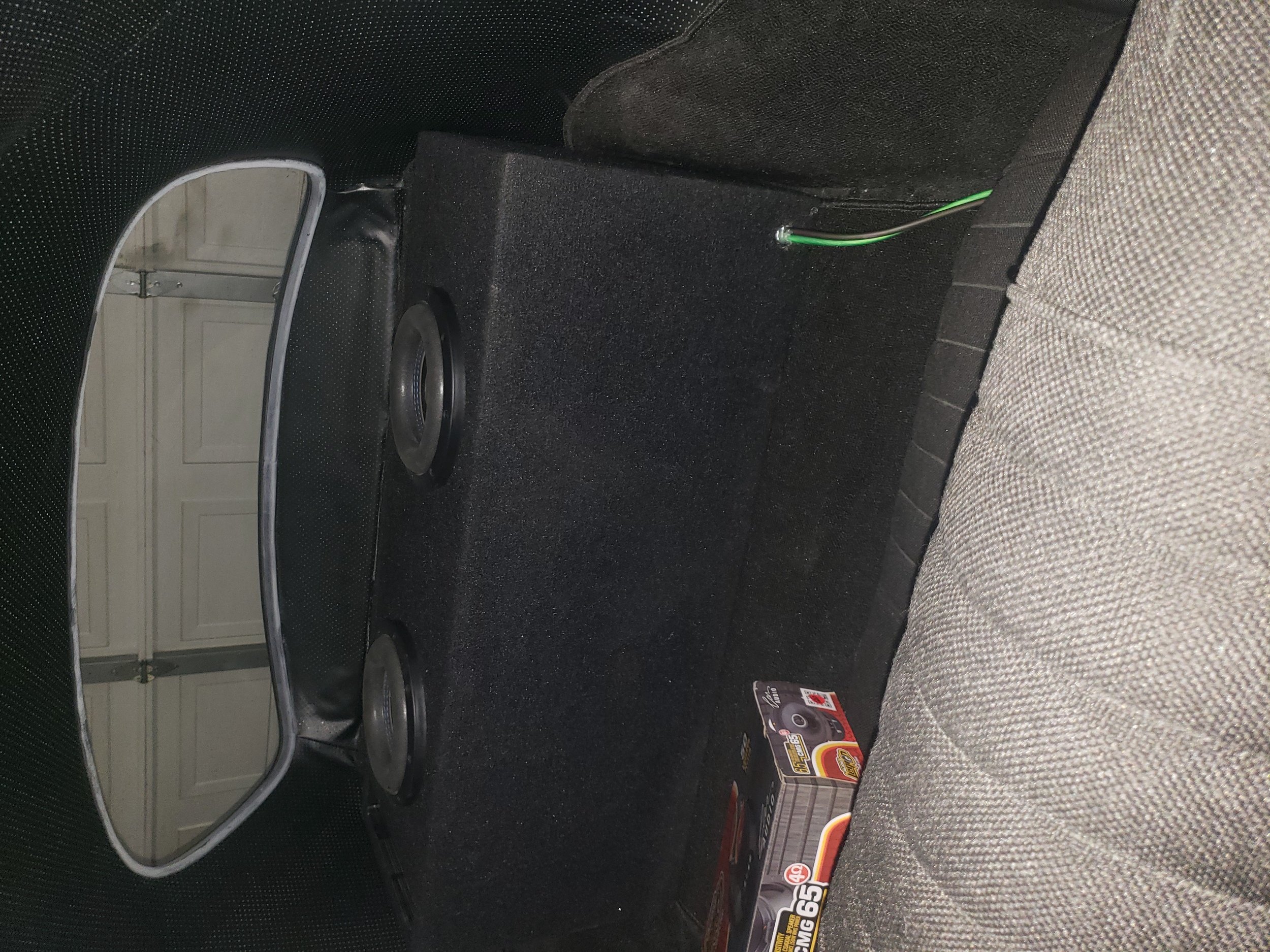

I can't move the box in the Bug and my seats don't recline. I'm guessing that 142.9 is about max for two 8's. Especially with a 55 amp alternator.
I can't move the box in the Bug and my seats don't recline. I'm guessing that 142.9 is about max for two 8's. Especially with a 55 amp alternator.View attachment 30281
Port on the driver's side should help, gorilla tape around where the subs mount usually helps, if the box is carpeted that will hurt. Anything you can move should be moved and tested, and make sure you don't have a bunch of stuff in the car like a cooler, your gym bag or tools or whatever. I'd also expect subs and port to the rear would work better in that vehicle but it may or may not be audible and you'd need to make sure you don't crowd out the port.
The box had to be carpeted and fit behind the back seat. I'm not competing with my Bug or truck. The scores are just for me. And 142.9 with two 8's @ 33 hz. Is plenty loud and low in a Bug.
