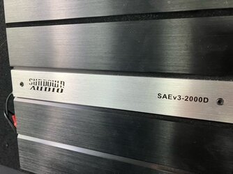

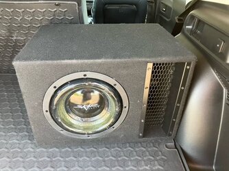

Ran out to my bronco for another pic real quick (I'm at work) so you guys can see the box.
Again.. I'm ok if you guys tell me I'm doing something wrong.. I just don't know.
I can change nothing other then swapping out to the skar amp which is a 1500D and it will rattle my vision with this set up as is. Switch back to this Sundown and I'm just moving the speaker.

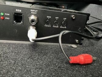

I even hooked this amp up to my barn stereo system(A/C-D/C converter system) which has 4-12" and two 18" to power the 18's and it did poorly. Hooked up one of my kicker amps to the 18" and it shook the floor. My barn system is quite amazing lol

At this point I think you may have gotten a dud. From all you have explained it sounds as if the amp filters are not playing low enough. Try using a tone generator application from the Appstore. Run a sweep to see how low the sound plays.
is that a thing .. genuine question? I will try and do that appstore thing.
You have tried all possible variations of settings without success. Add to that, you have tried other amplifiers in it's stead to ascertain that the subs and audio source are not the issue. Only logical conclusion is faulty equipment. Also there have been complaints of some stores passing off returned merchandise as new.
