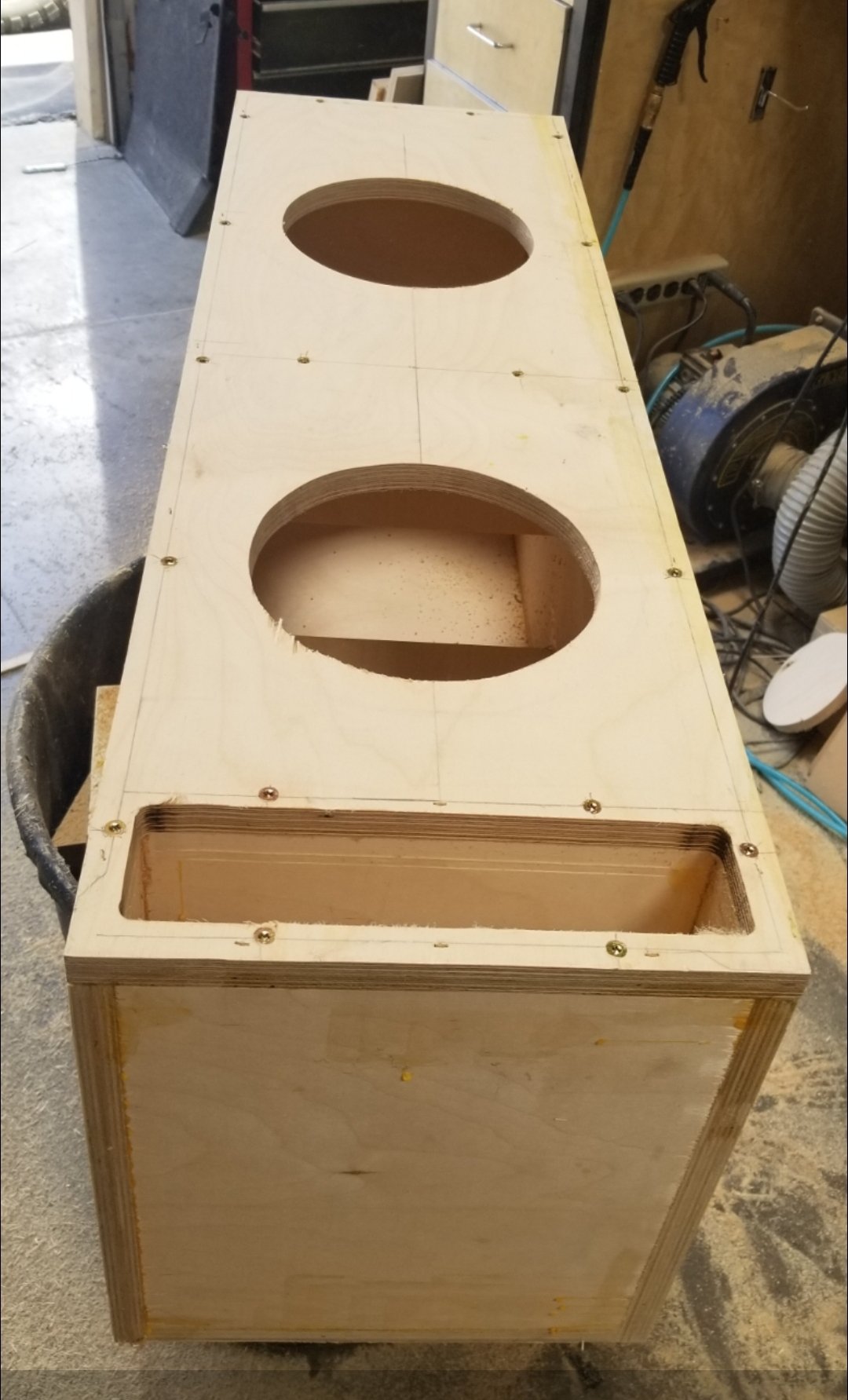

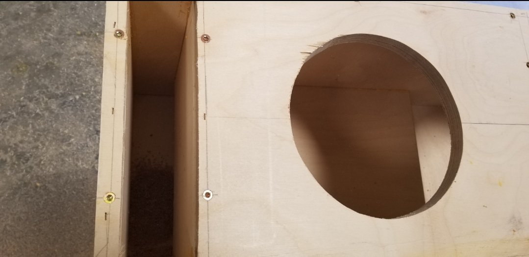

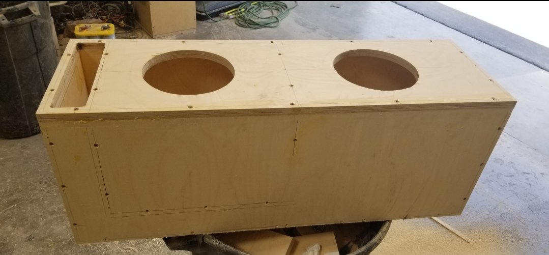

Box is built. I'm not 100% sure of the specs yet, but I think it's around 2 cubes net tuned to 33 hz.

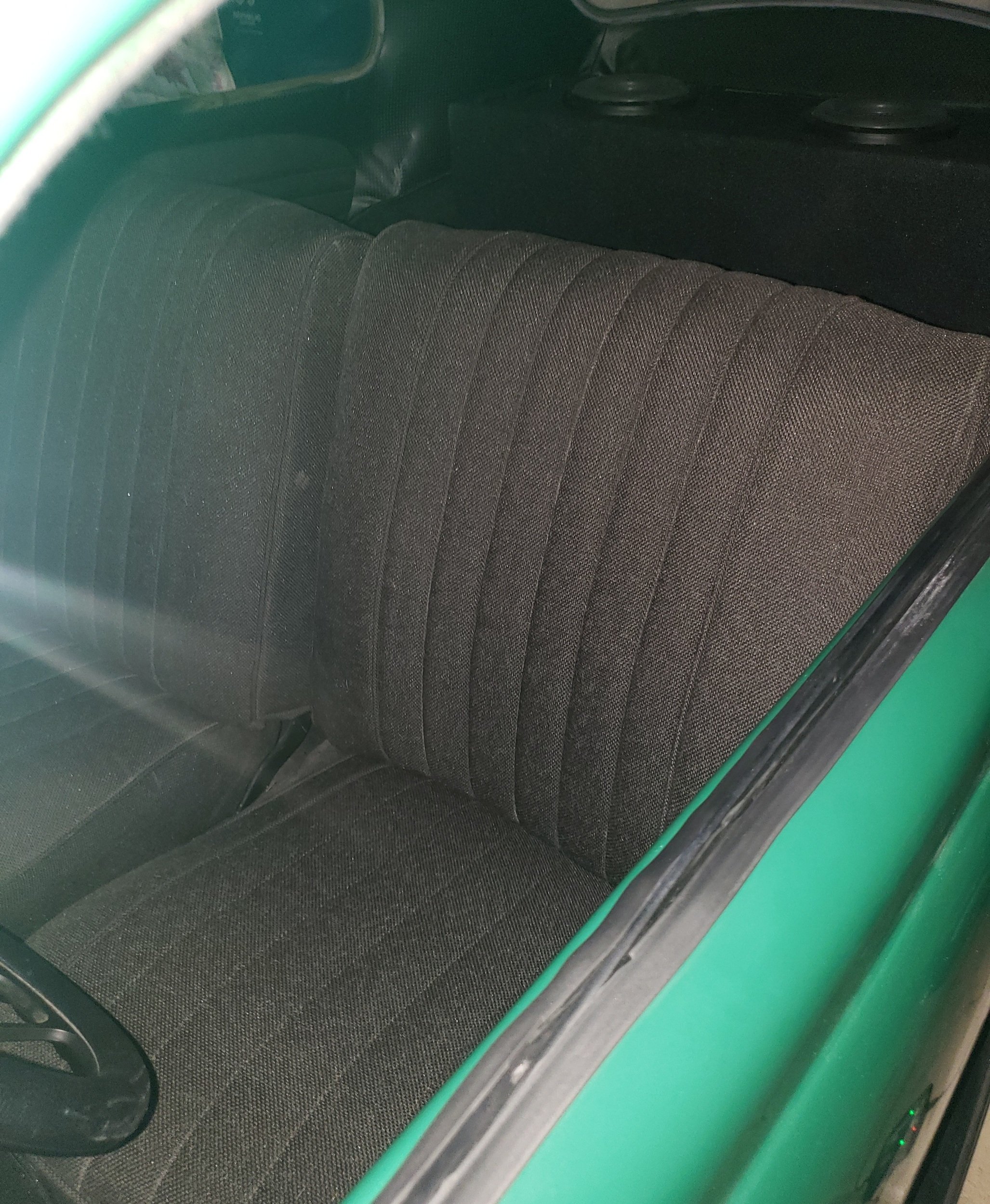

I gave him the dimensions and we put it together at his shop. 2.39 cubes gross. After subs and port displacement, it's right at 1.7 cubes. It's carpeted now. I painted the inside of the port black. Install tomorrow. He did a lot of it because I gave him two banks of lithium in trade for the box.

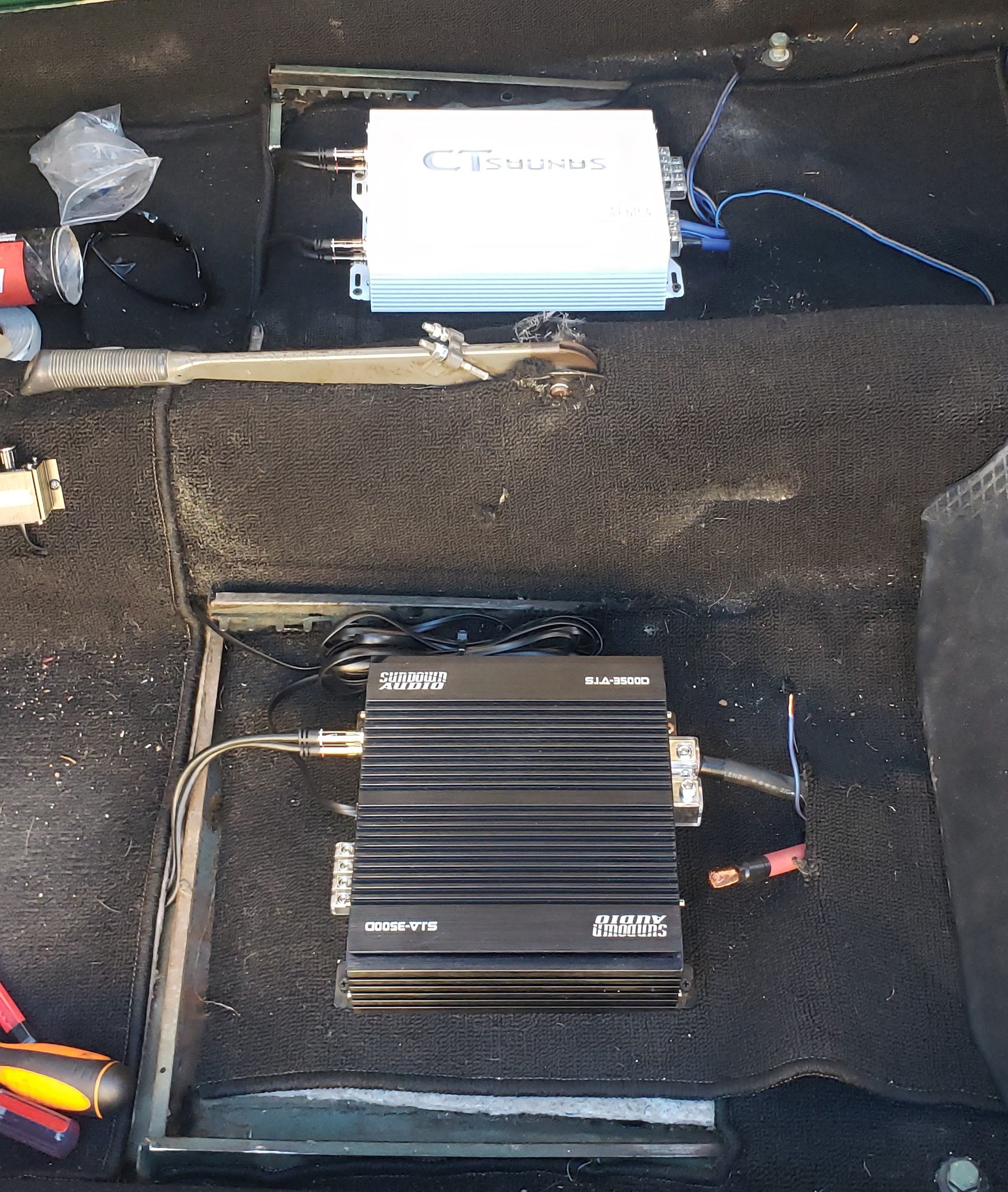

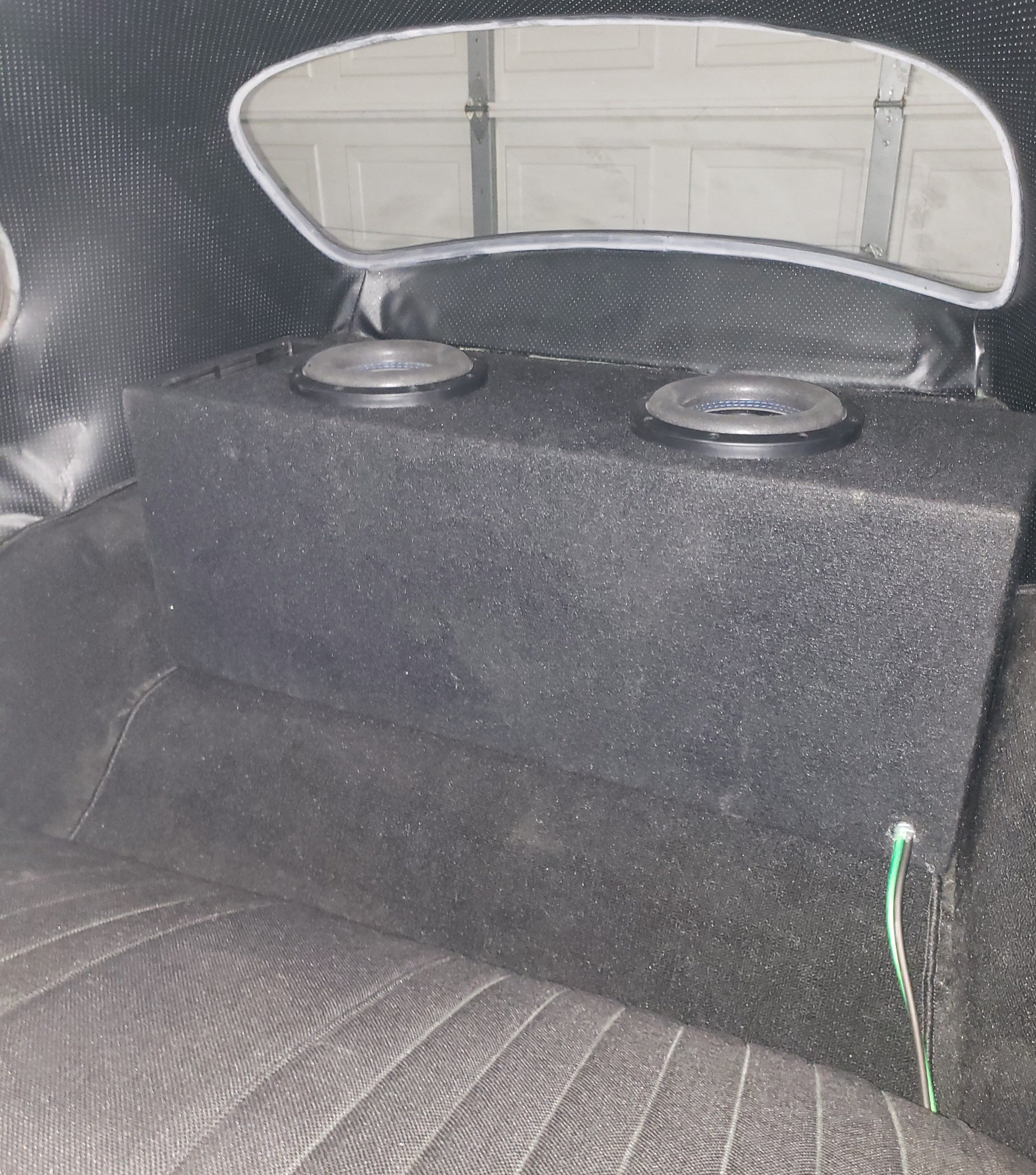

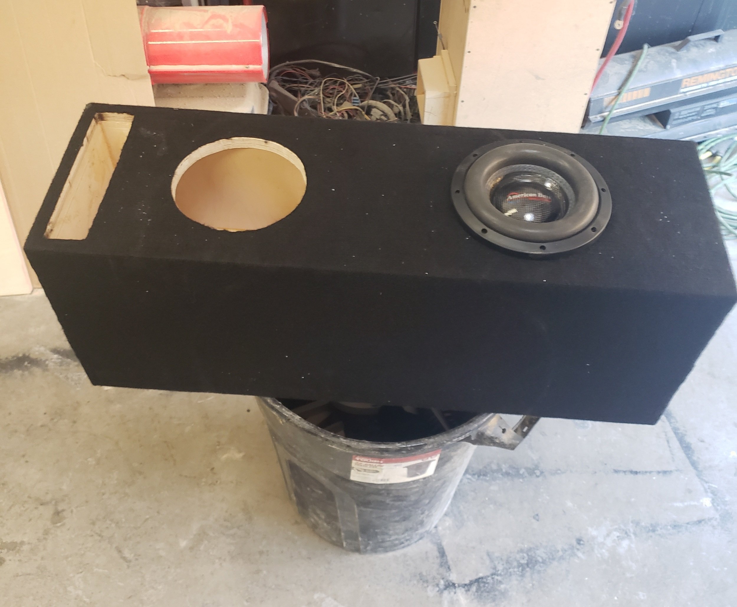

Sub box done and installed. These subs are pretty nasty for 8's. I still need to build the front kick panels to finish the build. We might add another bank of lithium to help the voltage.

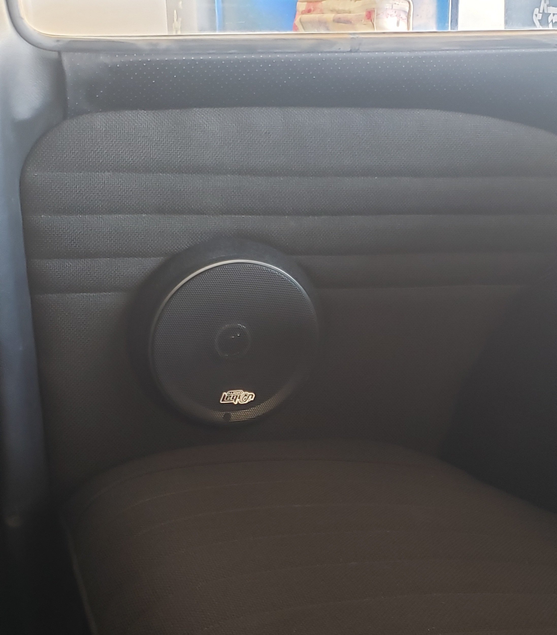

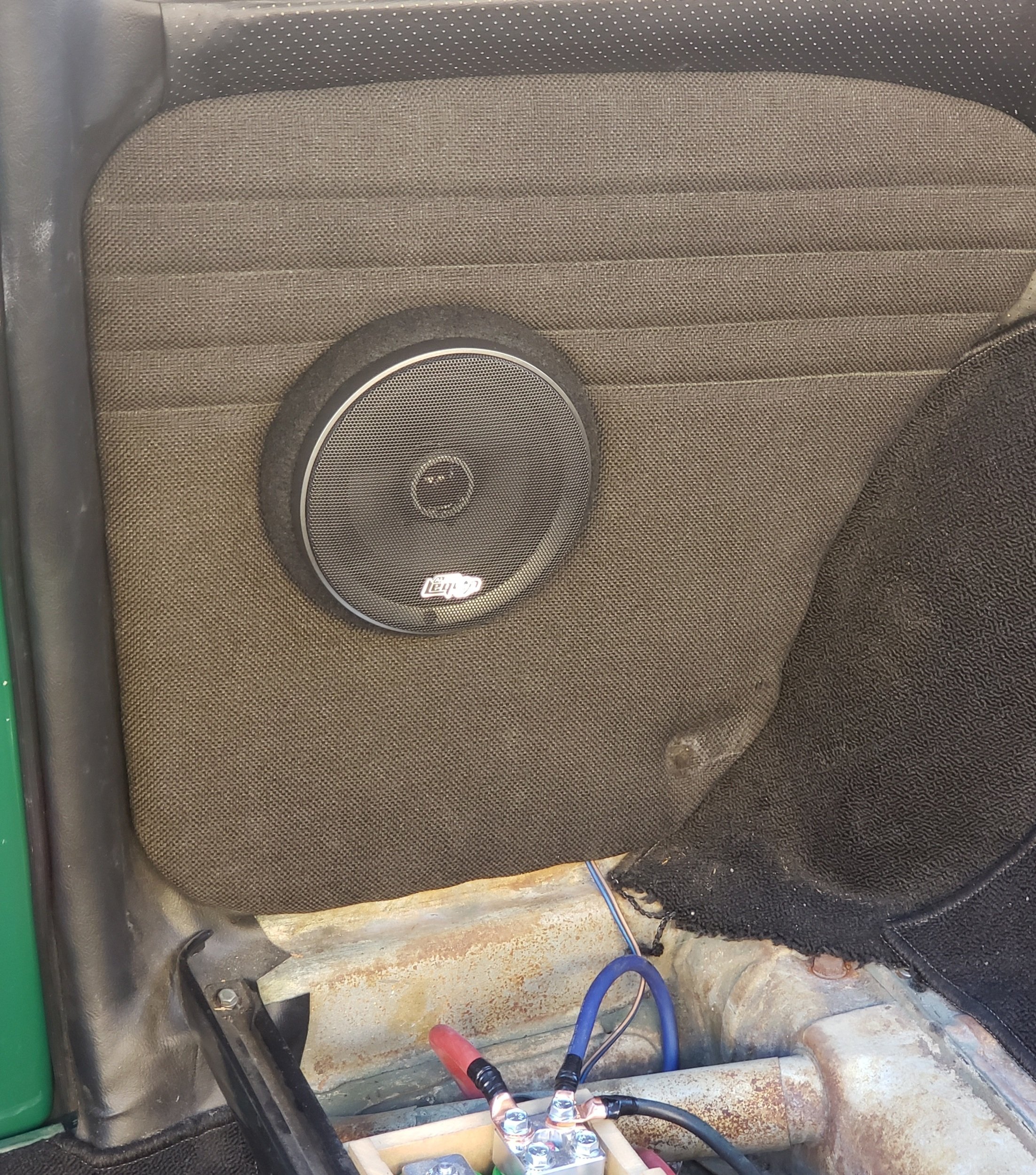

Rear quarters done and working.

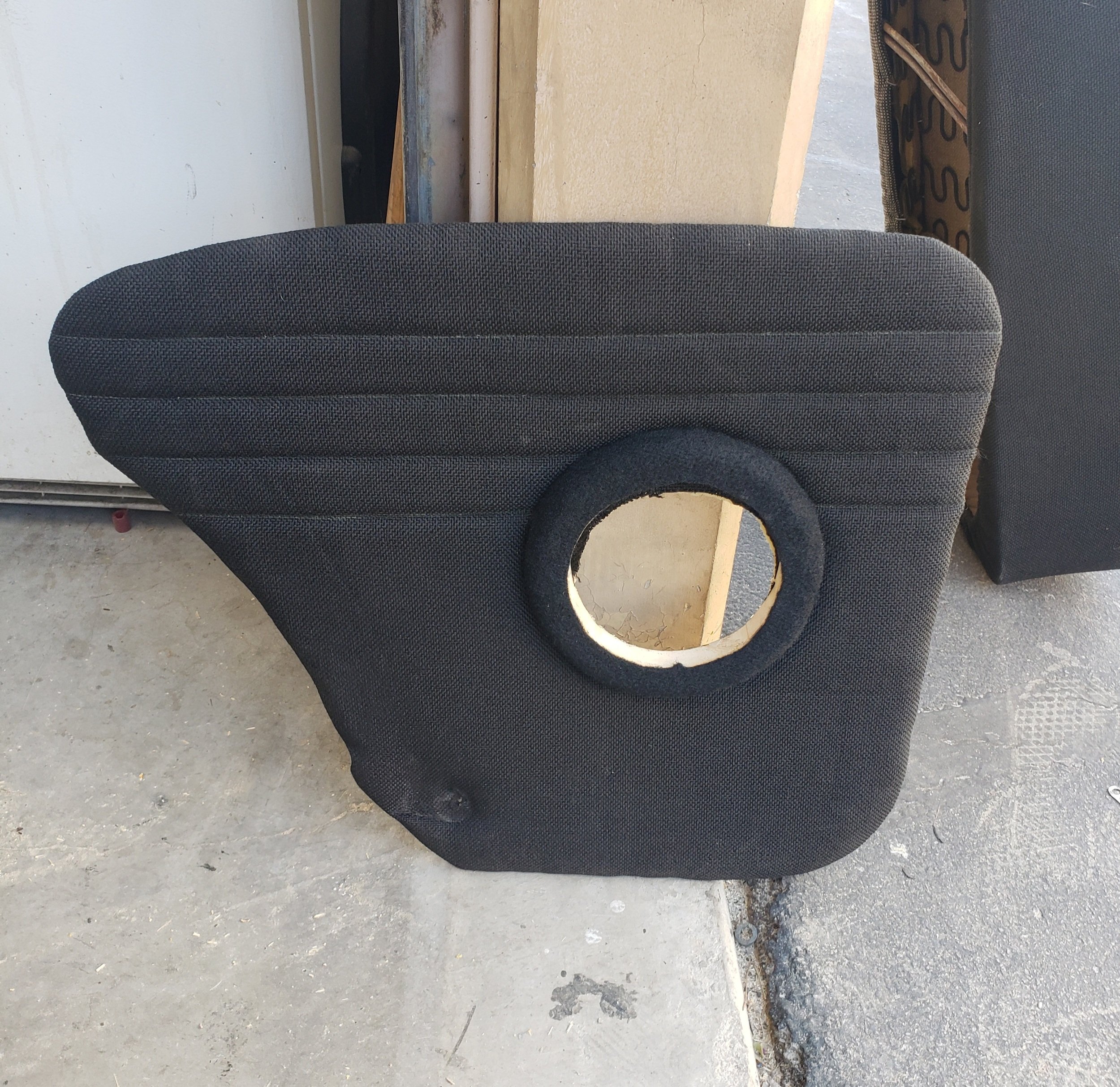

Couldn't you find something to better match the OEM door material? That would look really clean if you could get your hands on matching cloth.

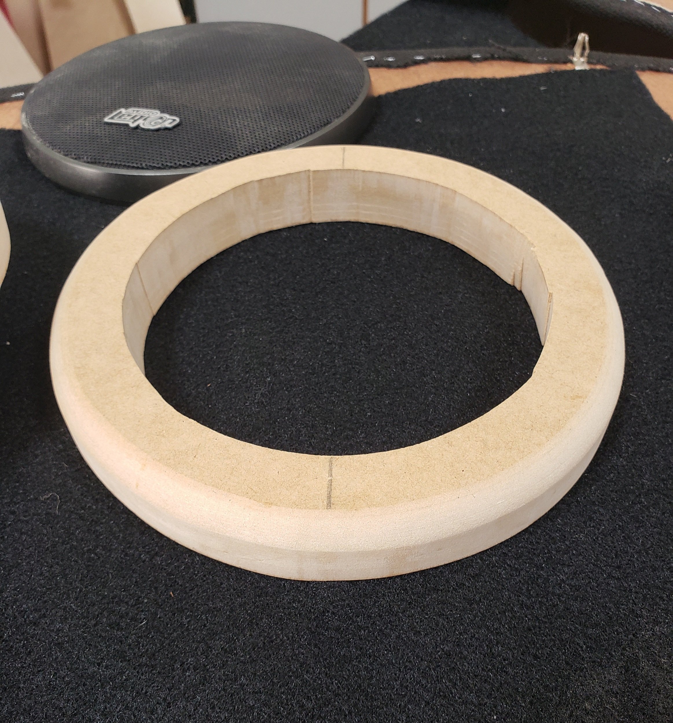

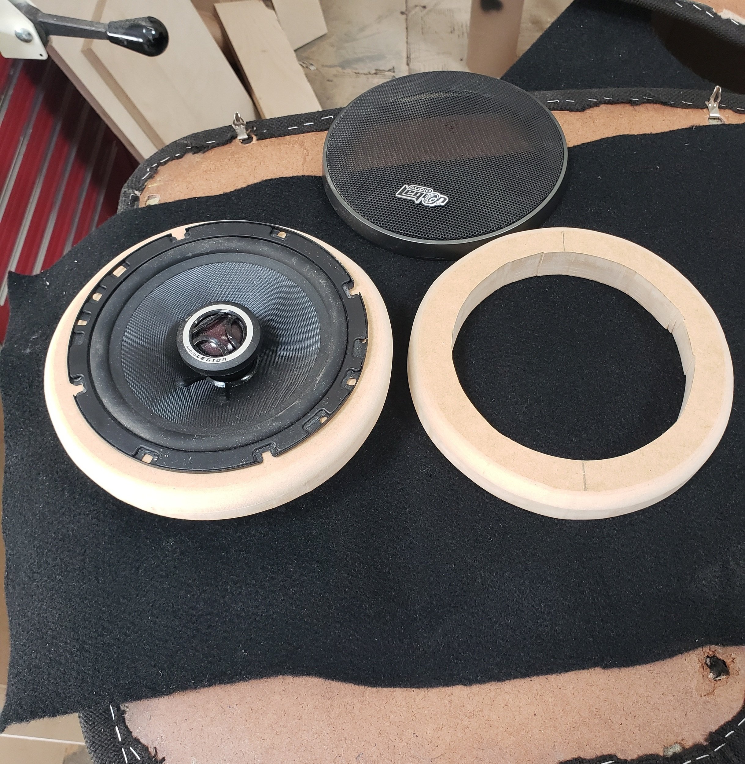

I probably could have, but it was Saturday and I didn't want to drive all over town looking. It's not an OEM interior. At least it's thin black carpet. Not perfect, but doesn't look too bad. The first spacer rings that I've ever made. They look alright installed.
