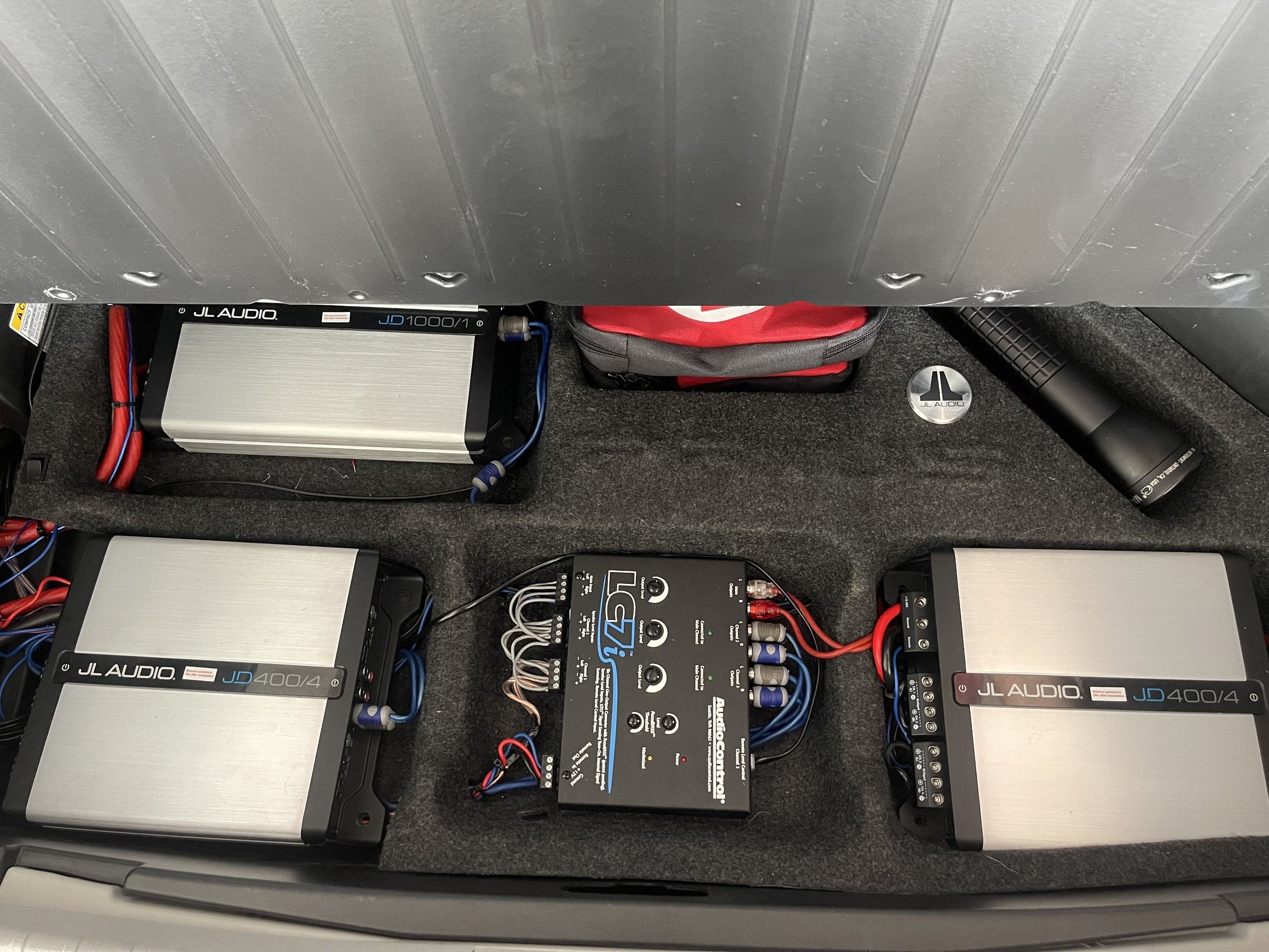

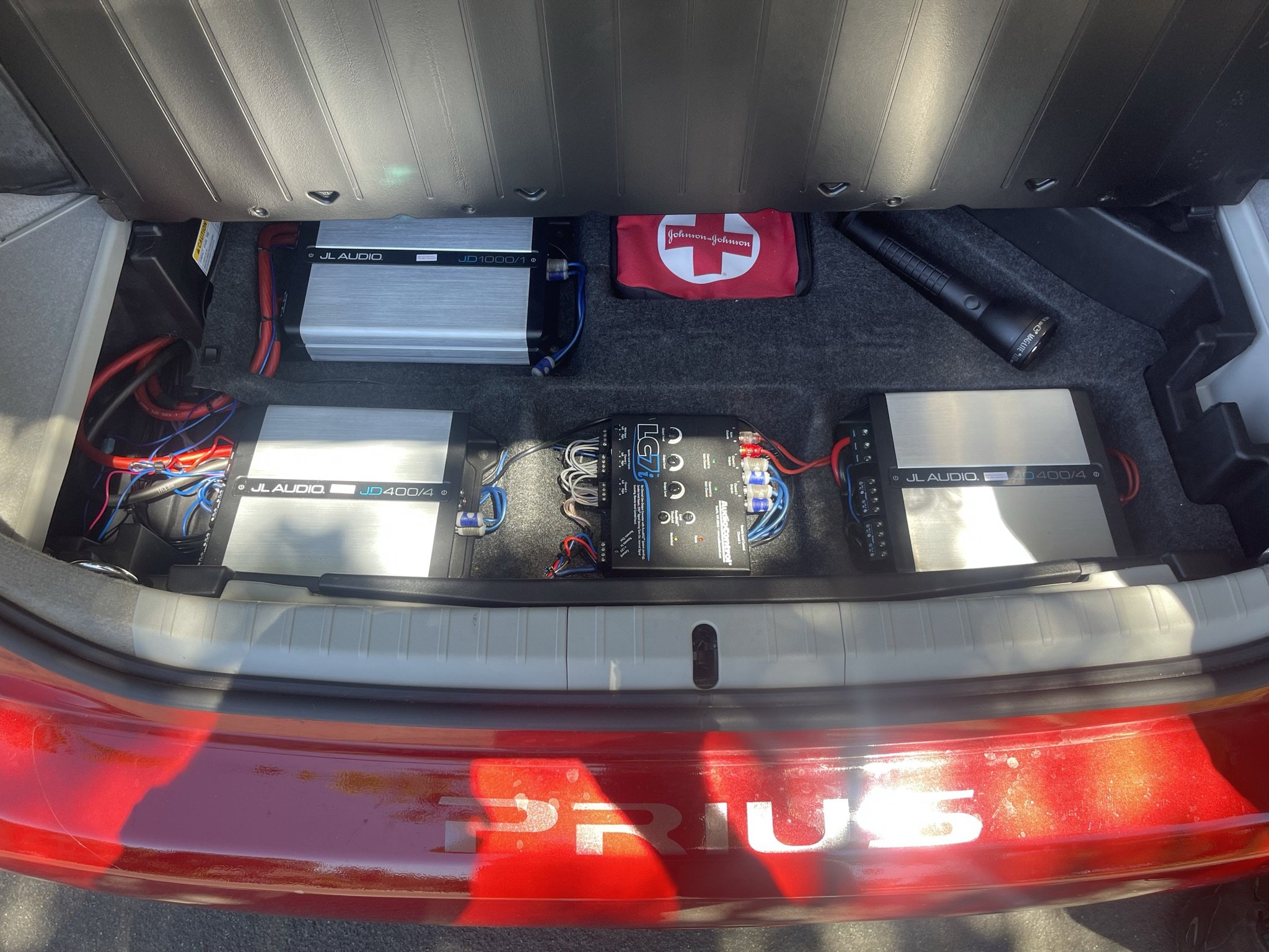

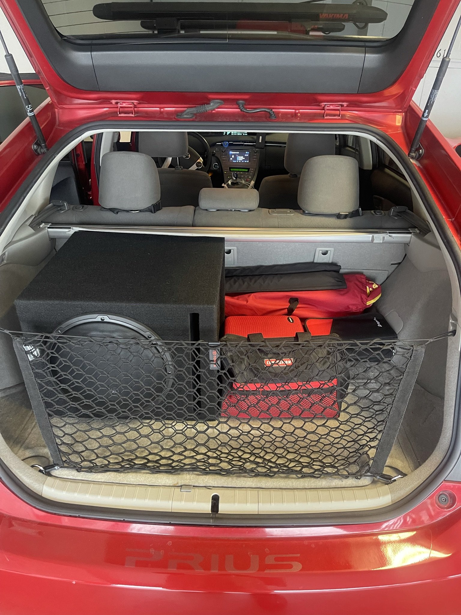

2015 Toyota Prius
JL Audio System
Stock Head Unit
Front fill: C3-650 separate components
Rear fill: C3-650 separate components
Sub: 12w3v3 (Custom Ported Box)
Amplifiers: Front fill JD400/4
Rear fill JD400/4
Sub JD1000/1
Signal processor: AudioControl Lc7i
Cool deal. Like how it sounds? You could likely sell the rear components and amp easily, go active up front and invest in a dsp if you ever want to change it up down the road.
2015 Toyota Prius
JL Audio System
Stock Head Unit
Rear fill JD400/4
Sub JD1000/1
View attachment 30314View attachment 30315View attachment 30316
