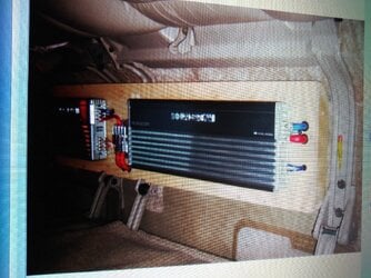

So, the dyno test by Big D, doesn't help? The only other amp I looked at was the Taramps MD300.1 4 ohm version, 3,000 watts @ 4 ohms, but only 1,920 watts @ 2 ohms. Weird amp IMO. The Soundstream 2500.1 L.E.'s are a little different than the regular 2500.1's. Attached is a rough start to the sub box.
I saw it awhile ago... that's a big ol sub you got there and wired to 1 ohm in a decent box you'll probably see 3ohm power at best around tuning.
Hell... it's bought... I'd just build a bigger box (whatever space your willing to sacrifice) with enough port at this point if your goals are low and loud.
No it's not just diff color.
I actually ran the Rubicon 2500.1 and matching 4 ch amps for about 5 yrs. They were ok but the mono amp fell short of it's claimed rating. A lot of mfgrs will do this to get you to buy. I have since sold them will NOT go back to SS and went with a much better brand. Bobbytwatnames just because it says it does 2300-2500 doesn't mean it will.... lot of that depends upon how strong your electrical is. I myself would have kept that Orion amp instead of selling it. You downgraded yourself.
