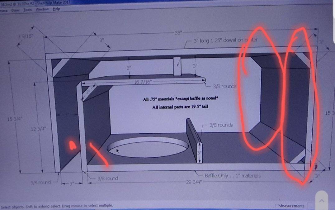

Actually if you study the plan you might notice a difference with 45 placement, it'll affect volume too... oh well... I suppose it's good enough
You are absolutely correct. That's my box building inexperience for ya, this is my first sub box build. Icn still add those 45's if you think it will help? I don't think it would take up too much more air space.

Jeff, I upset Shredder. Didn't mean to, but I got the orientation wrong on the 45's in the box that he so kindly designed for me. I owe him. I was just wondering if I should go ahead and add the four 45's that I screwed up on? I attached a pic of the locations they would be added (yellow). It's my first box build. I'm upgrading the power that was figured for the box, so, maybe adding them won't affect the cubic feet that bad. I know that this thread needs to die already.
Nah... it's your 1st build in awhile. Looks like you are going slow and doing it right. it'll still be 4ft3 in the low 30's
Congrats on being in first. Is your system listed anywhere? O.k., it's the first box that I've ever built (50 years old). So, the airflow won't be screwed up? They would be simple to cut, 19.5" 45's with the ends also cut on a 45°. I might as well build it right, right? If you haven't realized yet, I overthink everything. 😂
