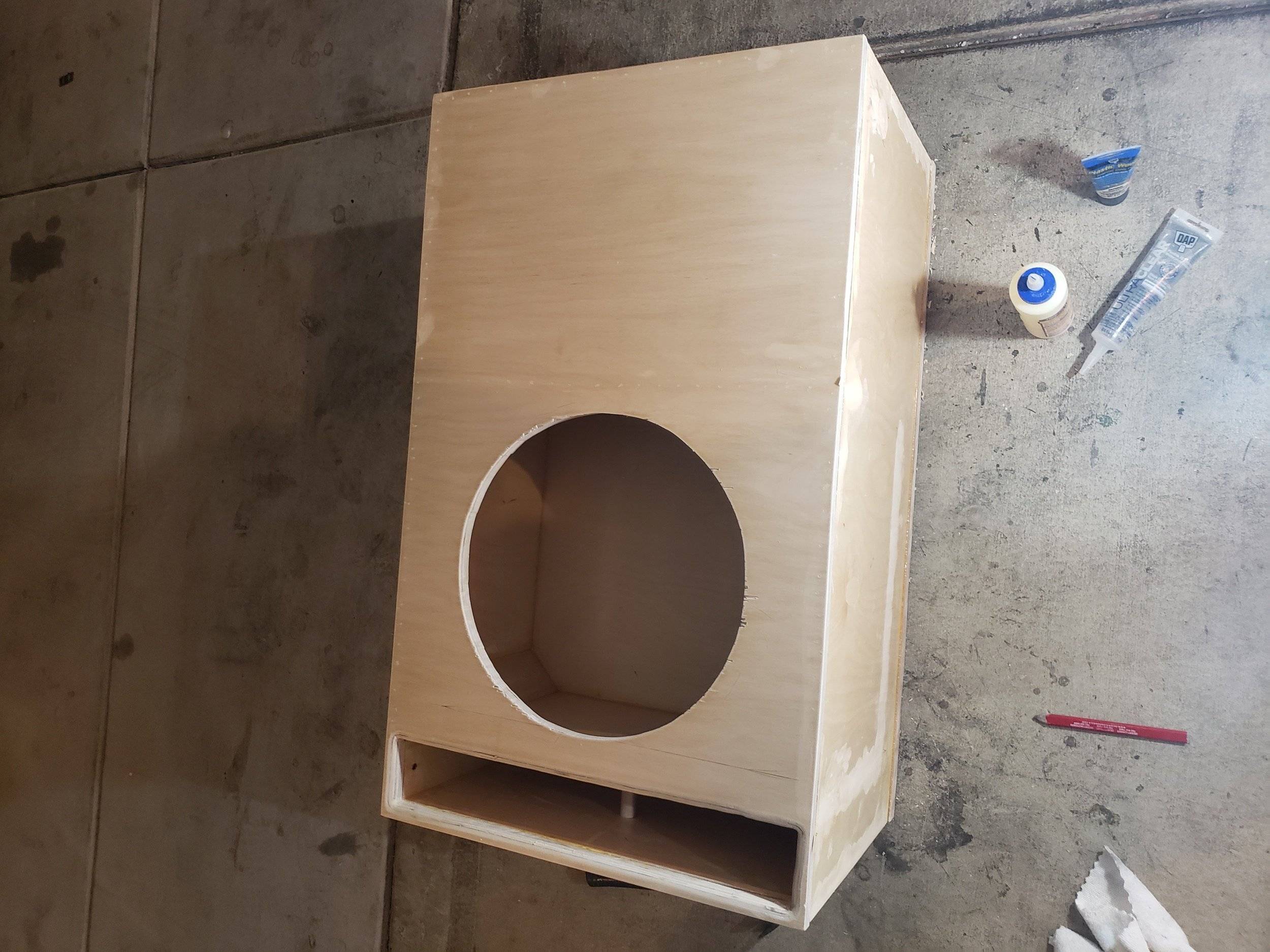

Finishing up the box tonight. 35"L X 21"W X 16.5"H. If my math is correct, the box is 5.57 cubes gross and 3.9-4.0 cubes net. Tuned to 32hz. Still needs siliconed and three more coats of clear. Still have to run the router around the box, as well. Battery has been sitting for two days.

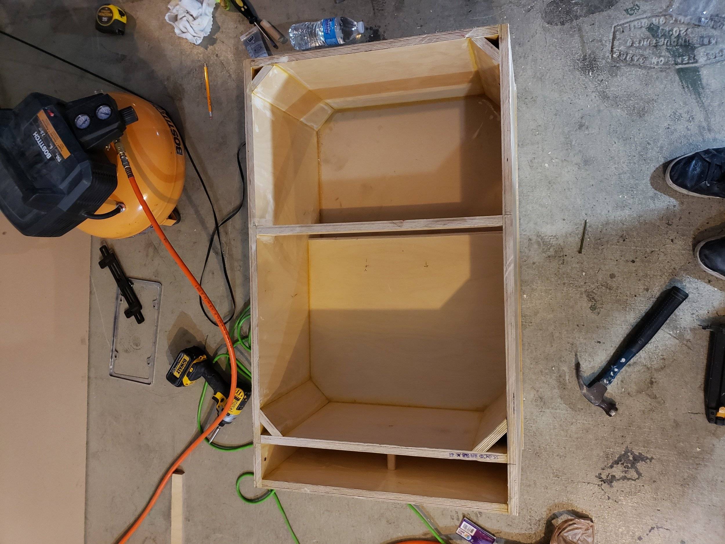

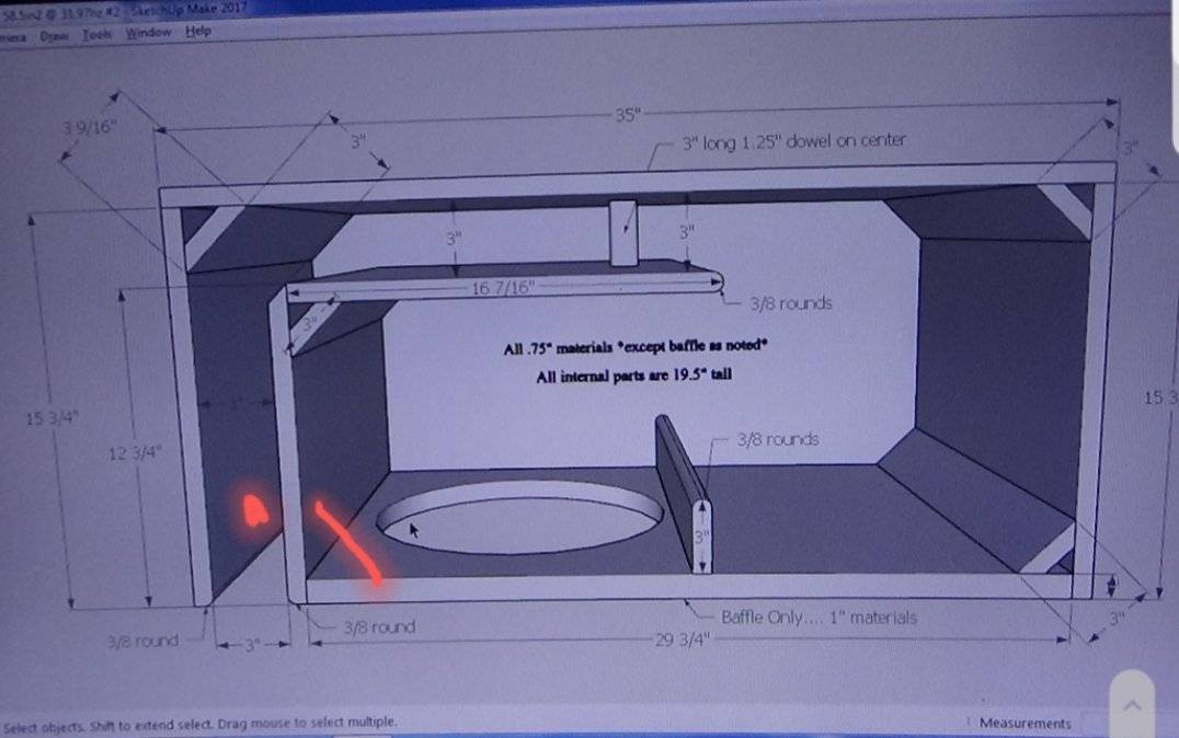

Looks like you put the 45's where you wanted, changed the baffle and added doweling.
I'm sure it'll be fine, but that's it... I'm tired of designing crap and having it "modified"... I'm out.

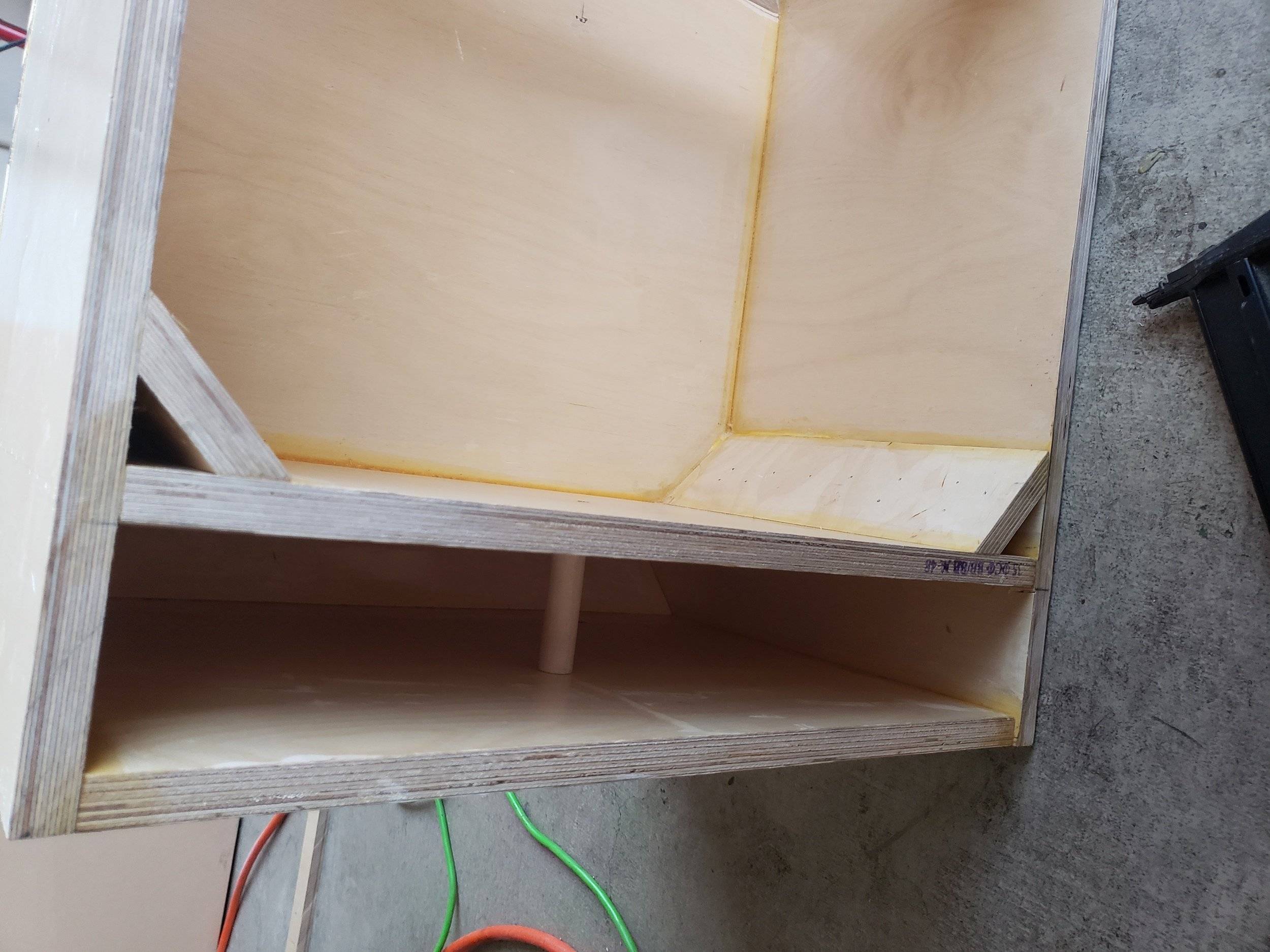

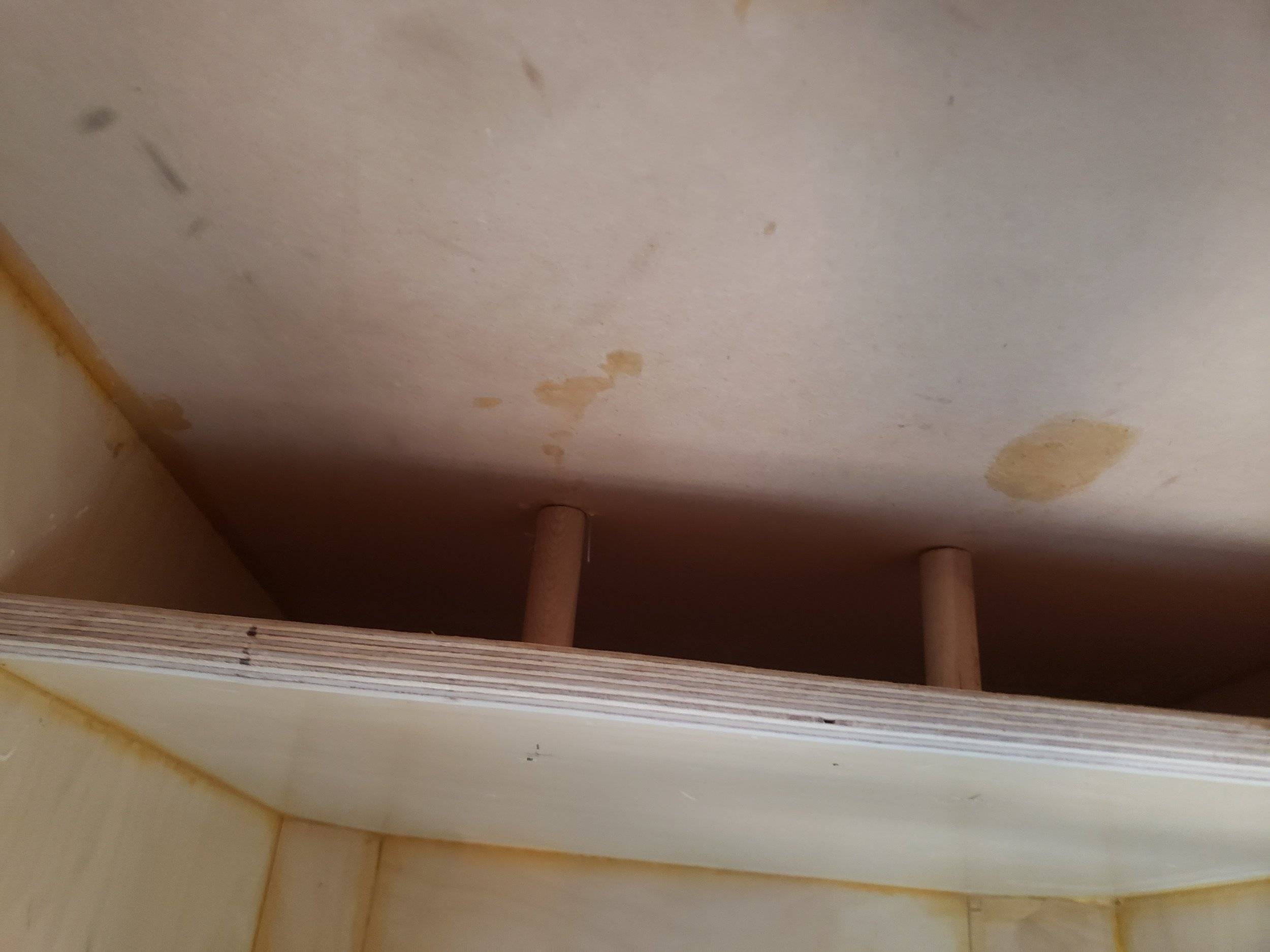

I couldn't find a 1.25" dowel, so, I used two 5/8". I used the 1" mdf on bottom instead of the top, like we talked about. I added one 45, that's it. All the 45's are exactly where you wanted them. The air space is the same minus the one 45 that I added. The red shows the minor additions that I made. Sorry!
