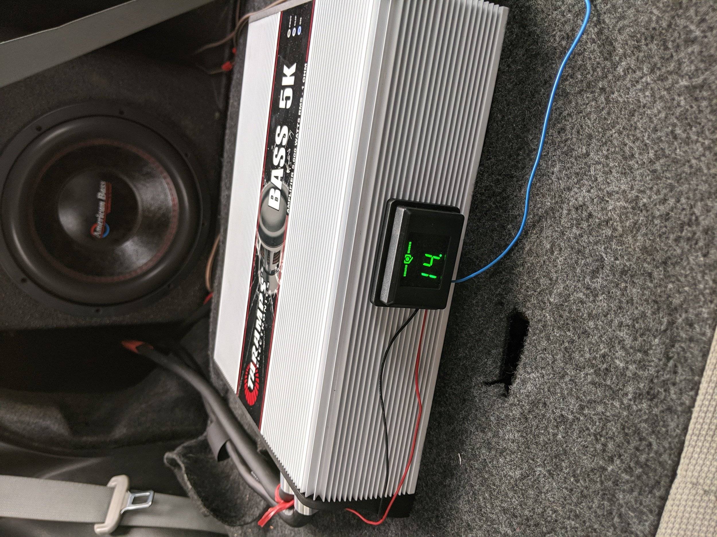

It is a must but when you buy taramps it also has a clipping light. If mine drops to 13v I lower the gain

as long as the clipping light is not going off and the subs can take the power, you can let it drop down to battery resting voltage no problems. Voltage drop just means your amp is actually outputting power and drawing proper current, there's no harm in not keeping at 14 volts if its not clipping, you are just short changing yourself out of a lot of output.

It drops to 12.8 sometimes on very bass heavy songs. My gain 3/4.
Think it clips at about 12.5 but I was told it's almost an early warning light. it never even gets warm.
