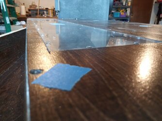

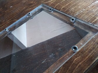

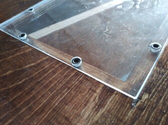

Going for that flush look. And the plexi is removeable.
