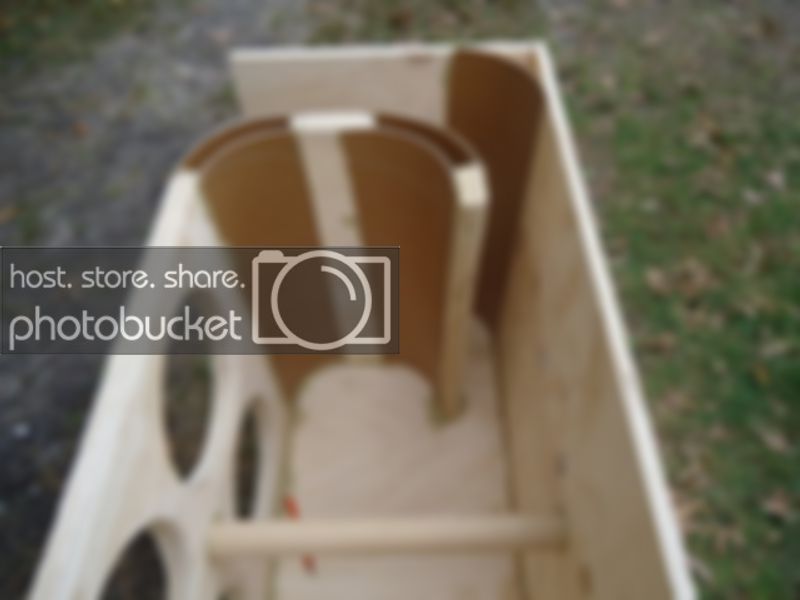

A small update. Rotated 90 degrees firing towards the driver's side this box does 149.7 @ 38hz. Really optimum for this jeep is porting to the driver's side, but I just don't have the volume to spare to allow proper clearence for a port. I'm considering some more exotic box options for next season.
Something else new. Built up a 4th 12 (I may or may not do up another 10" CF/Kevlar cap for it). Decided to build a big low tuned box just to test.

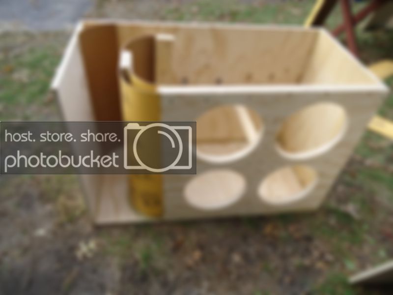

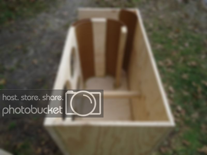

From prior testing porting up seems to work well so port and subs up. Box is about 10 cube after port, bracing, and woofer displacement and tuned to 28hz.
Initial testing this box is doing 147.9 @ 31hz and 147.6 @ 55hz. No more than 2db down between 28 and 65. Sounds very nice. I actually found myself taking a 45 minute ride on the highway tonight for the sole purpose of listening to a bunch of songs to really put things through the paces. Will post a couple more pics when and if it stops raining here.
On a side note. I'm really getting into the sono tube for roundovers and flares. Used 12" for the outer and 10" for the inner. Rabbet out a little bit, some liquid nails and a staple gun and it's solid as you like when you stick everything together. Port is nearly 180 square inches (6" X 28.5")
