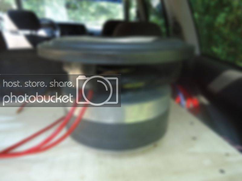

Currently a single Shocker Sig 12" .... will be building up 4 12" sigs this week....considering scrapping the 18's so I can use neo motors on some of these, but they work well so I don't have the heard to break them down until I smoke them....that'll be another project I think.

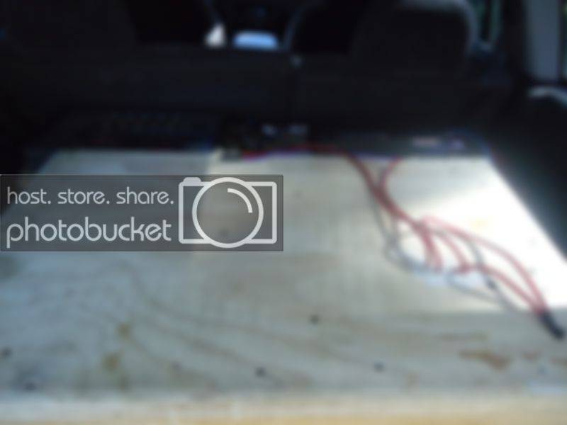

Been using some 18" neo sigs most of the summer but don't have enough space to really do them right and picked up some ceramic motors on the cheap. Just to warm up I have a single 12 that I use when I need to conserve cargo space so I'm running that currently to get into the mood for 12's.
Box currently is appx 4 cube tuned @ 40hz give or take. It peaks at 39hz in the mid 145's currently (amp is seing 2.8 ohm nominal currently)

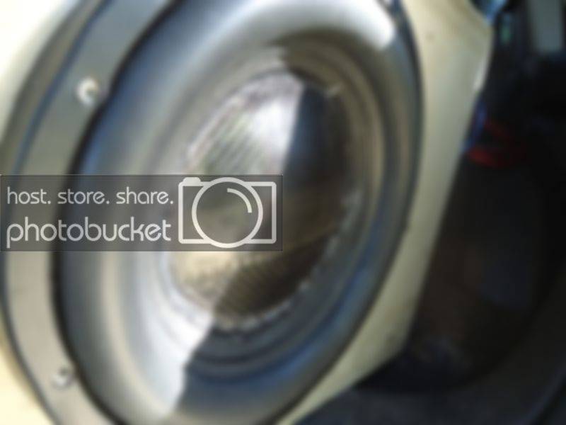

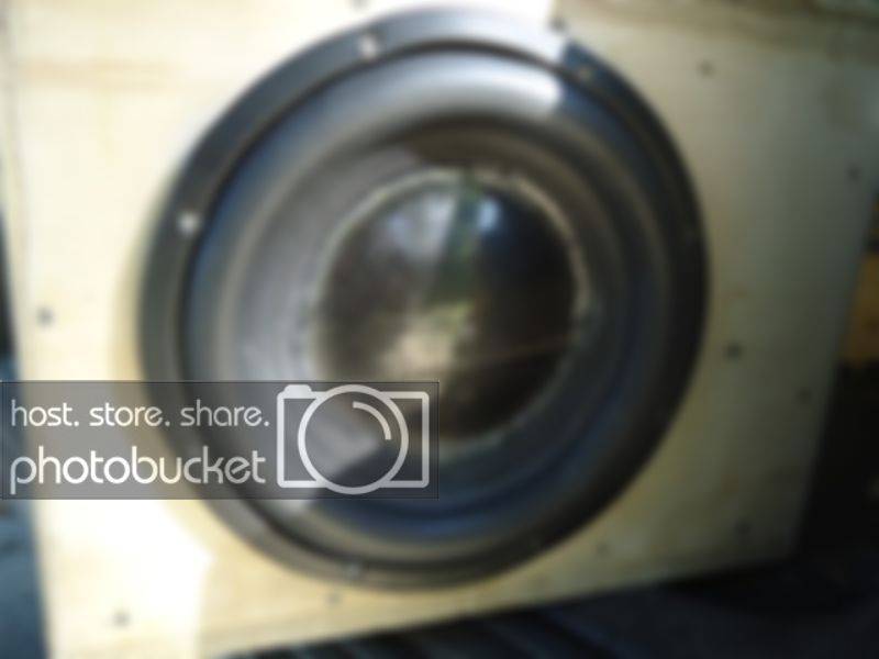

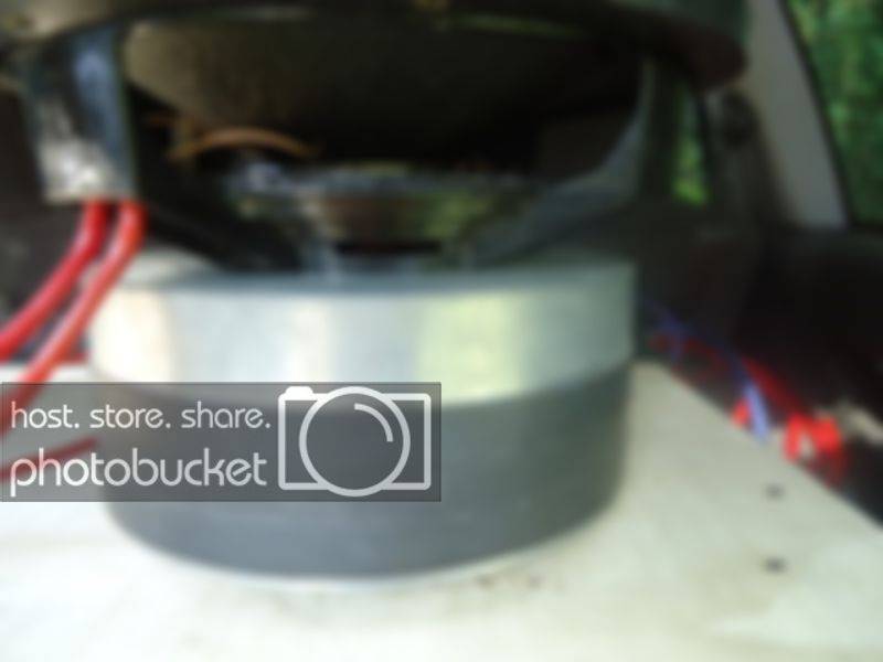

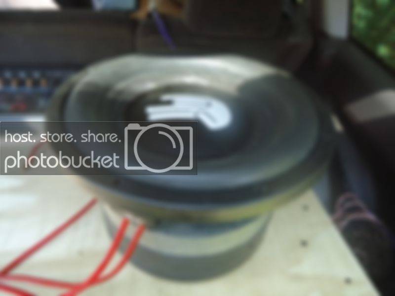

Blew off the dustcap in some testing (was a quick job anyway) and I've been attempting to make my own CF caps. This is an early attempt. I didn't use a solid piece for this but some end pieces I had cut off the sides of the mat (**** is expensive and I can't see wasting a lot of material while practicing my technique).
Anyway, besides the seem in it it looks decent and it's lightweight and hard as rock.... and covers the skanky glue from the last cap.
Got my 4 new sig motors sitting here along with plenty of cones, spiders, tinsels. Waiting for baskets and new coils....will also attempt some more CF caps for the new ones (I will try full cone style if I can build a mold)... I'm pretty confident I'm only about 50$ in mistakes away from being able to do a nice CF dustcap.

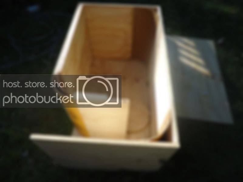

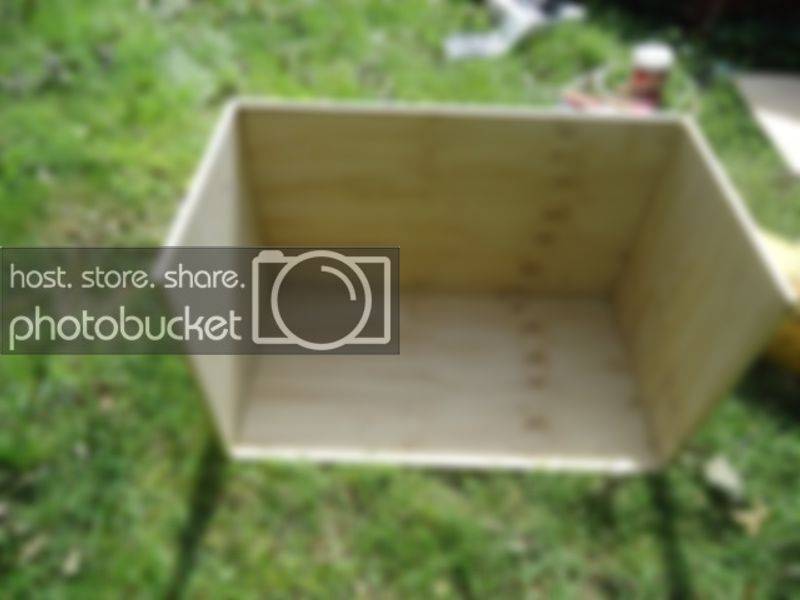

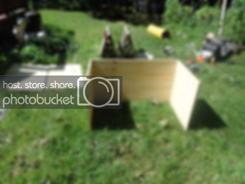

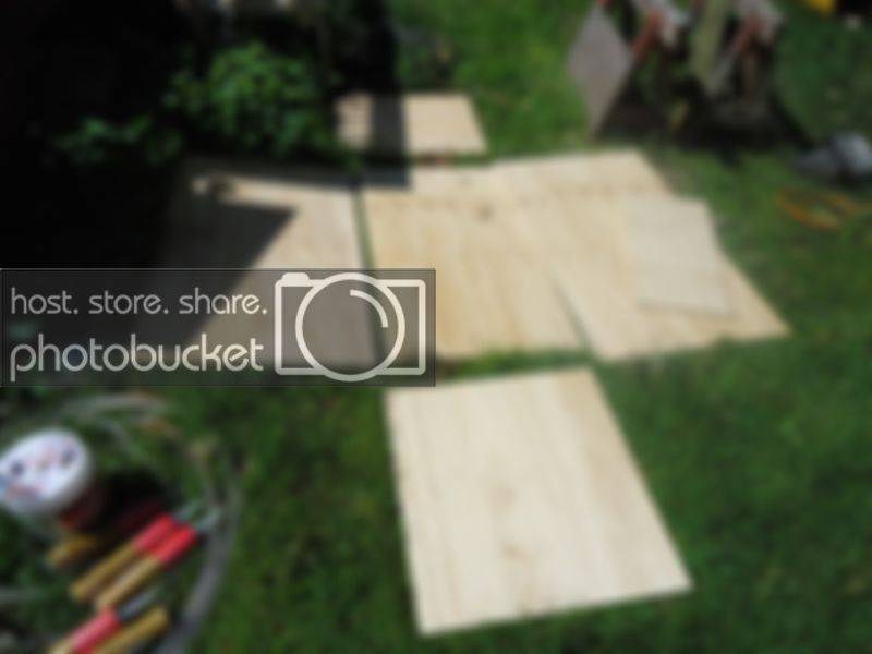

Coming along well enough. 25$ a sheet "cabinet grade" ply from Home Depot. I had the kid there make most of my cuts for me too....saves time and is much easier to get them loaded in and out for the ride home with everything. Their saw isn't perfect, but it's close enough with the belt sander (and of course hand cutting the last couple pieces to match whatever odd size they cut things to)

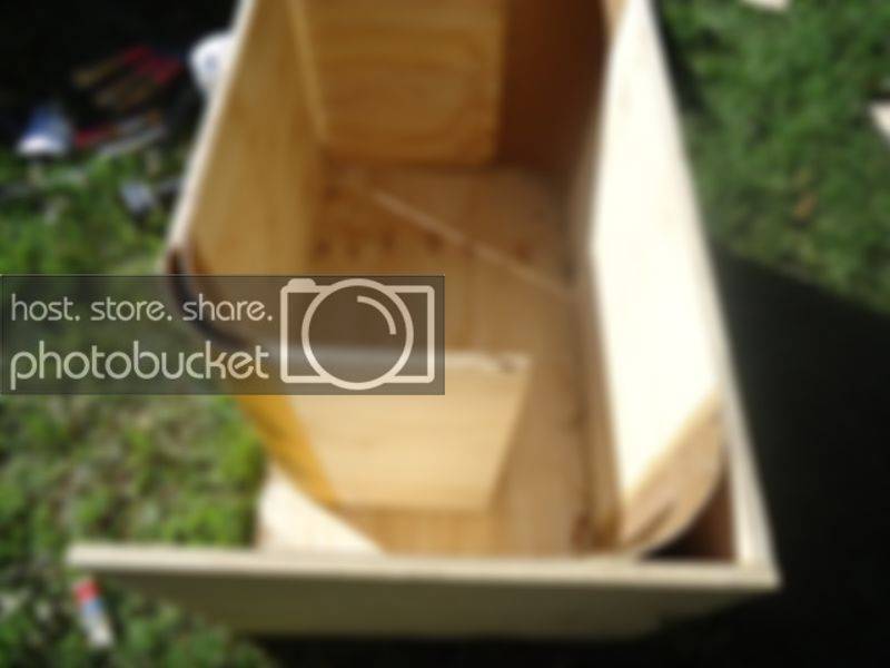

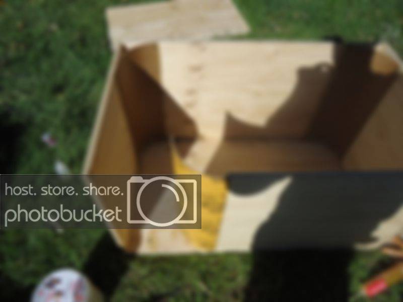

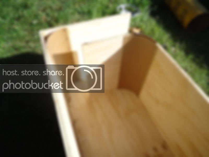

Wow..... what to do with this 12" sono tube??? A port????

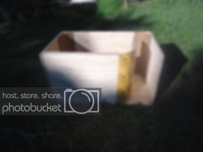

Cut to the width of the box and quartered the long way.....
rabbet out this piece a little bit.....

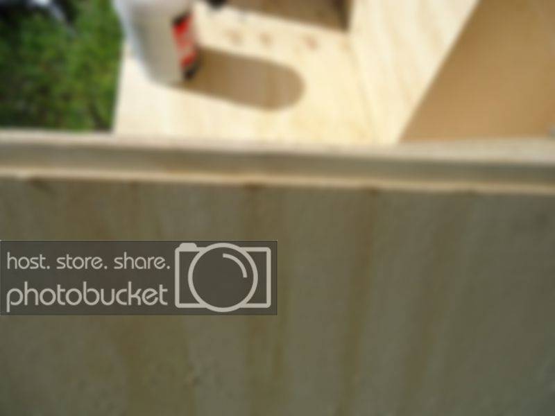

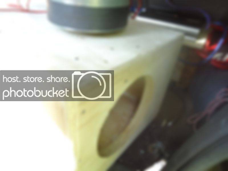

Bam!!! Got some good roundovers for the bottom corners and a big *** flared port.
Screws are in the roundover pieces just til the glue dries up (overnight). Will remove and bondo things smooth.
The doubled up pieces are also just to hold while glue sets. The baffle side will be doubled (possibly trippled) up, and I'll reinforce the short port wall....but not with that piece probably....or with that piece at the bottom after I roundover everything.

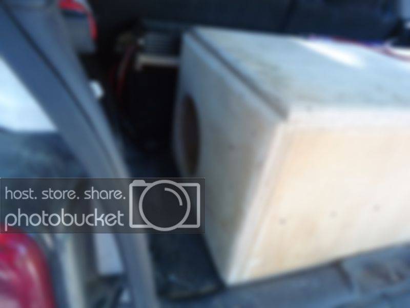

Tomorrow I plan to get it mostly finished. Looks like I only have about 9 cube net so I'm going with 3 12's.... also would be super tight getting them all on the baffle.
Still waiting on baskets and coils, but expect them tomorrow and will build up subs tomorrow night or Thursday.
