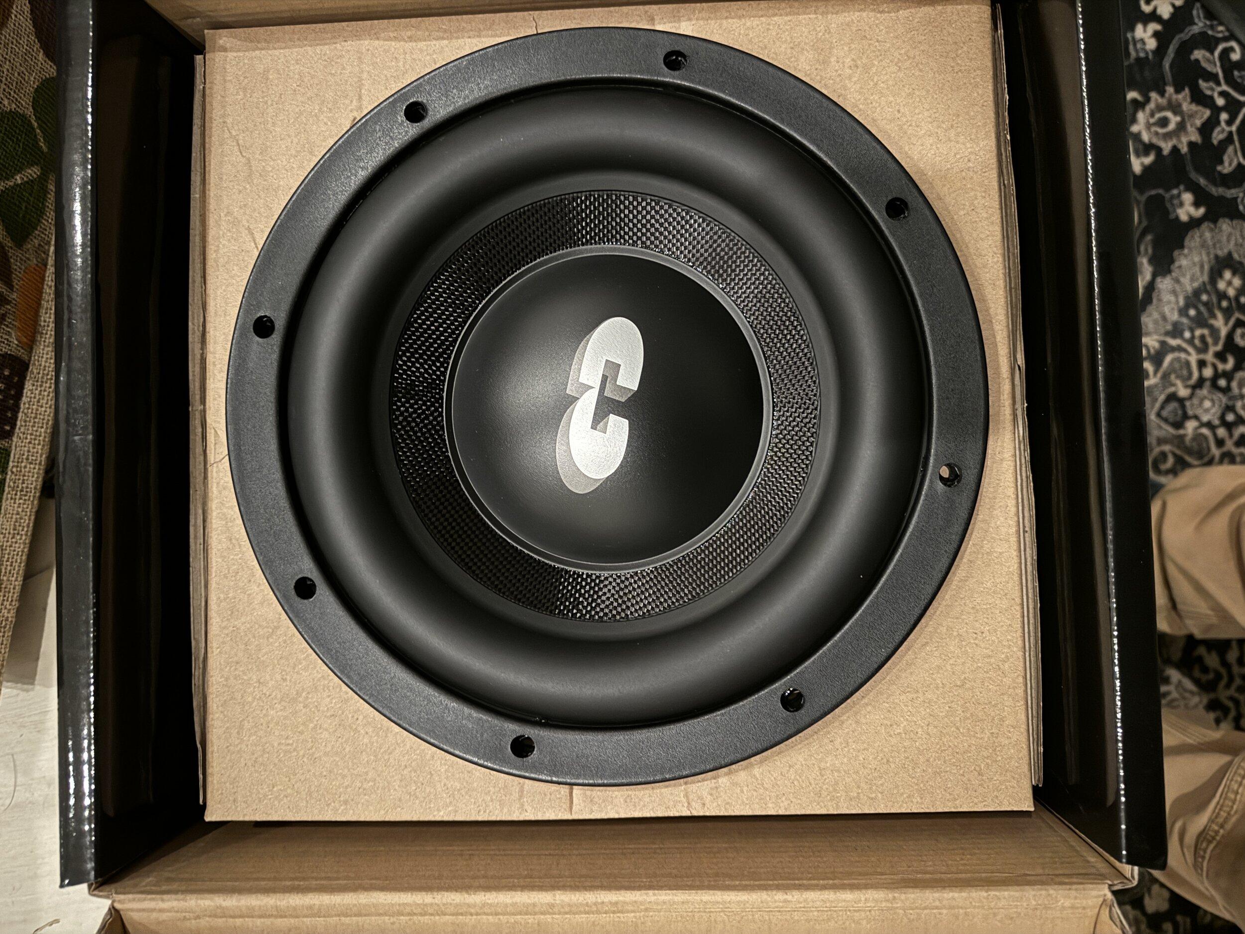

It’s settled. I purchased my speakers from CDT again, because my ram sounds great. Took it a step further and also decided to try one of their 10” subs as well.

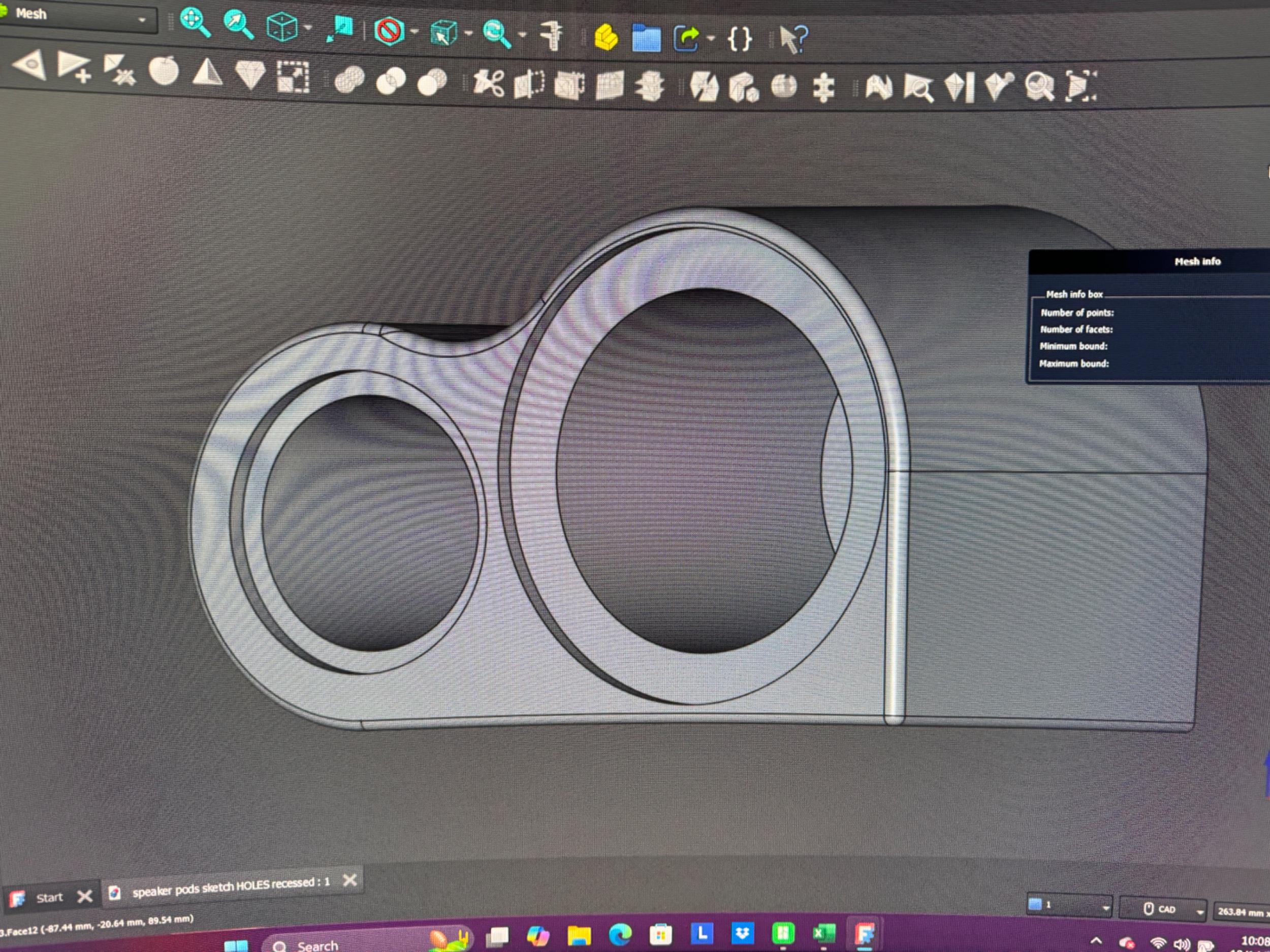

Front three ways will consist of ES-5s in the lower dash area and an ES-03 / ES-1200is in a 3d printed enclosure up on the dash / a pillar area. I will be designing and printing that myself, as we just picked up a Bambu Lab X1C printer. I will also be building an enclosure for the QEX-1000sq.
Head unit is a Kenwood Excelon KDC-X705. Amp is an Audison SR 6.600 that’ll be run 2x280w at 4 ohm and 1x600w at 2 ohm. Just using the CDT 3-way crossovers for now. May decide to go full active at a later date.

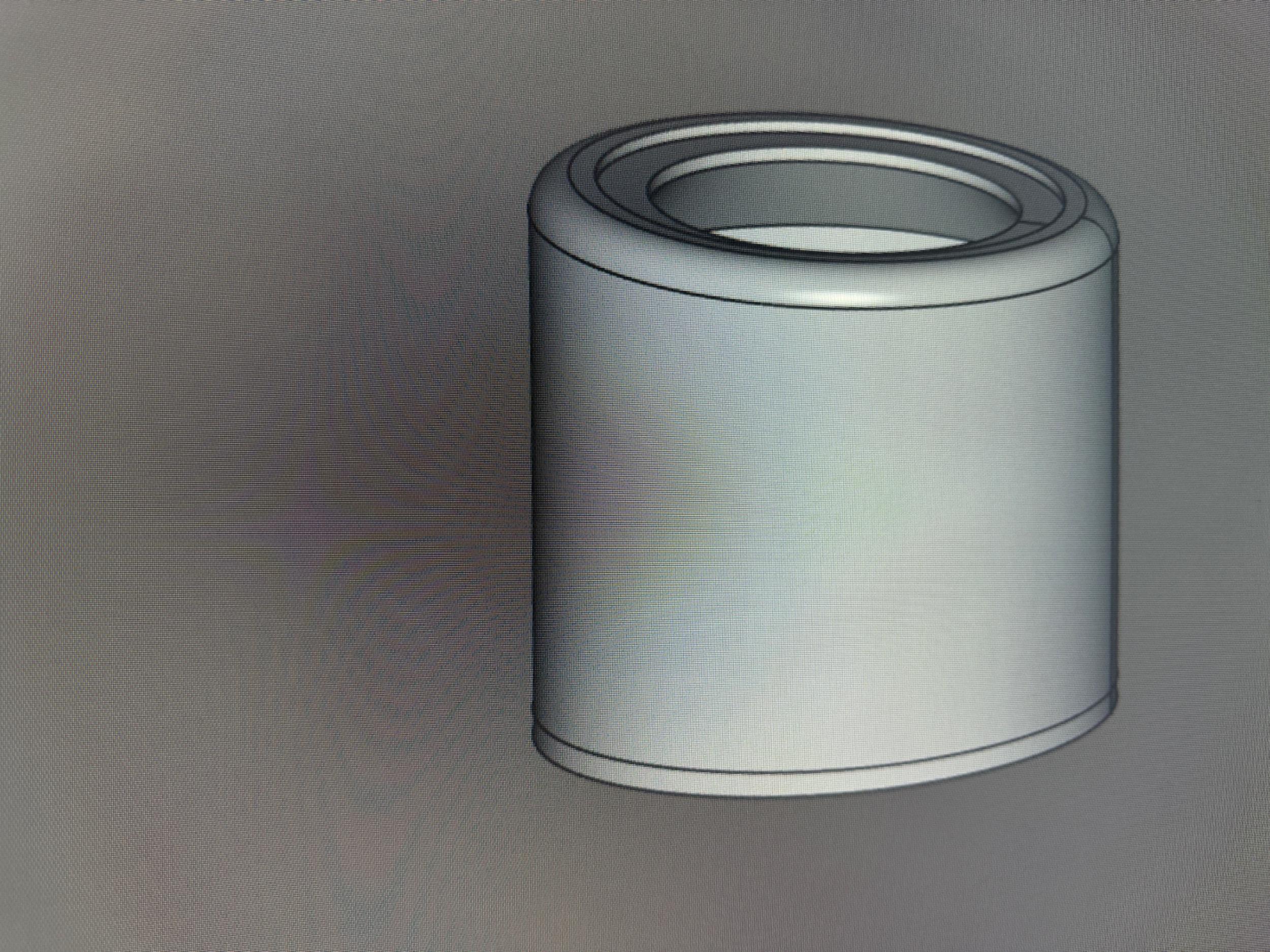

First day really messing around with free cad. I made a generic 90 degree corner enclosure for a 3” and 1” component speaker combo.

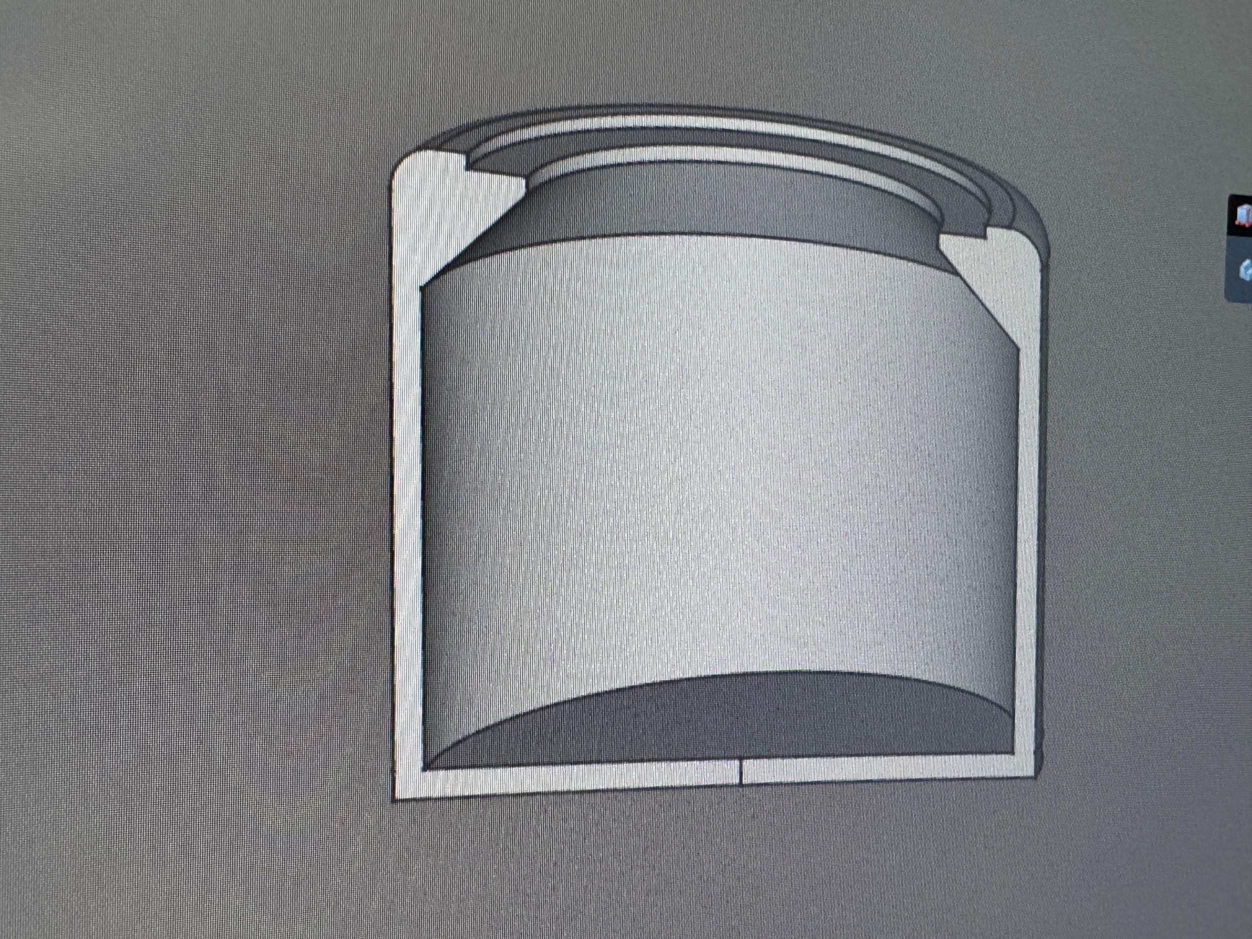

Ran it in the slicer just out of curiosity and found out I would require 250g of filament. Then I played around with a different wall profile to reduce thickness to 5mm.
Very interesting to mess with and I see a lot of potential for my uses. These are clunky designs that are not tailored to the specific angles where the A pillar meets the dash, but I will refine them as I dig deeper into the software.
