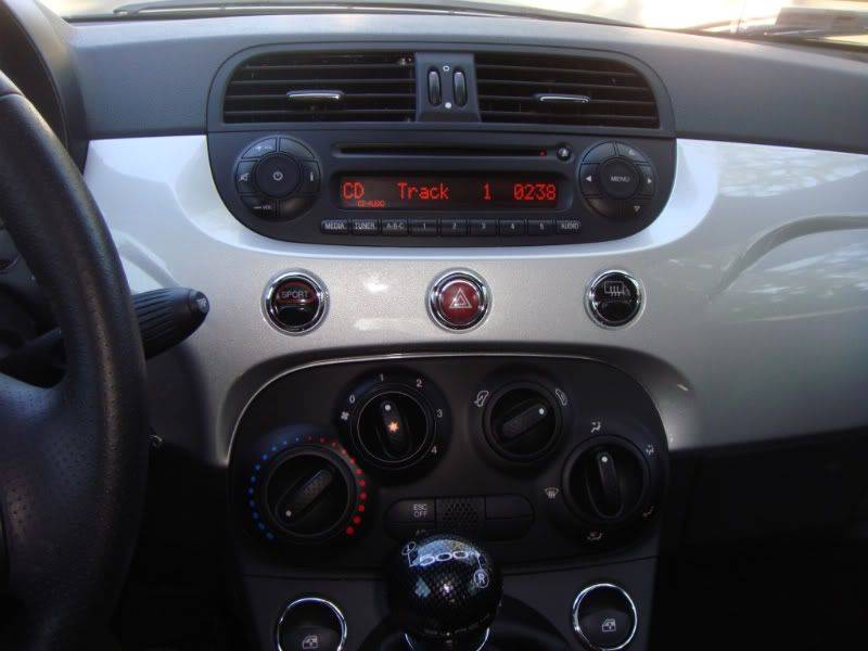

Here is my long time friend's new Fiat 500 she recently purchased. She was happy with the factory headunit with the Bluetooth but the rest of the system needed to go.

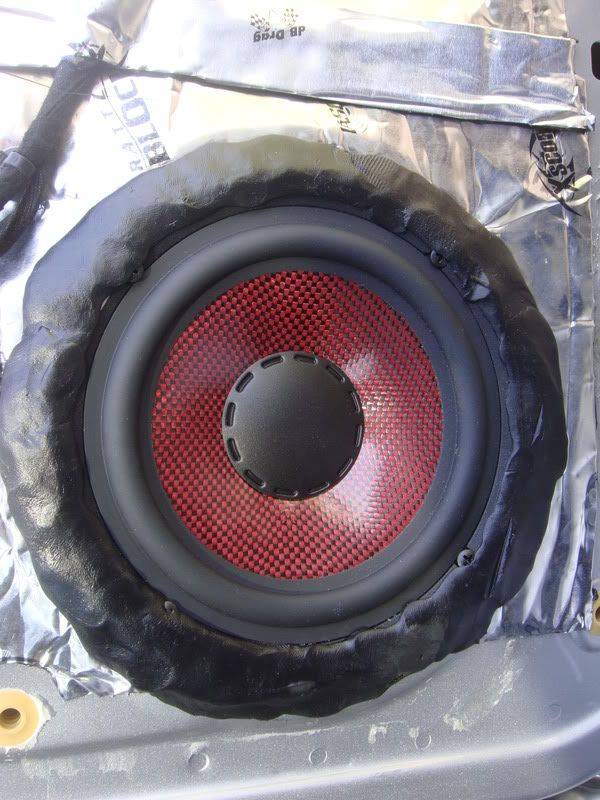

Zapco RH-16.2 6.5" Reference-active

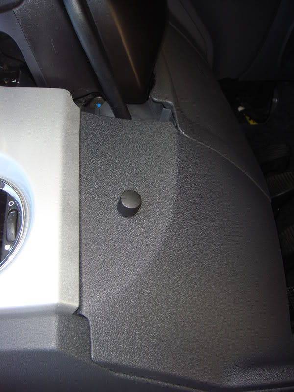

The bass control knob was mounted to the left of the steering wheel.

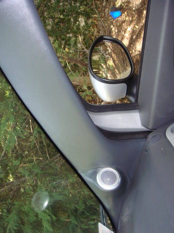

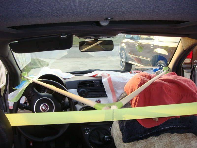

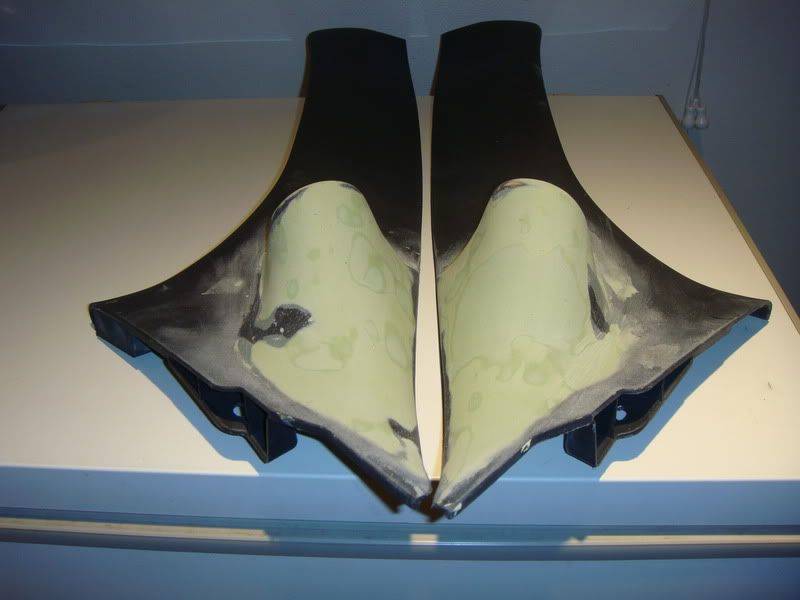

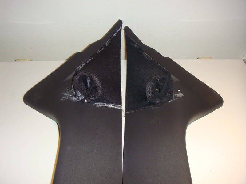

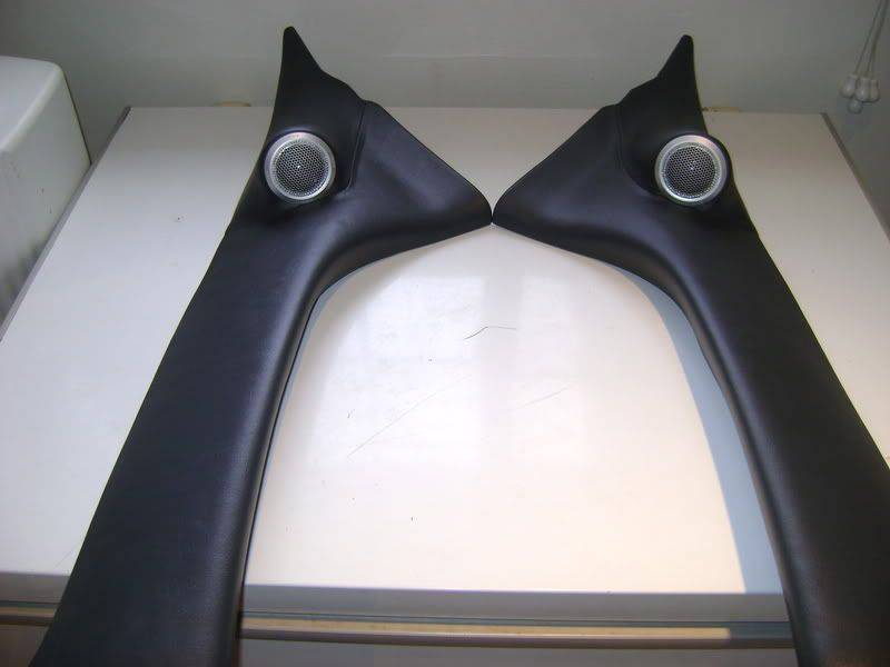

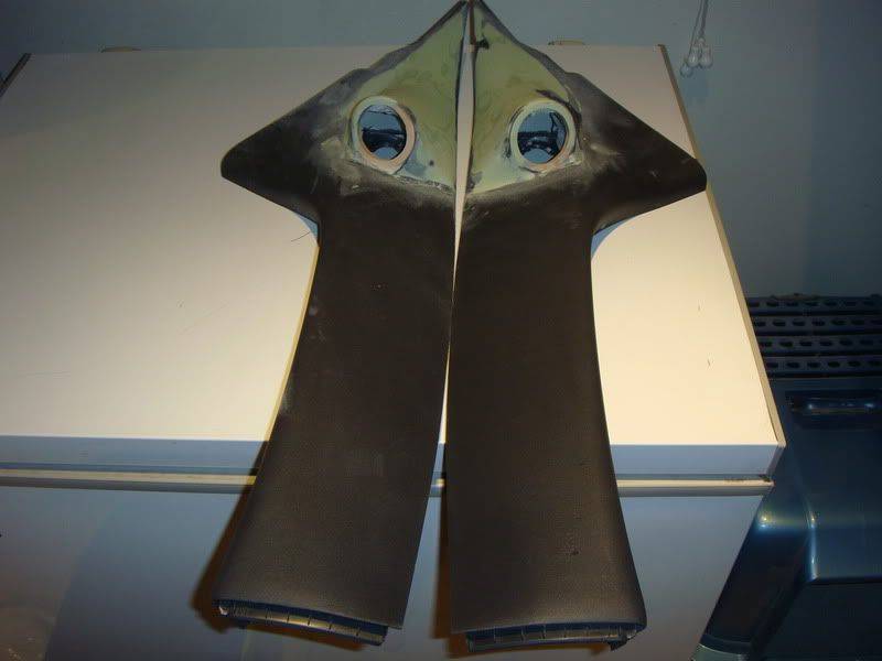

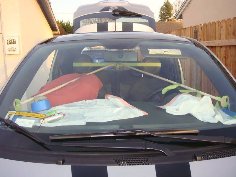

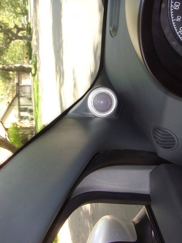

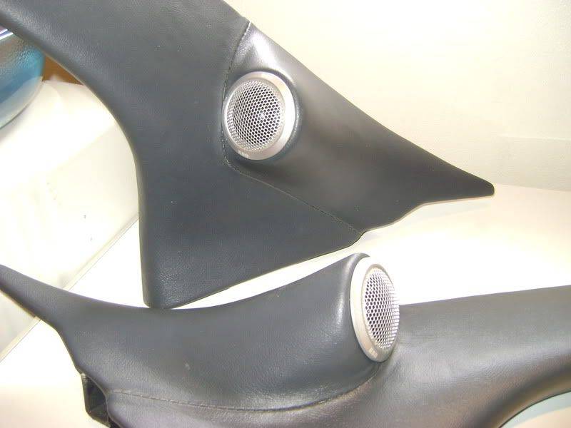

Aiming tweeters

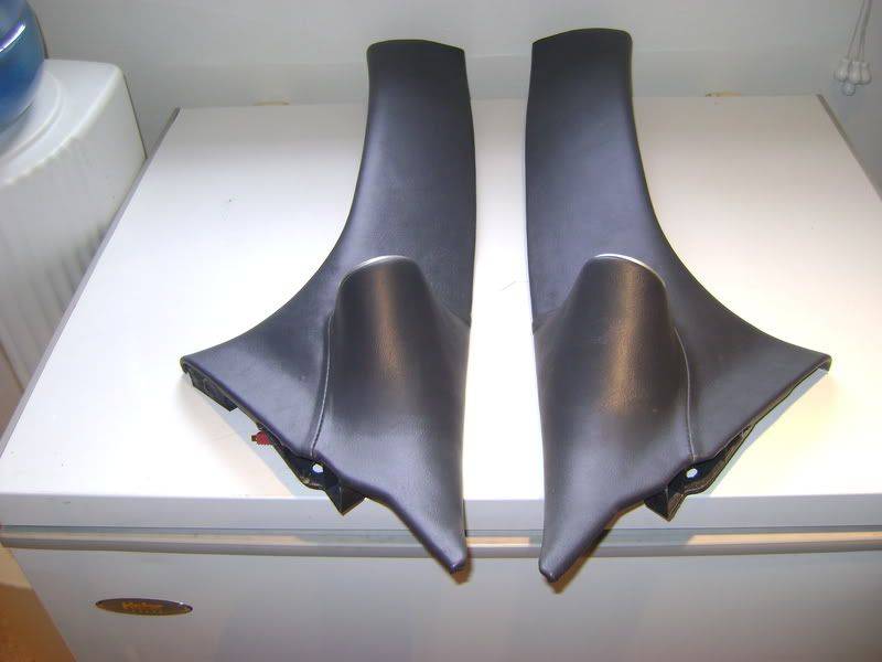

Grill cloth stretched, resined, smoothed out with Rage Gold
Sent out to get wrapped and stitched

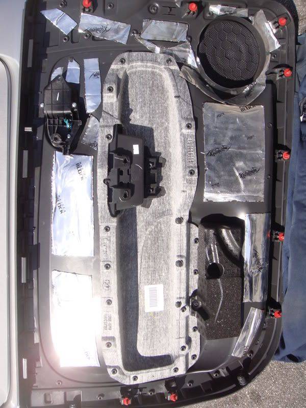

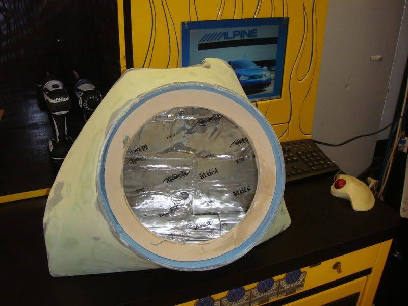

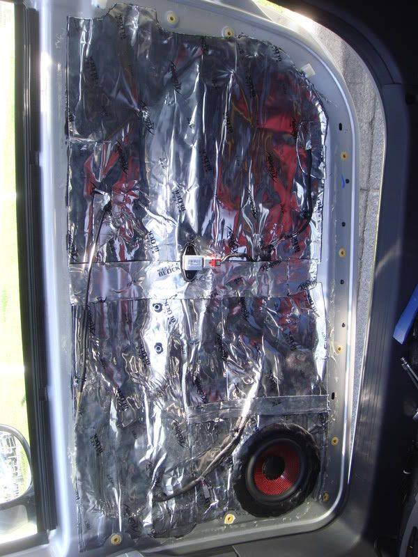

Some deadening was added.

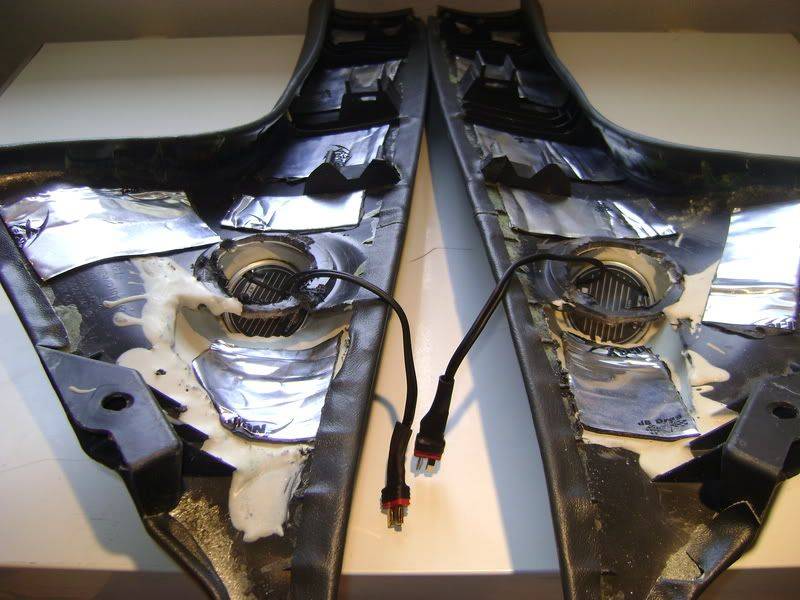

Milkshake mixture of resin, Marglass and Rage Gold poured into the tweeter pod.
Wired up.

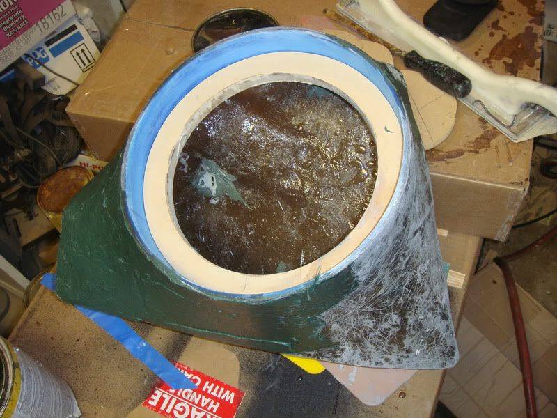

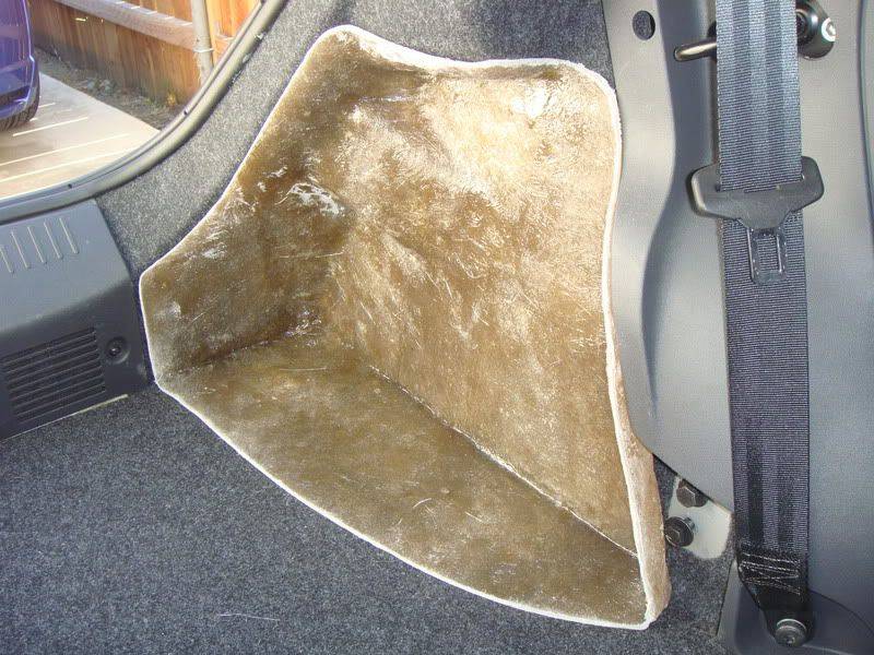

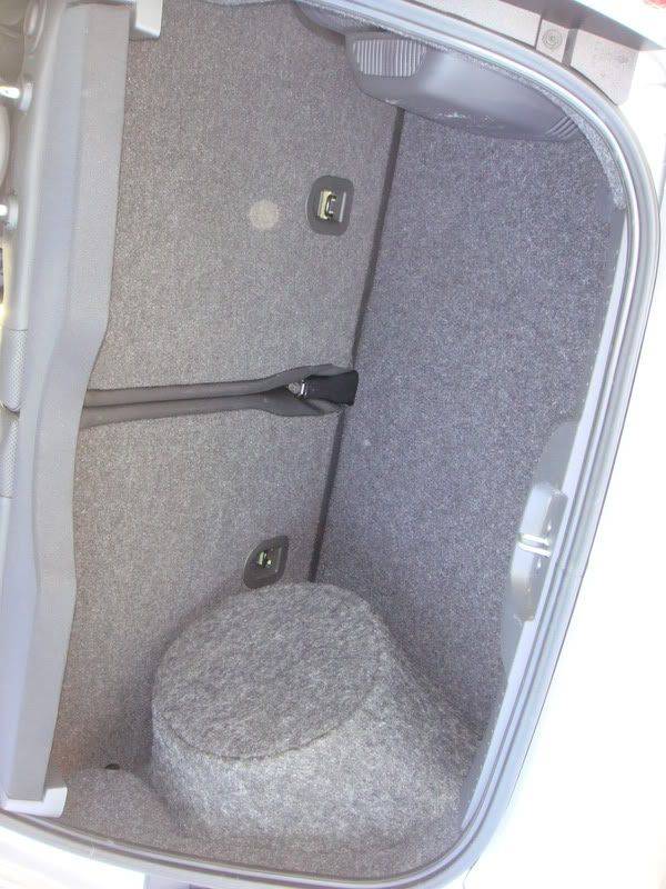

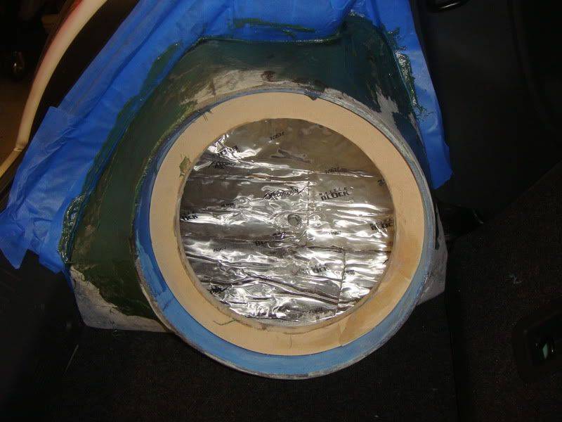

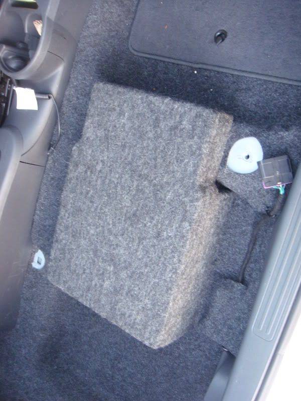

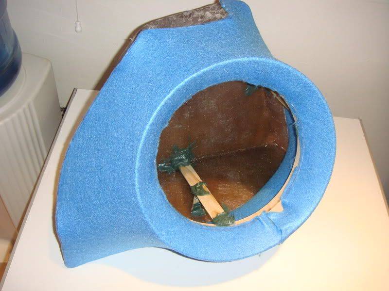

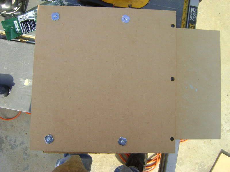

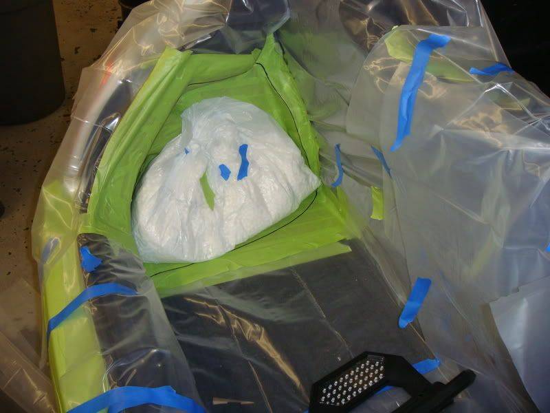

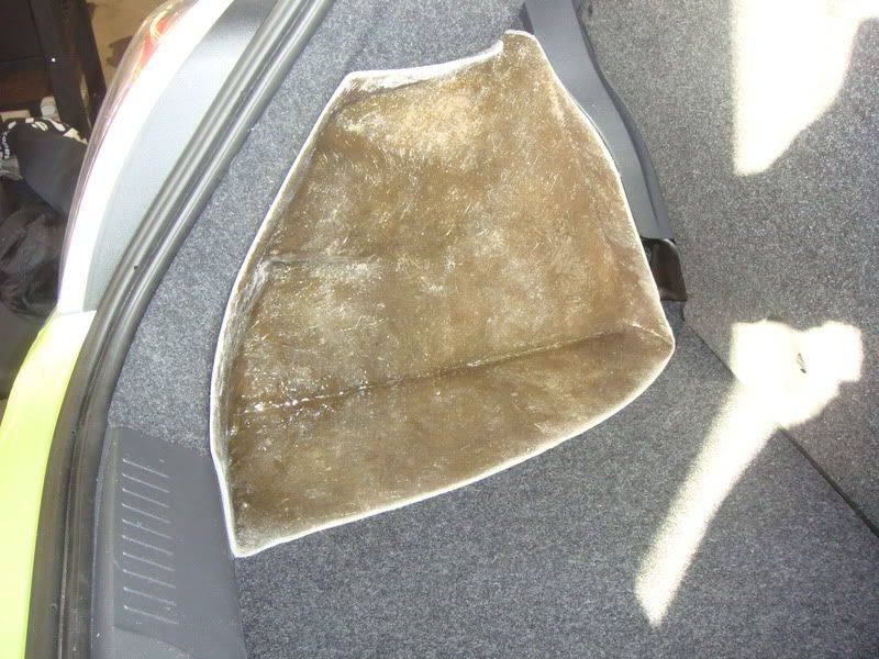

The sub enclosure area tapped off and measured for .65cuft

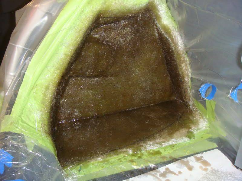

Layed up to 1/4" of mat
Cured and trimmed to desired shape.
Flush mount speaker ring attached and felt stretched
Resined, layed up with mat, and a coat of Marglass
Cleaning up the edges
Smoothed out with Rage Gold, mixture of Marglass and resin coated entire inside of enclosure along with a layer of deadening.

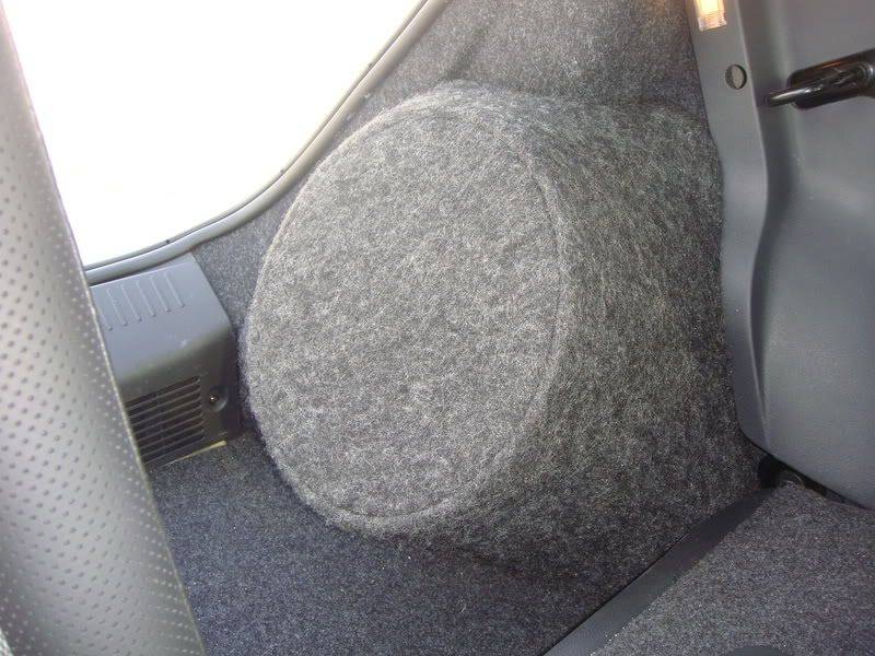

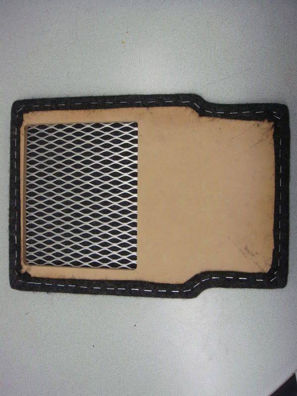

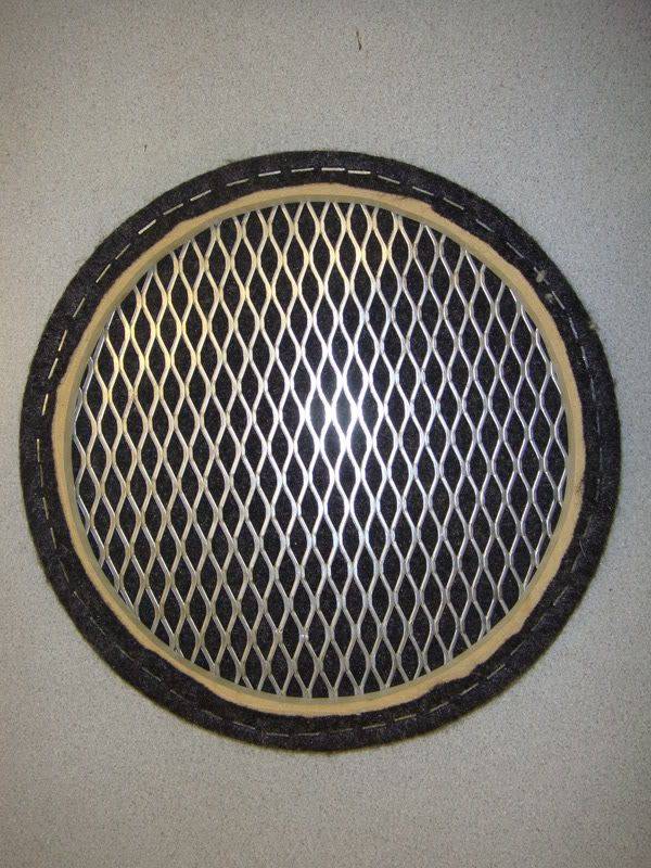

A grill was made with breathable carpet

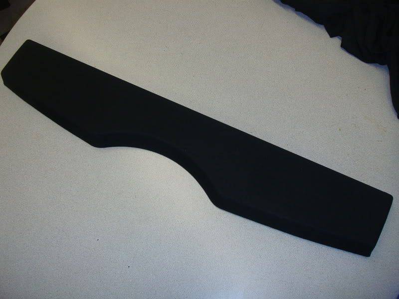

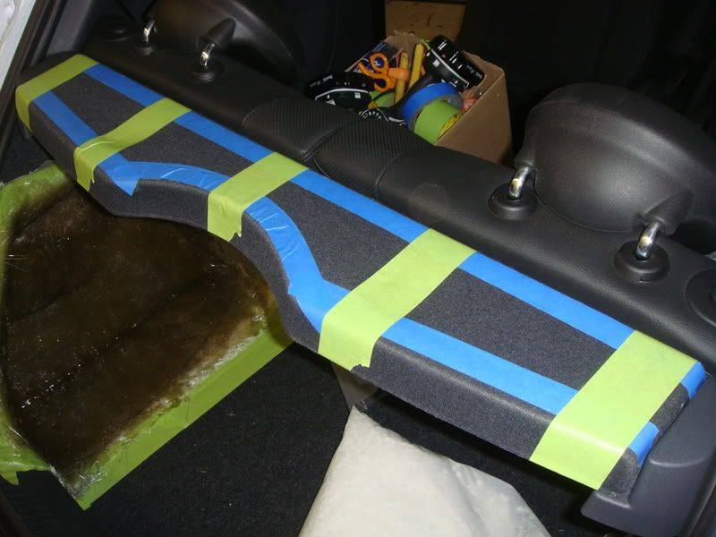

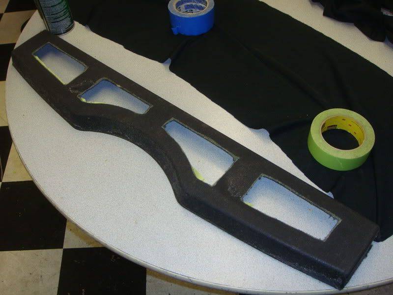

The rear parcel shlef was vented and wrapped with grill cloth

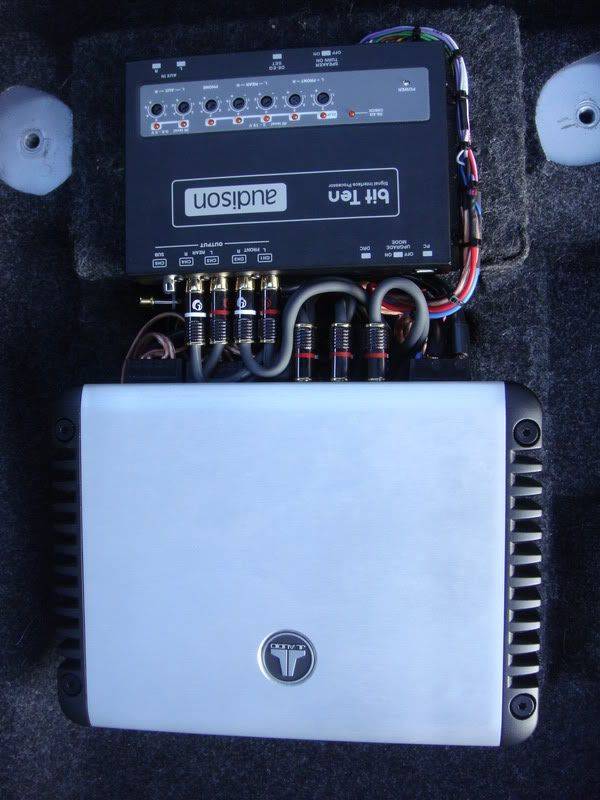

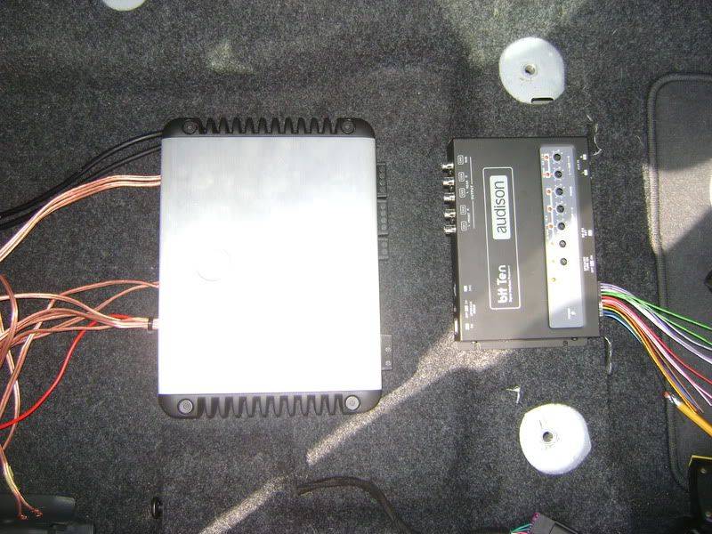

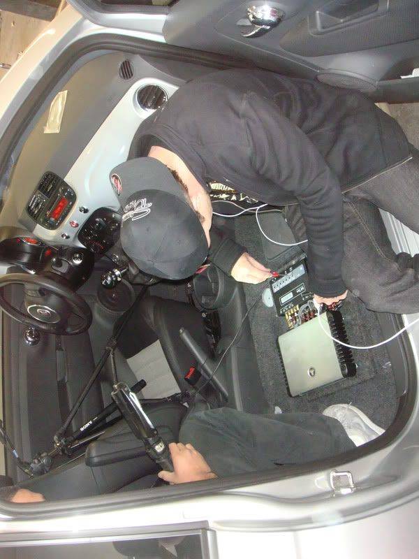

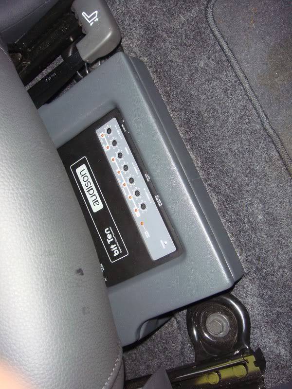

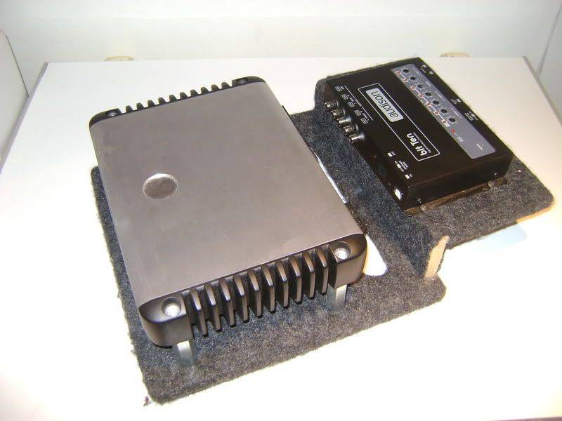

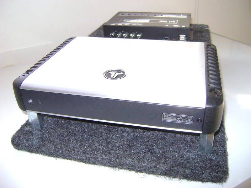

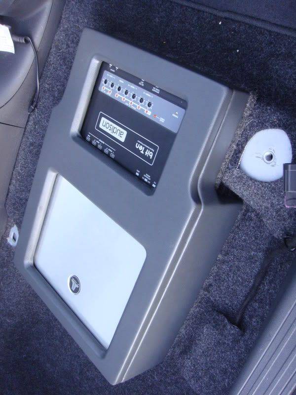

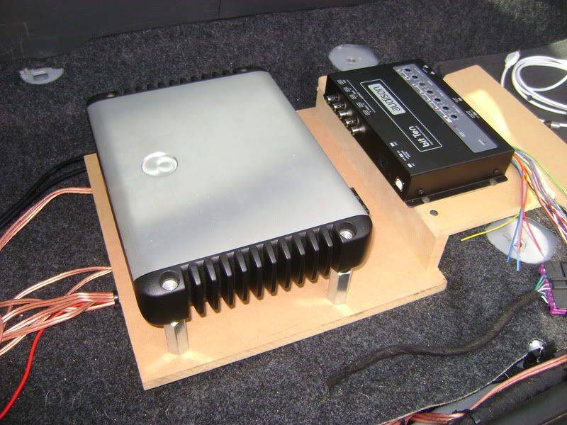

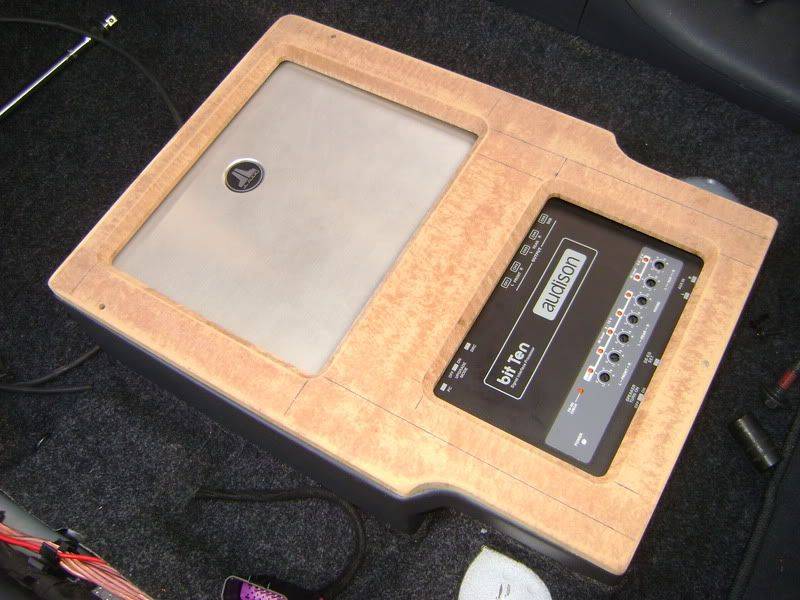

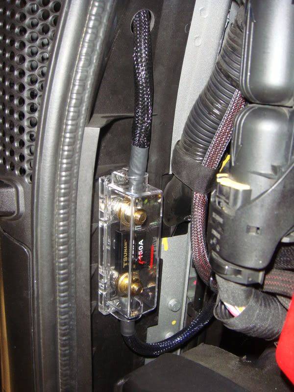

The JLHD 900/5 and the Bit Ten were mounted under the passenger seat

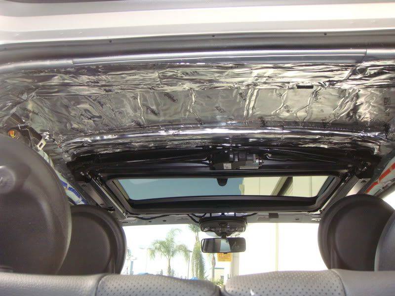

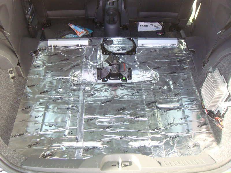

Quarter panels, roof, and trunk all received deadening.

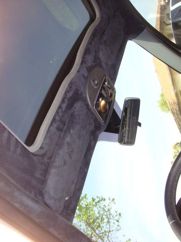

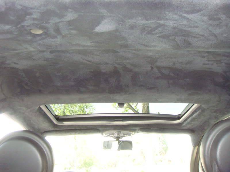

We also had the headliner and visors wrapped in black suede

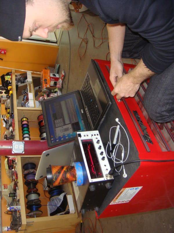

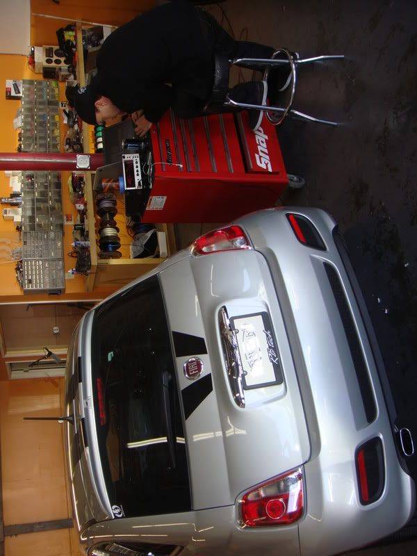

After I was done with the install I took it to The SoundMan in Santa Clarita were Doug and Rafa took care of an input issue and then tuned the Bit Ten.

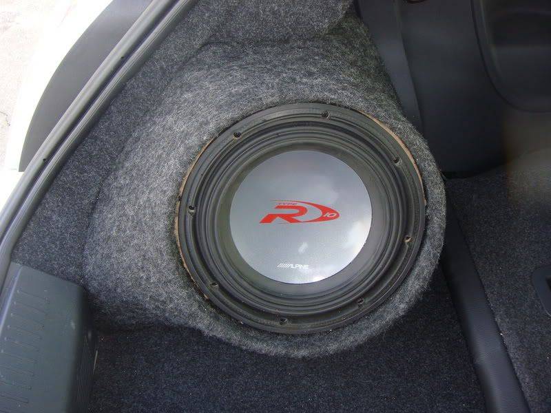

nice work man, im confused tho.... all that nice *** gear and then drop a type r in there? i mean dont get me wrong ive had em and are familiar with em. But i wouldve expected to see something with a little more sq
I was waitng for someone to ask that:)
I had an extra Type R from a job. I gave it to her for free. Trying to get her to purchase an IDQ.

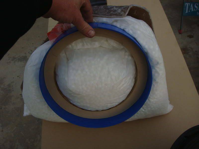

I built the enclosure with an oversized speaker ring to accomodate another manufature's 10". You can see that in the pic with the grill off.
