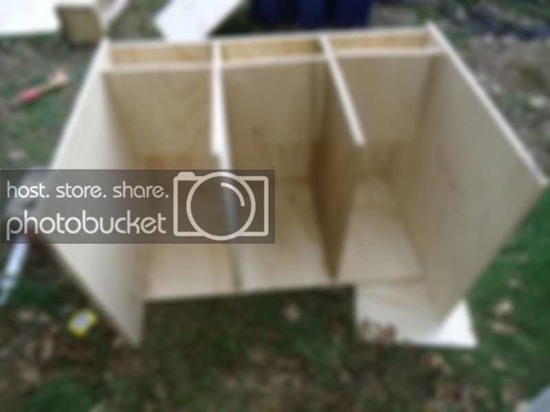

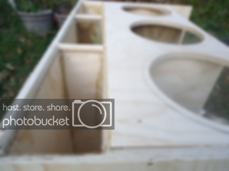

Really just quick and dirty you could get away with glue + staples to attatch the tube to the side to be flared and the inside of the port and just smooth with caulking, bondo, or your favorite filler. Best would be to rabbet it flush. Really I like the idea of stapleing the tube down after you glue (close staples like stiches in cloth).
Also for the record, my port piece is only 12" deep + the flare which makes 18". I believe the way this worked out with the roundover going down the bottom I have an effective port length of closer to 30 inches judging by the tuning (missed my mark by about 10 cycles too low. It sounds tremendous so I think I'll keep this configuration for a while. I will probably build up my neo motors to replace these when/if I can sell a couple out.

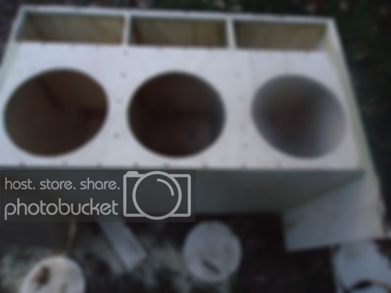

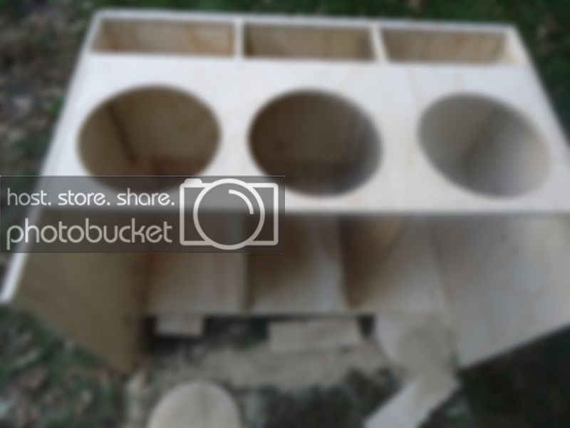

Anyway, since I needed to do something with this monstrosity of an amp so that I have a back seat I figured I'd go for an "optimal" alignment for these woofers to see what kind of score I can put up before the end of the year (2 shows left up here). After I do some numbers if I can't figure out a way to drop the tuning of this box I'll just ditch it and build another one.

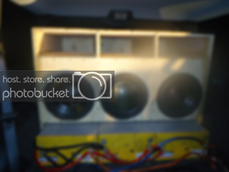

It was dark by the time I wired it up and mounted all the subs. Back seat folds up again and it is very very loud. A bit peaky compared to the last one, but this should get me a decent number.
Oh also check out the carbon fiber/kevlar full cover dustcap on the center sub. I shal be building more of those when I have some time. Will also take some better pics in the daylight. This design wastes very little space. Would like to have had the subs along the floor, but the bats and big *** amp need to go somewhere.

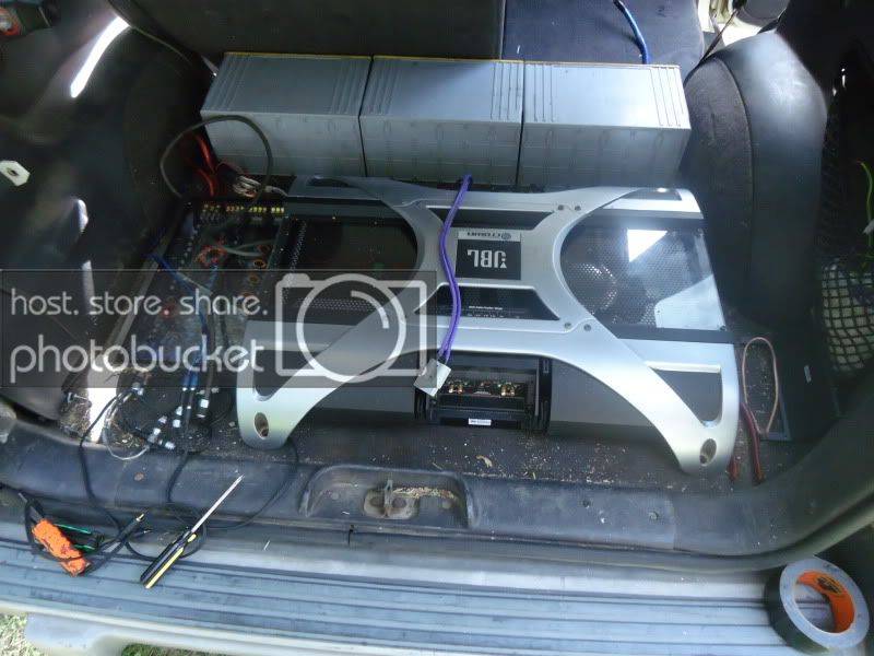

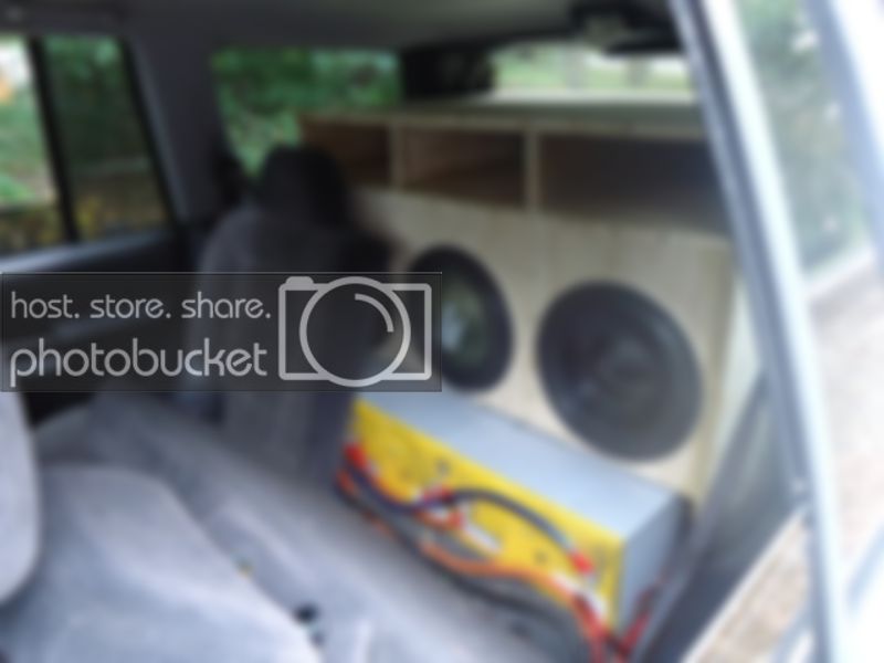

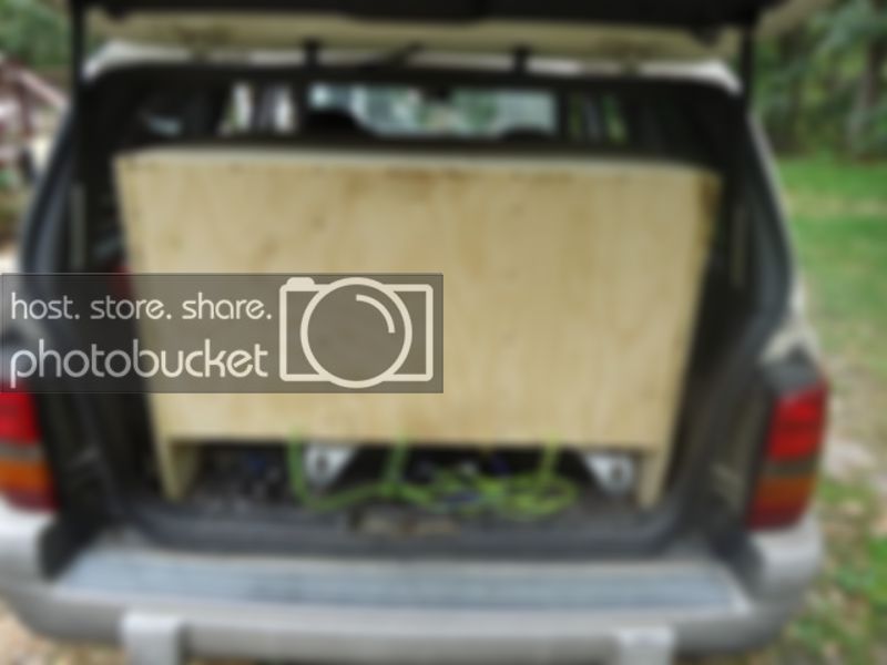

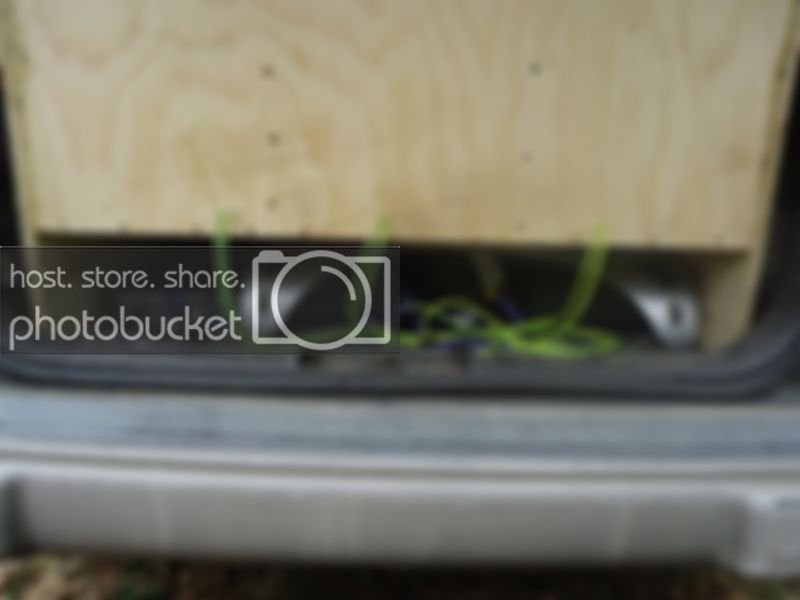

Some pics in daylight. As you can see the amps and batteries fit snugly under the "legs" of this box. I don't think I have room for anything else in here (really wanted to do another 2 or 3 batteries but it isn't in the cards here).

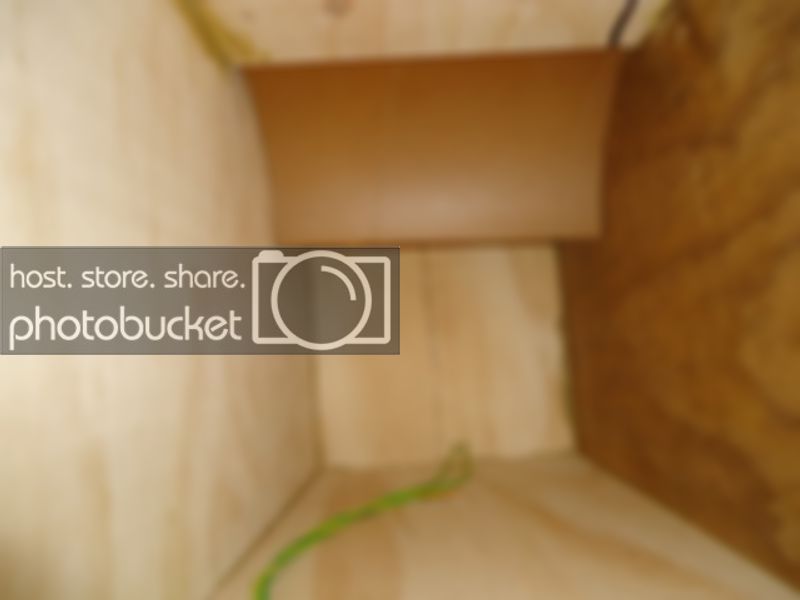

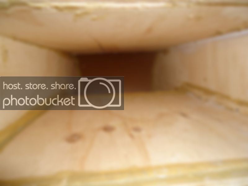

This setup put up only 149.1 with a peak at 48hz.....not terribly great sounding either. I rounded over the corner behind the port and extended the port with a bit of a flare (using sono tube). If anyone wants to use sonotube for roundover I'd suggest a thin bead of glue/liquid nails and stitch it in with a staple gun. Works very well.
