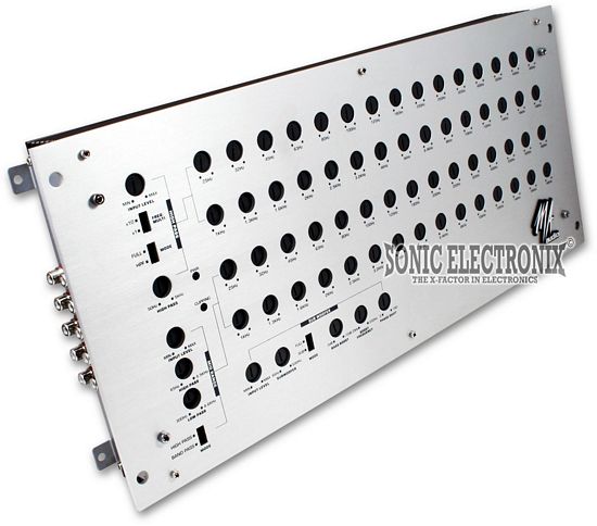

A while back Louisiana CRX said he had bought one of these off ebay-
MA Audio MA30EQX
30-Band Parametric Equalizer w/ 3-Way Crossover
Buy It Now price: US $135.00
http://cgi.ebay.com/MA-AUDIO-MA30EQX-30-BAND-PARAMETRIC-EQUALIZER-CROSSOVER_W0QQitemZ360063031554QQihZ023QQcategoryZ14931QQssPageNameZWDVWQQrdZ1QQcmdZViewItem
I dont know anything about it, but it seems to have everything except time alignment.
Oh, and that same seller also has it in a 15 band version if 30 is too much.
