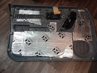

I'm liking this NVX deadener. Rolled on nice and is much thicker than the batch of Amazon deadener that I have a few scraps left over from my truck. I'm loading up the door card cause the speakers I'm using are too big to be factory mounted so I've picked up some Recoil speaker pods that I going to mount around the grille hole after I cut it out . Was a pain in the *** scraping off the 30 year old vapor shield glue. Couldn't find an exact blade so I ended up using a long flat rotary hammer chisel to scrape it off
I'll make a new thread with pics when I've got the door pods mounted
