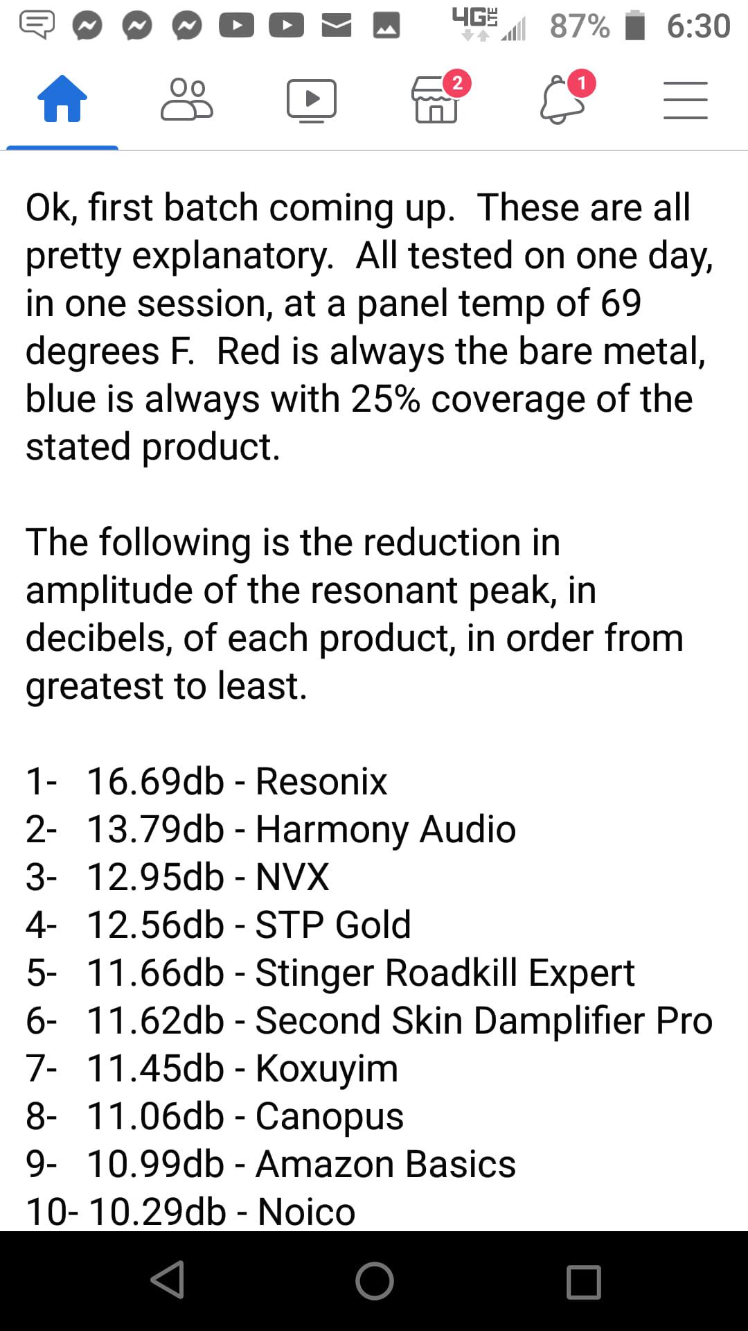

Those test have been revised and the Amazon has fallen a bit from grace. You also need to read into some of the specs. The Siless for instance, it's the 50ml or the 80ml, not the 120ml which I have used with success. Of all those that I have used, the NVX 90ml is pretty darn good.

A good alternative if you can't find the recoil stuff is NVX. Resonix is the big boy car deadening company (although it comes at a massive premium) and they did a test with all the most popular brands and which ones are best. I believe NVX was 3rd IIRC after Resonix and Second Skin.

Also I'm not too sure the tests he references are the most accurate. He uses some long forgotten Facebook page that I'm sure isn't even around anymore of this guy who builds little metal boxes and %25 percent coverage while only play specific frequencies. I wouldn't think that would be the most applicable test to compare to a car going highway speeds while listening to music which has dynamic frequencies and outputs.
BUT it's one of the few actual tests out there so it's what I use, although it's obsolete by now. The article on his website is years old

Yea that's what convinced me to pick it up. The only thing I use that list for is comparing which one has lowers the sound by the most Db's to their cost. Amazons was like a 12 DB reduction (I believe 3rd or 4th overall for the entire test) and was like $20 at the time for 10sq foot. That's a steal.
His section where he goes over the "cost to effectiveness" ratio or whatever he calls it is BS. Because this assumes that everyone who is using the list as a reference is loaded up with money to spend on deadener. And of course whos at the top of the list? Resonix. So then you go to look at their store... $60 for 5 square feet of CLD is the entry point and it doesn't even include their $25 "premium" roller even tho on the thumbnail for the listing it has it, but at the very end of the description it says "roller not Included" but Nick says rollers matter oh so much and you HAVE to get a good one. So $85 for a plastic handled roller and enough deadener to MAYBE do 2 doors if you drive a compact car with small panels.
Meanwhile I just picked up 20 square feet of NVX deadener today (also high on the list) for like $35. So I can get 40 square feet of pretty good deadener AND pick up one of the rollers on Amazon for $10 that I guarantee is just as good as Nicks. So I'm saving money, and now I'm able to do both front doors, my trunk, and have a few tiles left over for other parts like you mentioned.
Don't get me wrong I'm sure his product is great and works better than the cheaper stuff but the way he markets his business and conducts himself when talking to potential customers. Like if you mention the fact that you don't have all that money to spend on deadener hell say something like "well if you don't have the money to spend on the best then why are you buying it at all" or something arrogant like that and then he'll throw around his years of experience deadening expensive cars and he knows what he's talking about.
He probably realized people are going to use that list to stretch their budget, not spend every cent they have on his product like he was thinking would happen, so he has to further down sell the products he previously praised
