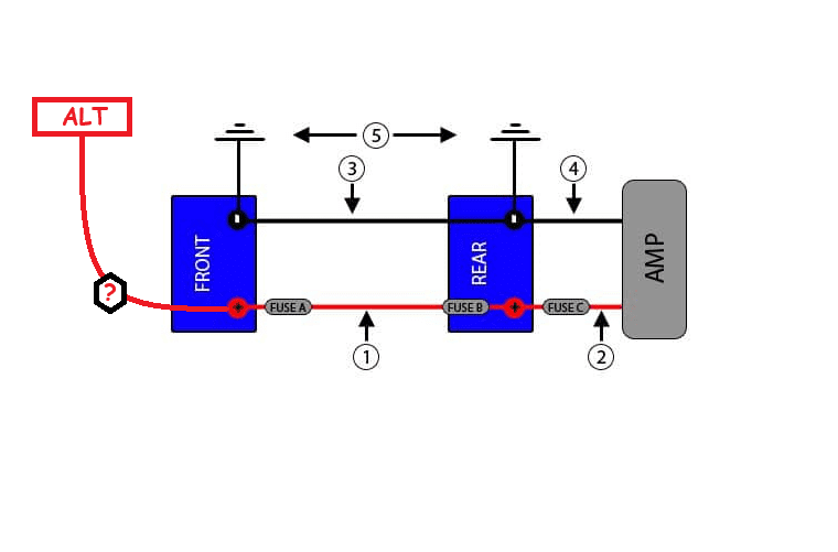

Looking for advice on wiring to keep the primary/starter and secondary/accessory battery charged. I'm running them in parallel (positive to positive/negative to negative), but found conflicting options on keep both charged or nothing at all about alternator connections. (Yes, I have the Big 3 wiring). Which option is best on keeping both charged while running them in parallel?
Option #1
Run batteries in parallel. Connect only the primary battery to the alternator. (I heard this will work but the secondary battery will lose charge faster.)
Option #2
Run batteries in parallel,. Connect a separate positive wire from the alternator to the primary battery. Connect a separate ground wire to the accessory battery.
Option #3
Don't run batteries in parallel. Connect each battery separately to the alternator.​
I've also seen where I need to add an inline fuse to the positive wire close to the battery. Someone said to add an inline fuse to both ends. Thought on this?

You definitely need a fuse on both ends of the power wire between the two batteries. Think about it. The power wire gets chafed and shorts out on something ( or, you have an accident) The fuse at the front battery blows. But the second battery is still shorted out. No rear fuse, I hope you like fighting fires.

I understand more wires would be involved, but what would make it more complicated? Wouldn't be just wiring like the main battery?
Are you saying an isolator isn't needed if wiring them independently?
I need a fuse at both ends only if I wire both batteries independently (Option #3)?
Running positive from main battery to second battery
Will give you same results as Running separate power wire from alternator to second battery
It's just a few extra feet of wire that you will pigtail off of, if going off main battery
Also running from main battery to rear battery will be easier to fuse
As far as ground wire
Ideally I would run a zero awg ground from alternator mount bolt to main battery
And zero awg from batt to chassis
And secondary battery find lowest possible resistance ground point anywhere in the car
If there is nothing good to ground to in the rear just run it up front to main battery ground
Should I add an inline fuse between the alternator and main battery?
If there is one, yes; if not, IT'S optional.
