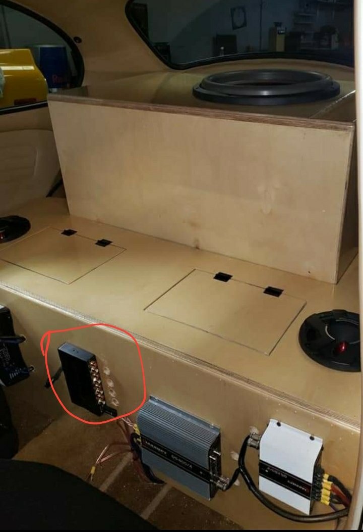

I'm running a active 3 way setup and it's my first time running active with a Dayton DSP-408 so far so good. I feel like you can get much better bang for your buck VS. passive car audio branded sets.
I bought 3 dsp-408's from PE when they had them "restocked" for 70.00 each and 2 of them had serious noise issues in a vehicle but worked 100% fine in a home setup. So I'm using one for some active speakers in my garage with a 7.1 Denon, 6 fully active channels 170x6 at 6 ohms or 200x6 @ 4 ohms.
