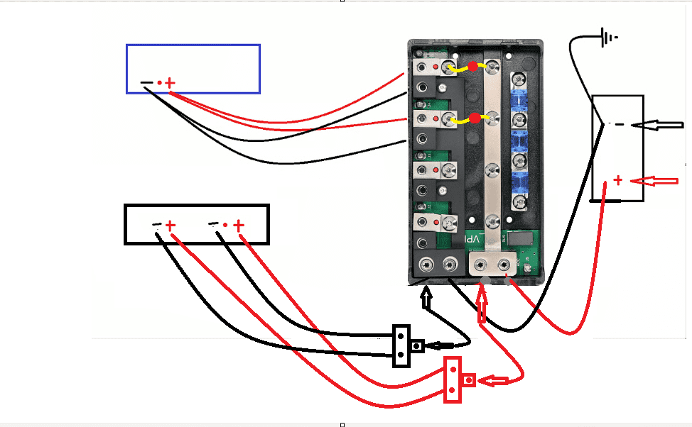

In this diagram, I have the Glow\Voltage as the 2nd battery (first not in the picture) and then use whatever distro you like. I like this one, but I'm also running three amps.
Here is doubling up the bass 5k Lower box in black), and single or double runs to the 4 channel Top in red), either of which power is provided by the GV lithium.
The voltage differences are negligible and no isolator is needed.
