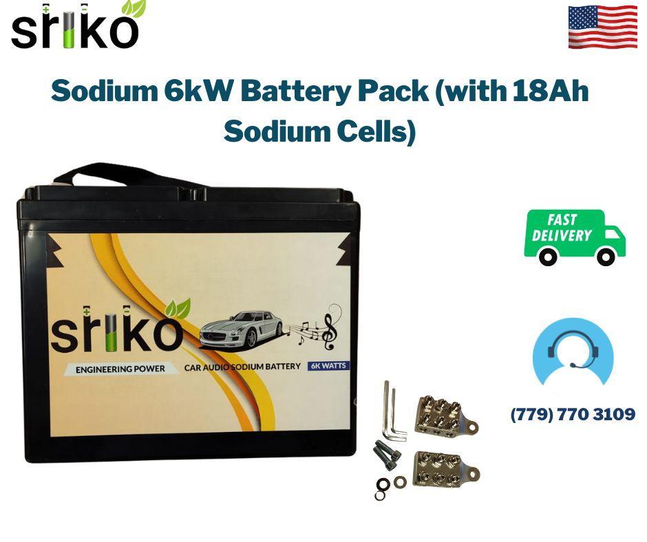

Absolutely need electrical upgrades. I ran a 320 amp alternator and 40ah of LTO lithium on that same amp.
Here is a 370 amp alternator and 54ah sodium lithium prebuilt battery.
I would add, OFC big-3 too, adequate cabling for all, then the GV, should be fine. Most are never going to come close to using max potential, but if you do, this will still cover it.

Lithium and sodium batteries cheap enough now that running agm in a system that size doesn’t make sense.

I have not run one of those amps.
If it pulls 230 at full boogie, why did you need 370 to stay alive?
Or did you go big since you had to replace it to eclipse the 230A anyway?
